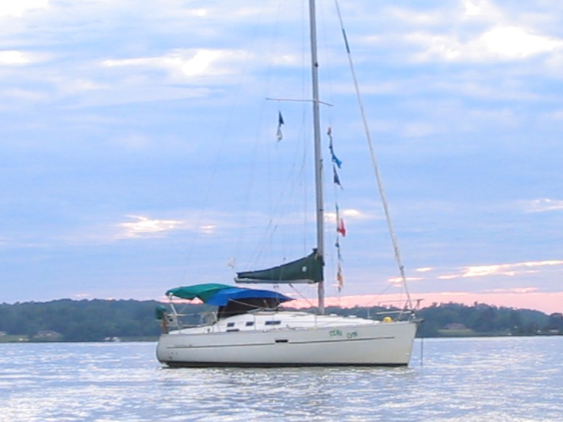

I did not like the OEM (locally made for AYS) design for my B323. I made my own Bimini/dodger/"awning" instead of the $5200 OEM price. The bimini has zippers on the flaps that hang off the fore and aft bows. The rear zipper holds a panel that comes down to the lifeline. The front zipper connects an awning that is the width of the boat, and goes as far forward as the traveler allows. That is about 8 inches in front of the front dodger bow. Across the front of the awning is a pocket for an awning pole that holds the blue canvas forward, and as wide as the boat.
1/4 inch lines from the end of the pole can go to a number of places, depending on how you want to use it. When not moving, I go outside the shrounds, then in to cleats on the front of the boom. If i need the awning as an air scoop, i can raise the front as high as the boom allows- about a foot- for a scoop effect. If it is blowing or raining, i tie the pole down to the lifeline to keep the elements pretty much out of the cockpit. I can almost always keep the awning rigged when sailing. Last fall at the MRYC we had 15 in my cockpit for happy hour because I had more canvas shelter then the bigger boats. I hope the pics will post ...

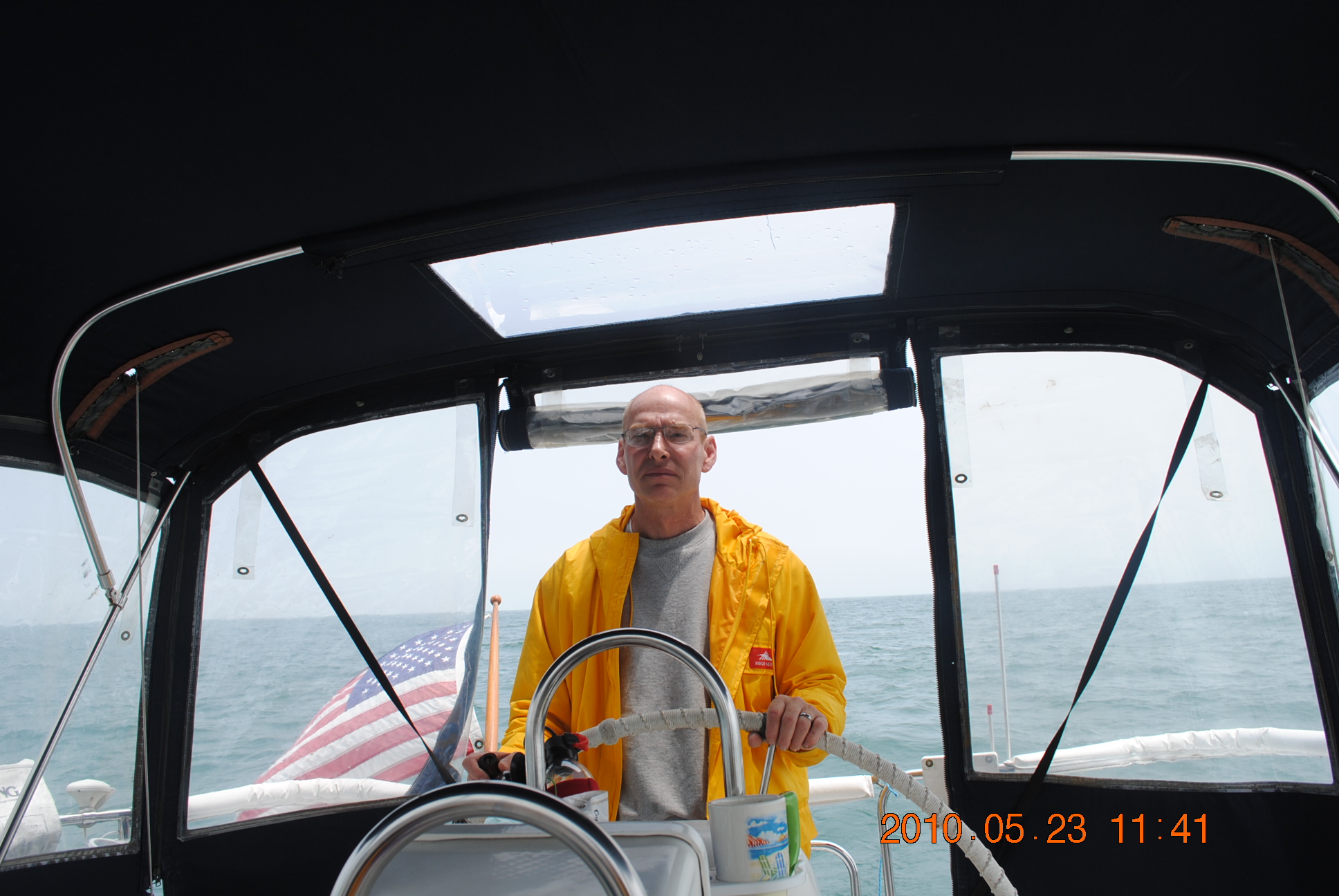

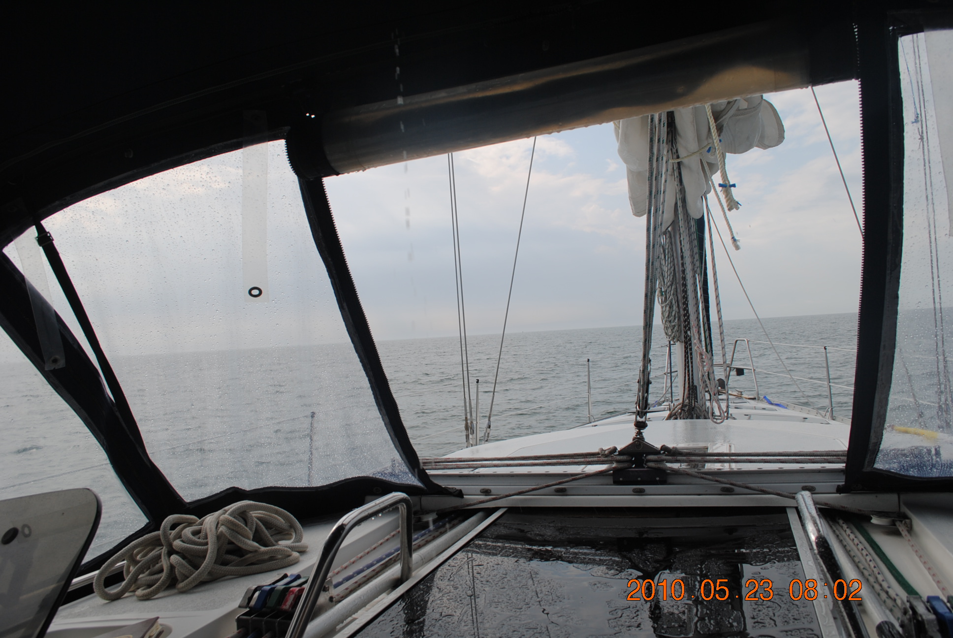

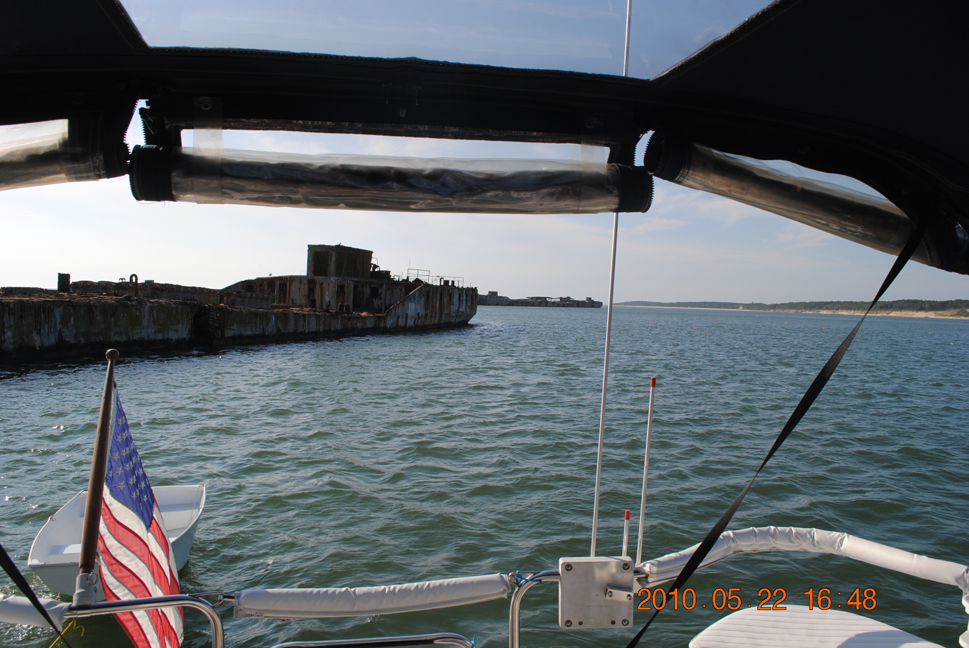

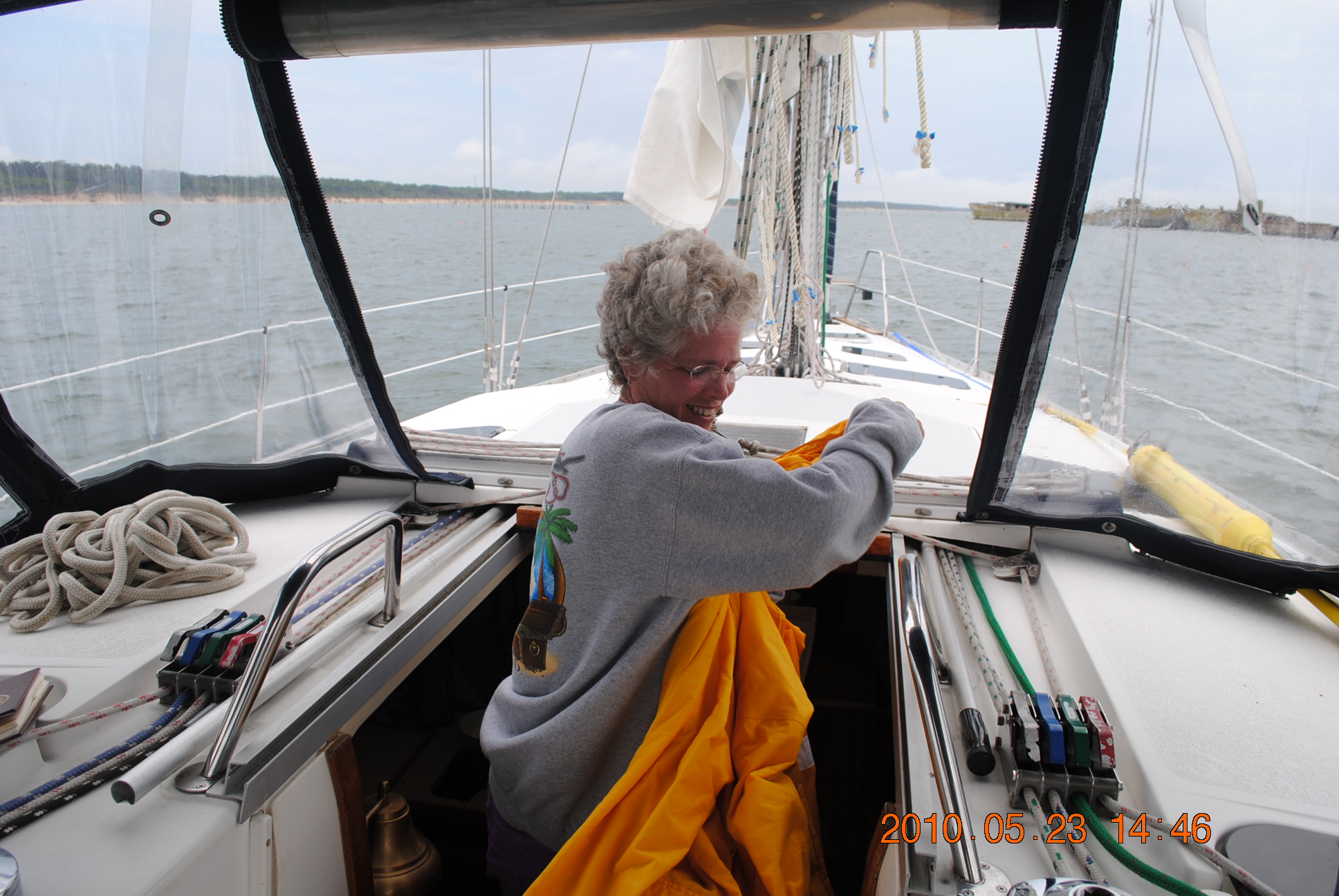

Id recommend a full length bimini. It replaces the dodger with curtans that zip in to the bimini. it can also be fitted with curtans all around for a full enclosure. Each curtian is individually removable so you can customise the amount of exposure you want/need. You can see mine in my avatar and in the attached photo first is looking aft with the 3 stern curtans rolled up, second is looking forward with two curtans down and the center one rolled up, 3rd is looking aft with two down and center curtan up, and the 4th is my first mate doing needy things for us in the companyon way compleatly under the bimini. also note the windows in the bimini proper that allow you to see the sail. There are also three curtans on each side.

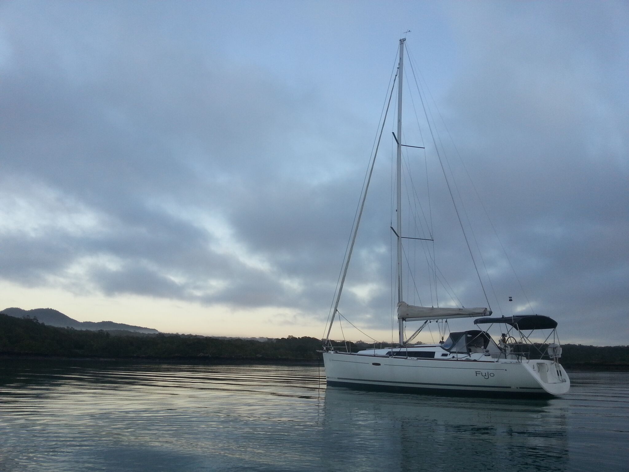

I have my dodger and bimini up all the time, because the solar panel is on it and we need ultra sun protection. When we aren't sailing or motoring we have an infill piece that fits between the dodger and bimini and zips in position. A longer bimini like the standard Beneteau euro version would be nice, but then you can't see how the main is setting when it is up. Pics attached at Rangitoto Island NZ. mid winter.

While I don't have a dodger proper the three curtans in front and two forward ones on each side do form a didger of sorts. We use them in that fashion. Really nice to be able to take down parts to control the amount of "chilly morning breeze" that comes through.
we use the standard sail rite recommended plastic window material, it is about 15 years old in this picture so you do get what you pay for.
We do keep the bimini up most of the time. Have a place on deck (bigger boats can get away with this easier) to stargaze with the Admiral also the cockpit seats don't lend them selves to sleeping on in the 40.5 due to a helm clearance
Our configuration has two double bails, and straps on 4 corners to hold everything in place. The only thing I don't like (but don't experience much) is the forward bail does not quite clear the companionway when you take the bimini down.

My picture and writeup in post #2, I forgot to say the awning rolls up around the awning pole and rests on top of the bimini when not inuse. The awning, when unrolled, can also be brought back aft under the bimin to block out the morning sun.
