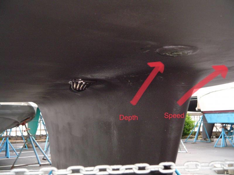

so we re-commissioned our 2008 Hunter 36 this weekend. To my annoyance, one of the things I managed to not remember over the winter before splashing the boat was to measure the distance from bottom of keel to depth transducer, in order to set the thing properly. Anyone know the answer?
I set my depth alarm by adding 2 feet from a direct sounding.

Another method is to stop your boat over a shallow area.
Then drop a "weight on a rope" [adjacent to transducer] to find actual depth to water line.
Adjust to actual depth.

Can’t remember keel offset but I use line overboard to check depth of water and set depth how deep water is when sailing.

My 2000 340, with a shallow draft keel (4’6”) is set to 1 foot below the keel bottom. So depending on where your depth sounder is located (should be like mine, about 6 inches in front of the keel) and you know your keel height. Set it for 1 foot more than that and you will be safe.
