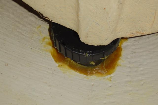

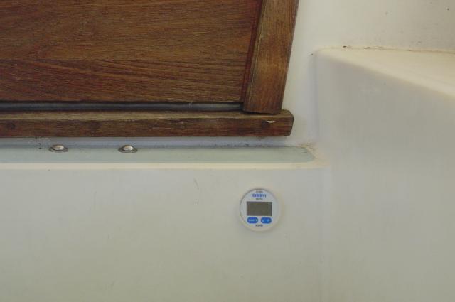

Why not mount it inside the boat? I mounted the transducer using the wax off a toilet bowl wax ring three years ago and it's still working just fine. I chose only a depth gauge.

The transducer puck is located in the compartment fwd of the keel (near my water tank for my sink) and the lines were led aft underneath the cabin floor along the centerline.
The only time that the fish finder is inaccurate is when there are lots of underwater weeds.
