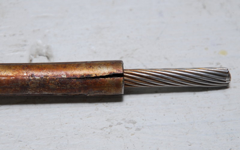

If you live in the North
If you live in the North, here's a good reason...
Lower swage cracked due to freeze thaw cycles..
