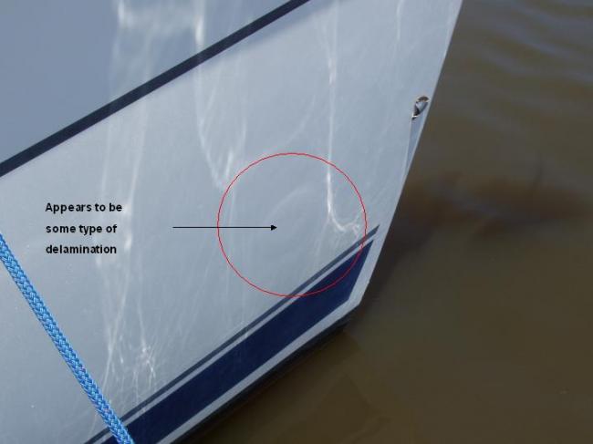

Hi John, if it were my boat I would have a marine...
surveyor investigate the void and write a report for my insurance company. It looks like a legitimate claim to me. Often times even the surveyor is unable to tell the extent of repairs needed, but a good quality FRP repair shop can make it like new. Terry

I am considering hiring a surveyor but I was looking for some comments from the Hunter Owners first The owner of my marina, which is a very qualified repair facility as well, informed me he thought it was a factory repair that may be going bad As you can see from the the picture I posted this boat has been well taken care of and the bow has never seen any loads other than cutting thru thru the water

If this is a fairly new boat, it might be a simple delamination void flaw caused during layup and only now becoming obvious. If so, this isn't uncommon and easily repaired. By all means find a surveyor but make sure whoever you choose is knowledgeable in glass work and not just a run of the mill surveyor.

You did not say how old your boat is. I would start with the dealer who sold it and if no joy there go directly to Hunter. Voids normally show as a hole, your boat looks as if its a repair that is showing up now as the pigment difference is enhancing it. I had a simelar thing on the side of a 376 which was about 18 months old when it became apparent. Dealer fixed it for me. I hate to start paying when surveyers etc. when Hunter will look after their problems. If all else fails then you can get hard nosed about it.
