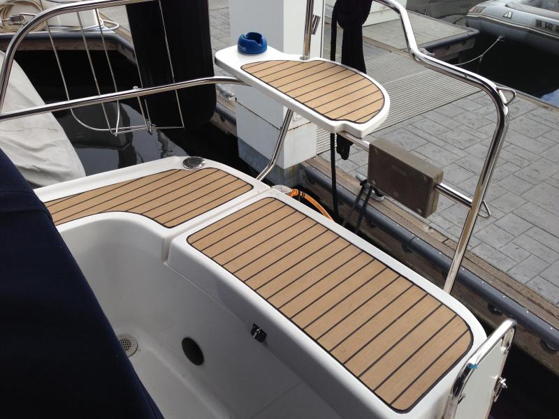

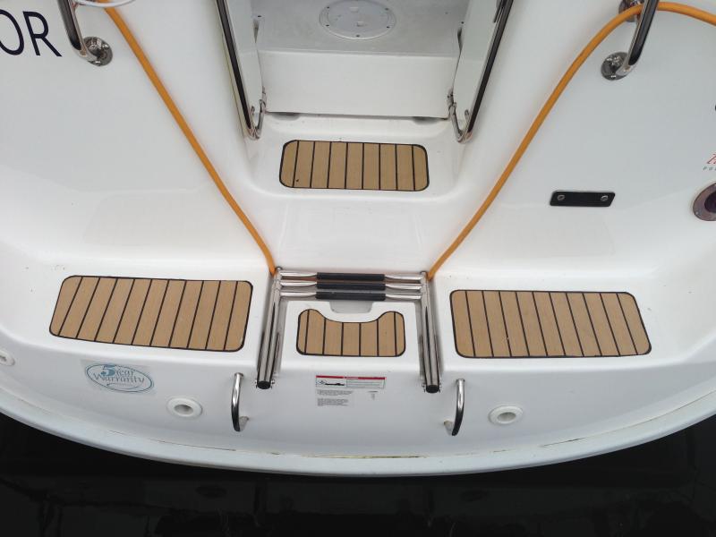

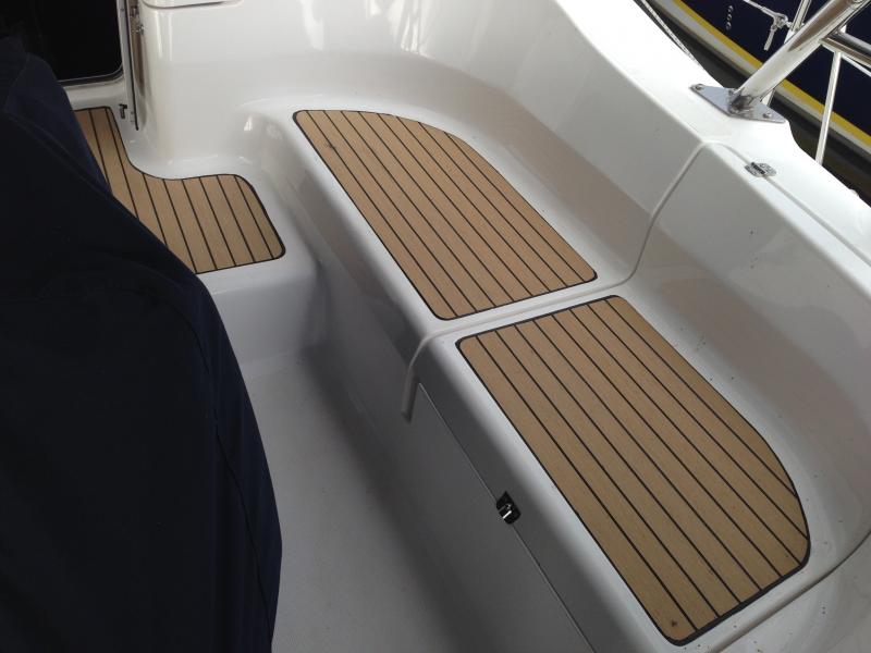

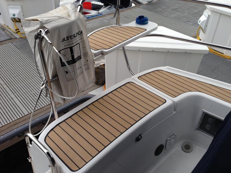

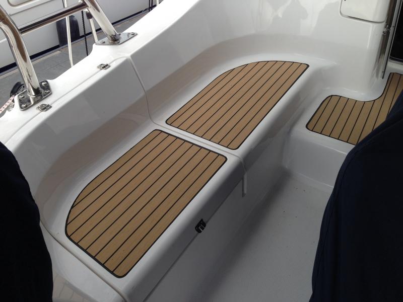

A little more information I learned today from Flexiteek... Hunter switched from Flexiteek sometime in 2008 to a product called "PlasDeck" which used a double-sided adhesive of some sort. I think I'm going to lift one of my pieces to see if I have the same product, but my boat was manufactured in mid- to late-2007.
H45DS
Aug 12, 2010
55
Hunter 45DS Portland, OR
Got it done!
Just to follow-up, I replaced the PlasDeck material that Hunter originally used on our boat with Flexiteek. I am VERY happy with the new product.
<edit> I should have mentioned that I used the Bostik 940A adhesive recommended by Charlie Lucey of Yacht Deck where I got the Flexiteek (http://www.yachtdeck.com, closer to me than FL!), and the caulking was performed with Dow Corning 795 Silicone Glass Glazing Sealant, which is the same material used to bed the outside glass panels on skyscrapers. I won't have to worry about this issue again!
