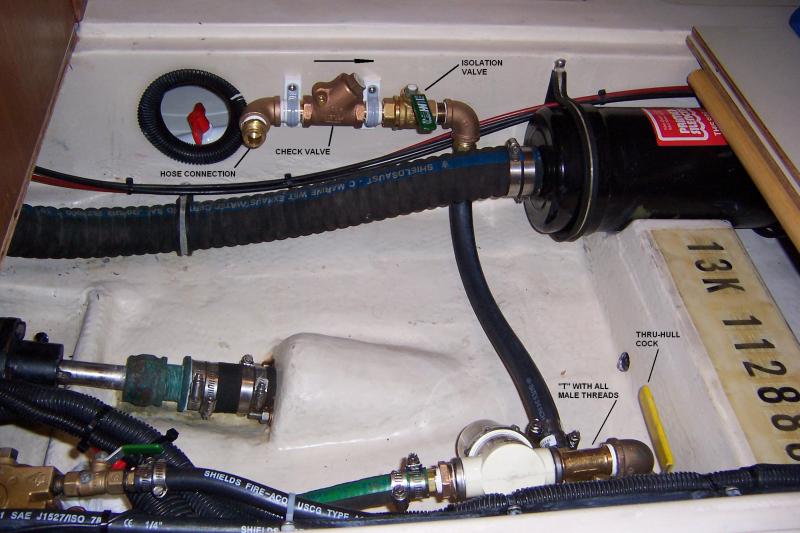

I think you're obsessing a little over bilge pump capacity but if you want it ..................... consider using your engine sea water pump as an auxiliary bilge pump (see below). Don't know what size your engine is but it's sea water pump is considerably larger than my 2GM20F @ 7 USGPM.
That should keep your socks dry for those days when the bilge pump just isn't quite enough :D.
