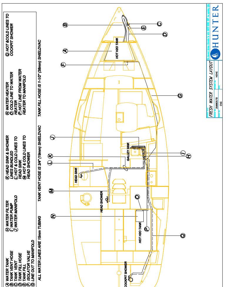

Thank you tfox2069! I do plenty of plumbing and electrical so this is a simple one. I installed the winch on this vessel. But unfortunately I don’t have AC. And I don’t want another thru-hull. So I was thinking the head pickup. But it is at the other extremes near the stern. So that makes running a pex line behind all the panels a bit involved. What do you think?
Almost all the thru hulls on my boat (and I assume yours since they're so similar) are situated at the foot of the cockpit ladder in the cabin. That's awesome most of the time, since you have to pull up exactly one deck panel to actuate/inspect all your seacocks. The one exception on my boat is the macerator seacock in the stern's port locker, but I removed my macerator completely and capped off the thru hull since I can't pump out anywhere in the Chesapeake.
But in your case that means you'll need to run hose from bow to midships. I do NOT recommend running it behind any panels, because if it ever leaks you want it to have a short drop into your bilge, and not all over other wiring and electrical components also behind panels. So one suggestion I would have is to follow your freshwater line (G below) from your water tank in the bow(A below) back to the manifold under the sink in the galley (J below). Hopefully there's space alongside that line, and once you get it to the galley its just a couple of feet to the centrally located seacocks. You probably already have this in your manual, but if not here's a screenshot of the 356 manual on this site which shows your plumbing lines. Interestingly it labels the bow freshwater tank as a "hot water tank", even though the actual hot water tank is under your aft bunk. I don't know whether the water line (G) is behind the removable panels and (hopefully) low, or under the settee.

Thanks again Tfox2069 -and to all who responded. So I get it. Run my flex line under the floor panels from rear a thru hull below the companionway and go under the floor panels and continue to the V berth and up to the anchor locker. Sounds easy--peasy. Last question; I like the idea of powering the pump by splicing into the windlass harness- but where should I locate the pump for optimum performance? if I put it near the seacock it will have to push the water all the way to the anchor locker and I would have to run the power from the locker back to the pump. Any comments? Jim

My pump is installed under the forward bunk, on the starboard side. No opinion on whether to put it aft or forward, but it pumps just fine pulling the water from the midships seacock to the bow. I'd err on the side of a more powerful pump up there so you can really get a solid stream on mud and other stuff on the anchor and rode. You'll regret going cheap or underpowered.
