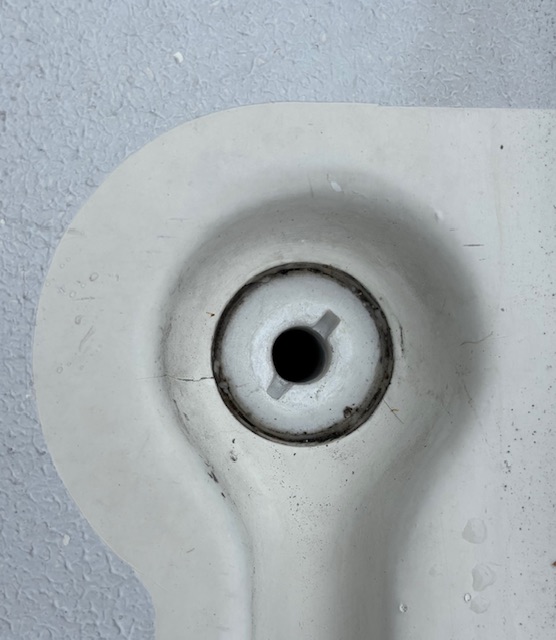

Hi all, in my 4 years cruising our C&C 37, I’ve yet to be disappointed with performance, save for some squirrly runs. I am frustrated though with the inadequate scuppers on deck. The 3/4” drain holes are incapable of evacuating large amounts of water. Has anyone replaced these with larger fittings and if so, do the hoses also need sizing up?

As mentioned, these are on deck intended for water over gunnel. Not talking about cockpit drains—they function well with volume. Talking about side decks, low end of sheer. Gutter extends forward about 8’

Deck scupper hoses are 3/4” ID terminating in an adapter on the seacock that can be replaced with 1.5” fitting/hose. I guess the only question is finding the a deck scupper fitting to accommodate 1.5” hose and the opening on deck. Ideas?

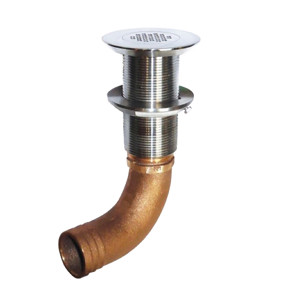

I would look to a 1.5” deck scupper, a full flow 90 and 1.5 smooth hose or pvc pipe to a thru-hull above the waterline.
There are other designs but this is a typical example.
