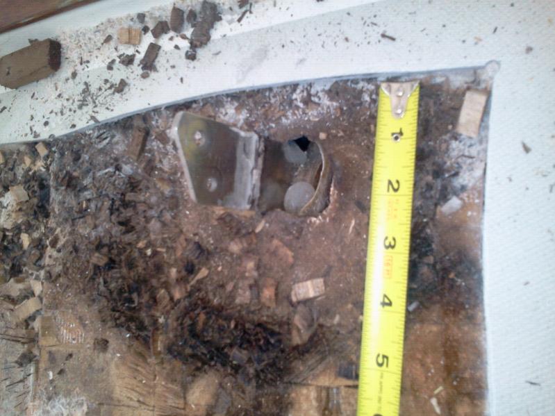

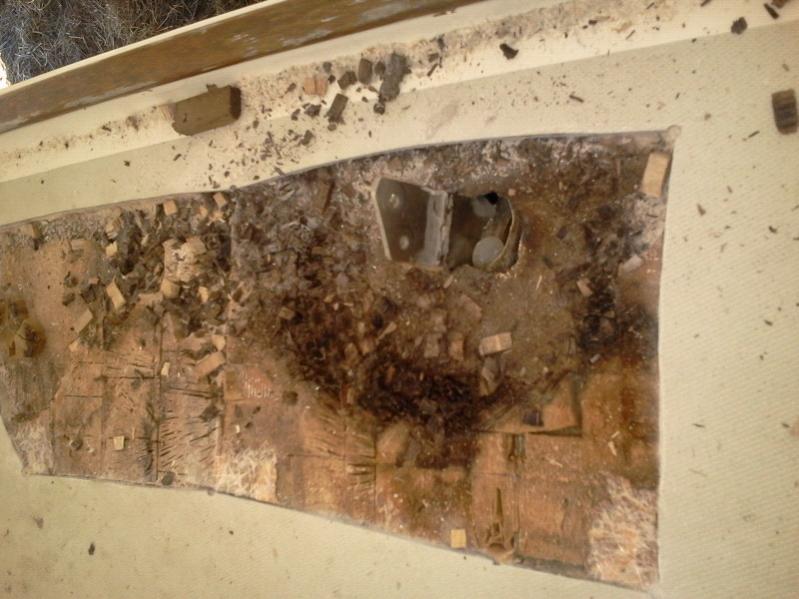

I think I got most of the demolishion work done last weekend. I wound up cutting out an area about 8 inches wide and 16 inches long. It included the area around the chainplate. I think a previous owner must have hit something hard with the chainplate because it is slightly bent and the top layer of the deck had been crudely repaired. When I peeled off the top layer, I saw that the lower layer also had a hole in it just aft of the chainplate. There was a bunch of silicone shot down there, but a chunk of the fiberglass was just laying in there loose. (I'll try to attach a photo.)
Anyway, I was wondering what I need to do around the chainplate. Fortunately, the bulkhead looks and feels solid. There were a few small blocks of solid wood epoxied in around the chainplate between the deck layers. Would this have been the way it was made, or was it part of the bad repair job? What do I need to do around the chainplate to ensure that I get a good watertight seal so it doesn't rot out again?

Wayne, when you repair your deck, you should not install balsa core all the way to the chainplate. Instead, you will want to put just thickened epoxy where you cut your hole for the chainplate, just like when you drill out the holes for through deck fittings. That way even if the sealant around the chain plates leak, you will not be getting moisture into your core material.
