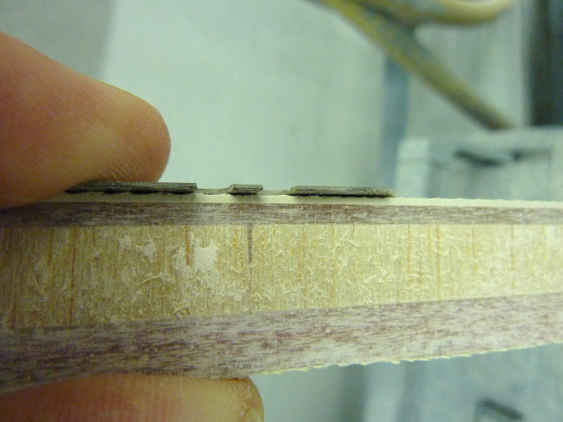

Pearson used baltec for coring in their decks and the top FRG layer is VERY thin.
Yep, and this photo of a Pearson 36-2 deck section should put that in perspective.
That is a box cutter razor blade on top of the deck section. The gelcoat is very thick but the top lamination, not so much. Any rot in this deck is not a good thing..
