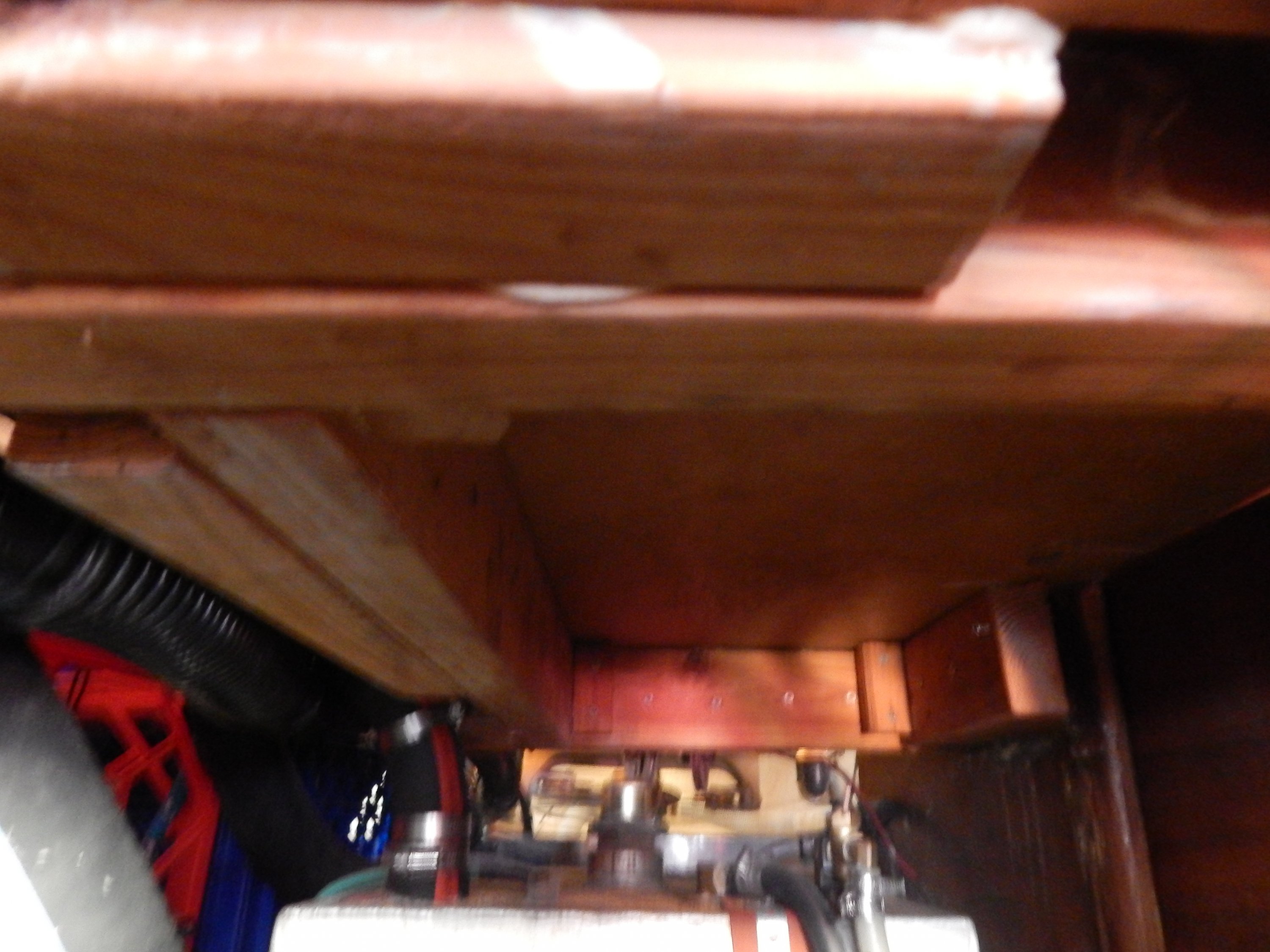

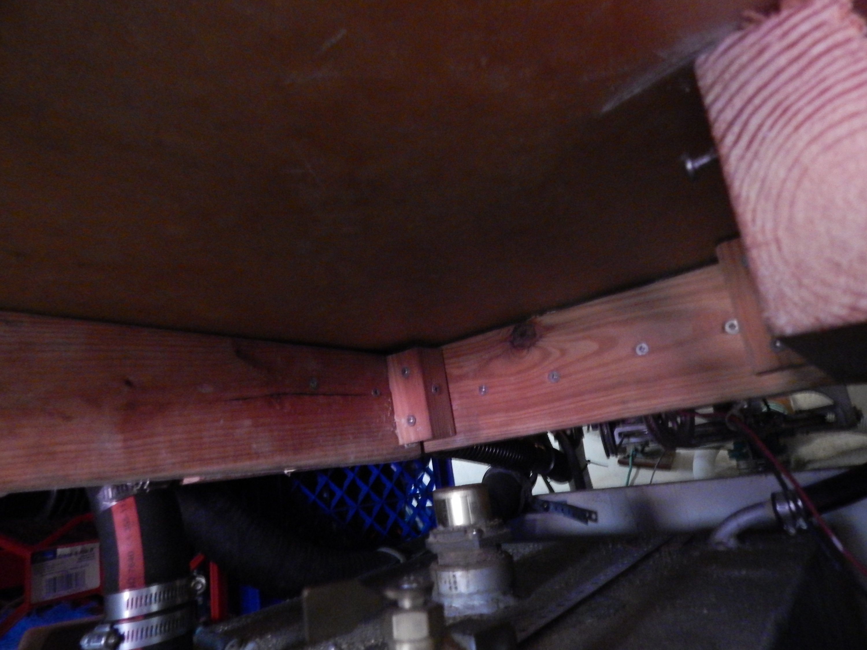

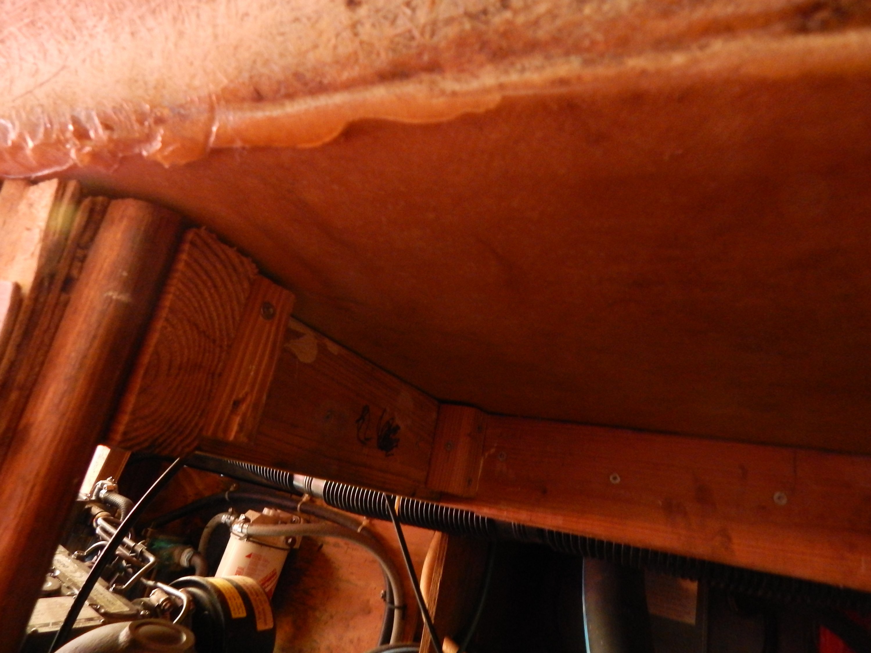

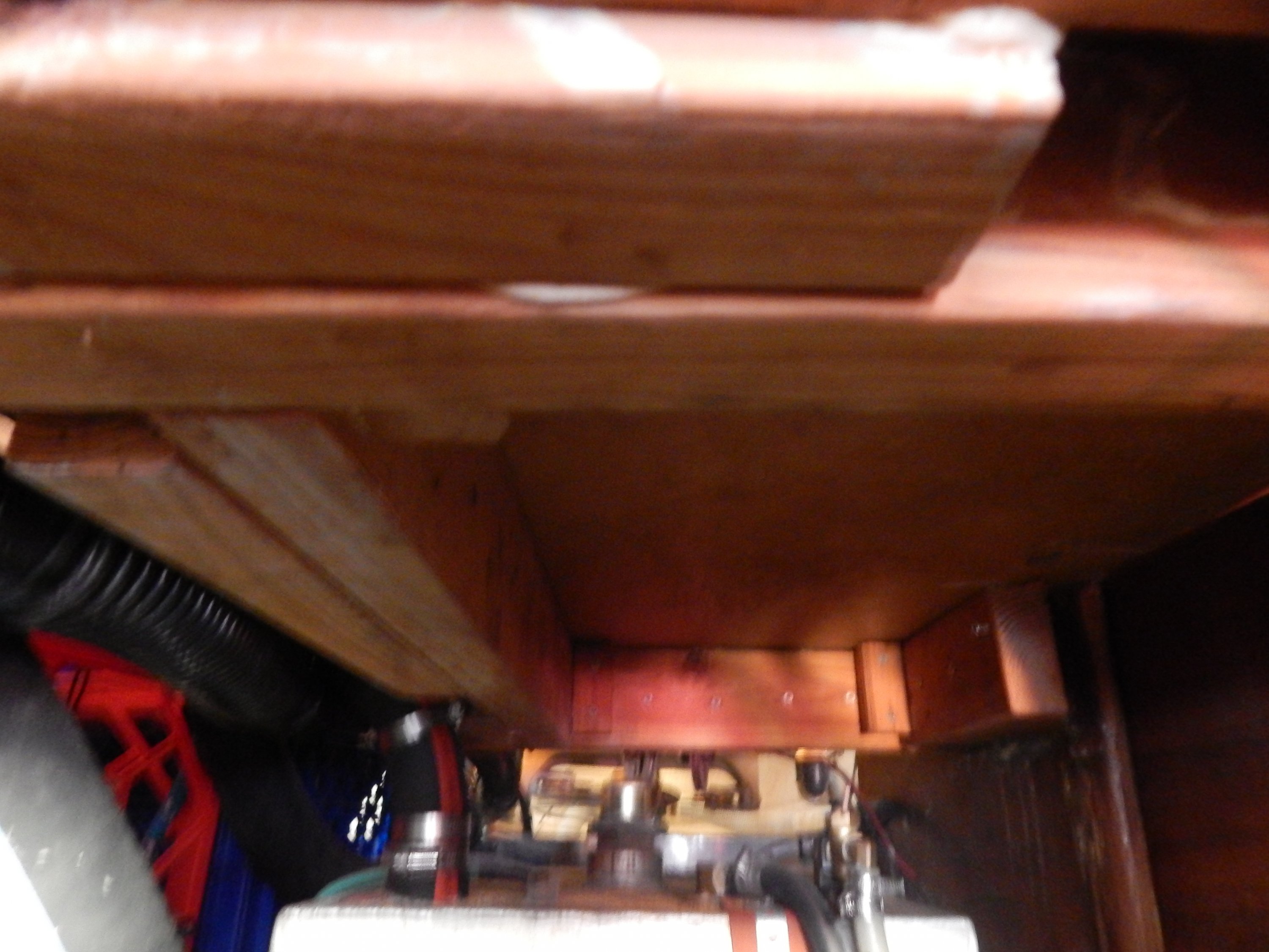

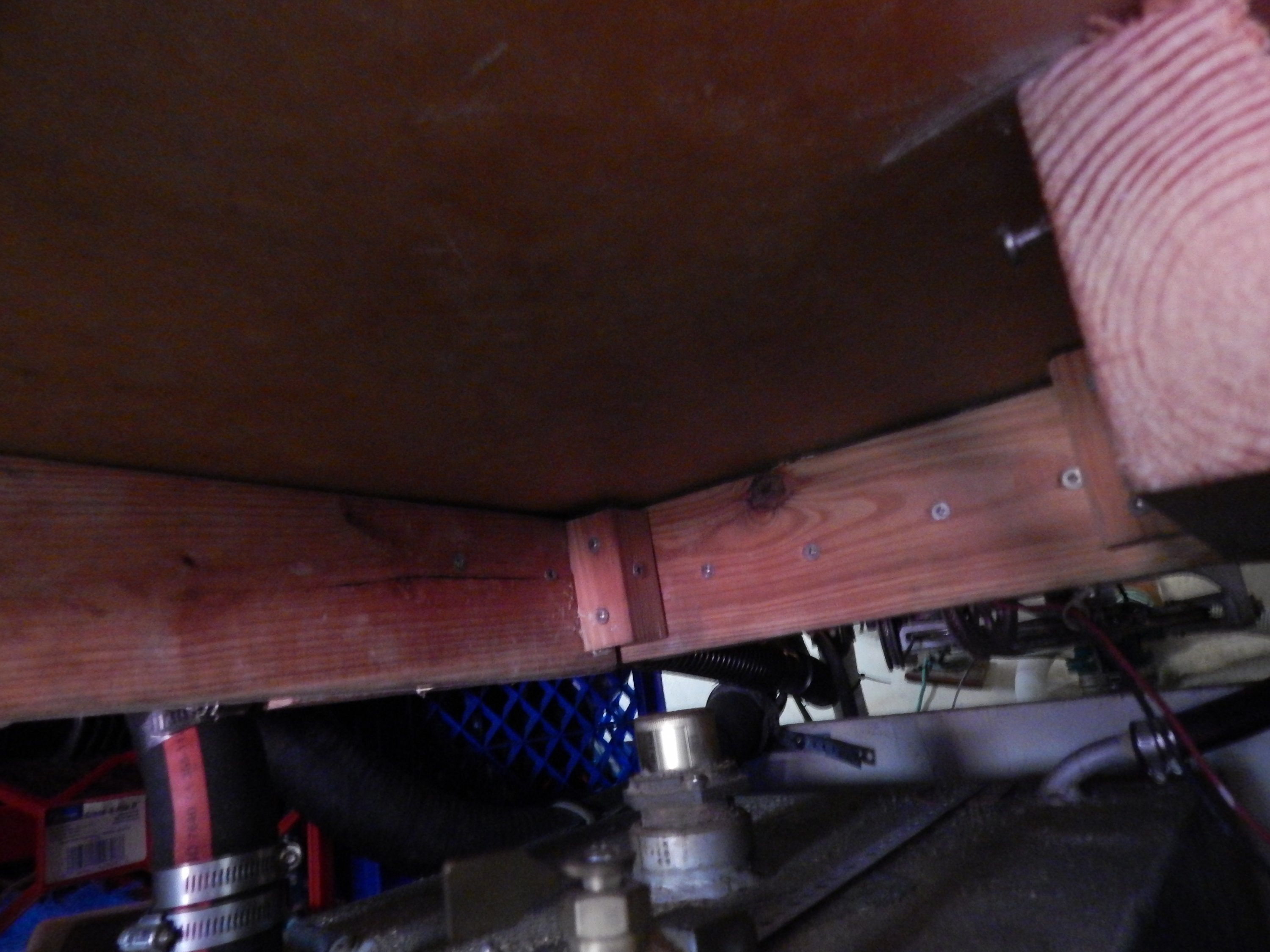

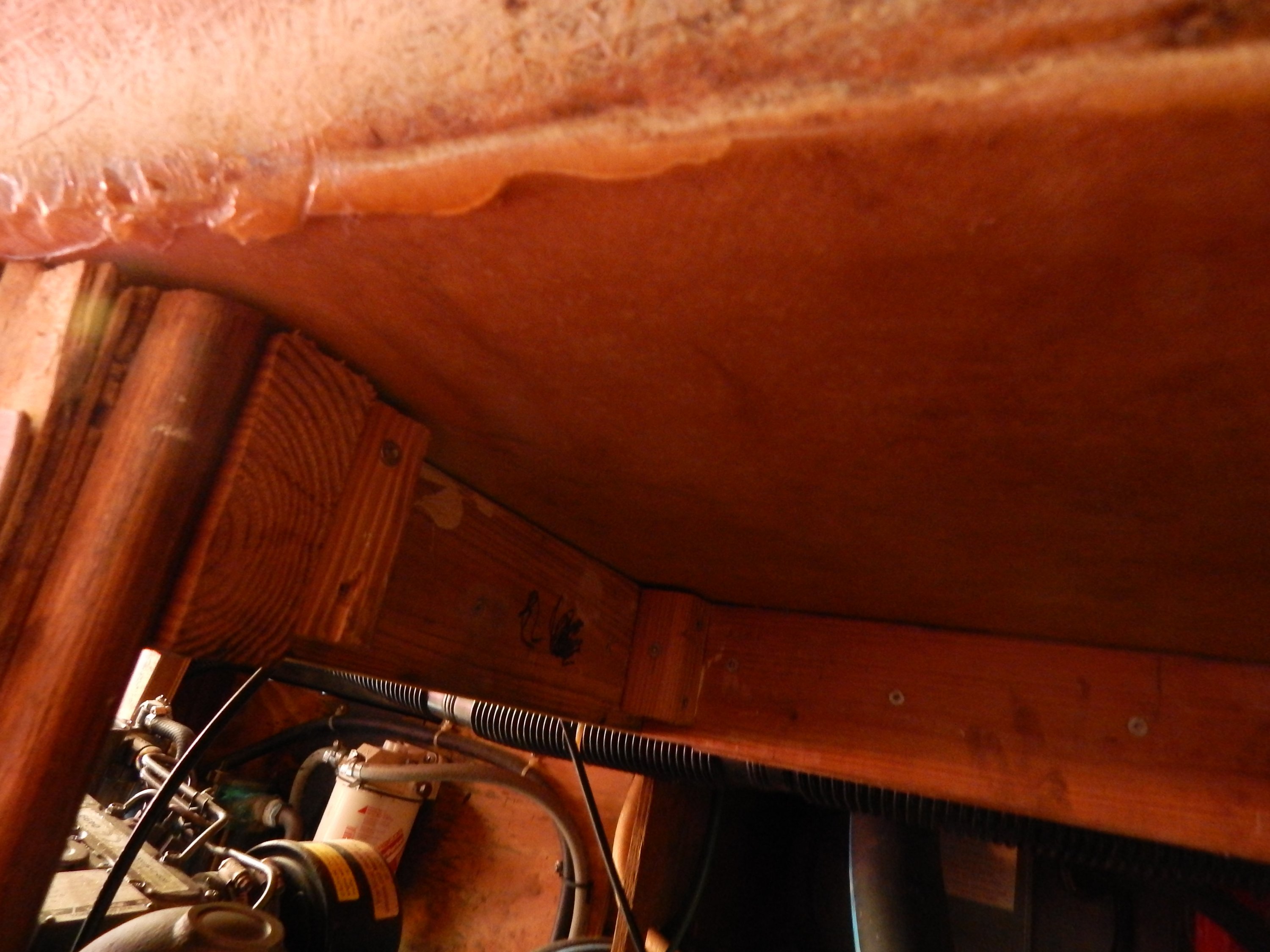

Lee, I would go with the advice of John Cherubini, first. However, in my situation the top and bottom layers were compromised allowing water to drip right on the engine and tranny. The wood core was completely rotted. What I did, and this is most likely overkill, was cut out the entire section leaving a few inches in front of the pedestal, behind the bulkhead into the companionway, and the side bulkheads. Built a frame, see pics and screwed into place. Took a piece of high quality plywood and glassed over. Set this onto the frame and expoxied around and built up, little by little, the sole with glass. Faired to match the original, primed and painted. Pics are looking under the sole. First one looking aft from engine comp., second looking forward from quarter berth, and third looking aft from quarter berth. In retrospect, I really didn't have to go to these extremes but, after more than fifteen years no cracks or leaks.

In such a case of a totally-gone cockpit floor, I would consider the 'mexican hat' solution for sheetrock patching. Cut out the old floor but leave a flange of about 1-1/2" all around (which is outside the old core anyway). Fabricate a skin out of 'glass, or buy a sheet of 'glass, and cut it to fit on top of the flange you left. On the bench, turn it upside down and build up a foam or plywood core (I would use epoxy for all of the, BTW), leaving a flange all the way around, like a replacement floor. In section it will look like a bullfighter's wide flat hat. Then fit this whole thing in on a huge cushion of 5200 and screw it down. When the 5200 is done, pull out the screws and lay up 'glass around the edges, inside and out. This won't fail and it won't leak. And it's easy to do with a few Harbor Freight tools and by following WEST-system instructions.
You're right, that framework is overkill! Just please-oh-please tell me you didn't use pressure-treated yellow pine; and, if you did, please-oh-please-oh-please don't say you used it because it 'won't rot'. Aieeeeeeeeeeee. :banghead:
