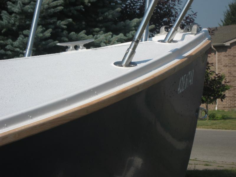

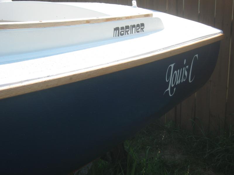

good results with Kiwigrip...
Here's what I did with my Mariner (and it worked great):
-Scrubbed topsides with TSP and dish soap (got rid of grime and old wax in one swoop) with a green Scotchbrite pad
-rinse rinse rinse
-after drying, a gentle sanding with 220 on the "non" non-skid areas (y'dig?)
-no taping, painted "non" non-skid areas with Topsides, overlapping a little (1/2"?) into non-skid areas
-tape off non-skid, spread/roll-on Kiwigrip (hot day? better work fast!). I used a 2" wall scraper to spread the goo (it's like a gel) around evenly but thinly, then the stippling roller to texture it up.
-pull off tape before Kiwigrip starts to set up (like, within 3 minutes) otherwise it peels off like plastic sandwich wrap (no adhesion until cure)
Awesome results, I'm very happy with it. Grippy as all get out, and crisp non-skid edges.
