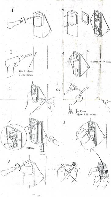

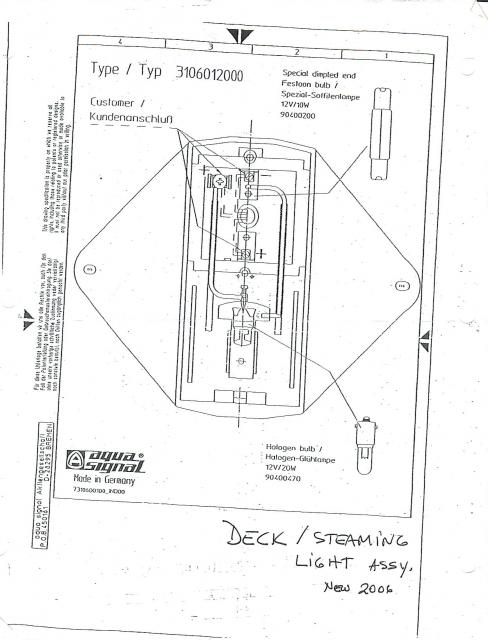

I have a 1986 Hunter 34. The deck light is blown. I believe the same light, or a light very near the deck light, is also for the steaming light. Does anyone know what size/type the bulb is and what tools I need to replace the light before I climb up the mast?
