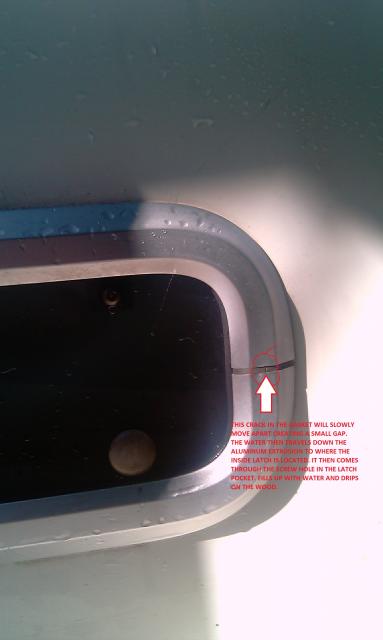

I had a leak and seached for some time before I found it.
The port lights are a 2 piece aluminum extrusion. The water leaked in through the gasket as shown in the attached photo, along the inside of the extrusion to the inside latches. There are small threaded holes in the pockets where the latch goes. The pockets fill with water and if there is enough water they over flow, dripping onto the wood work below.
