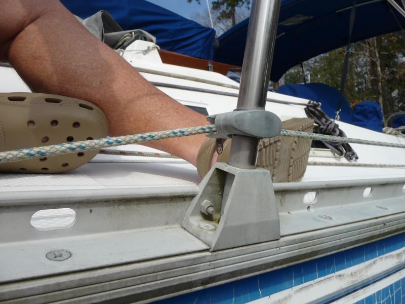

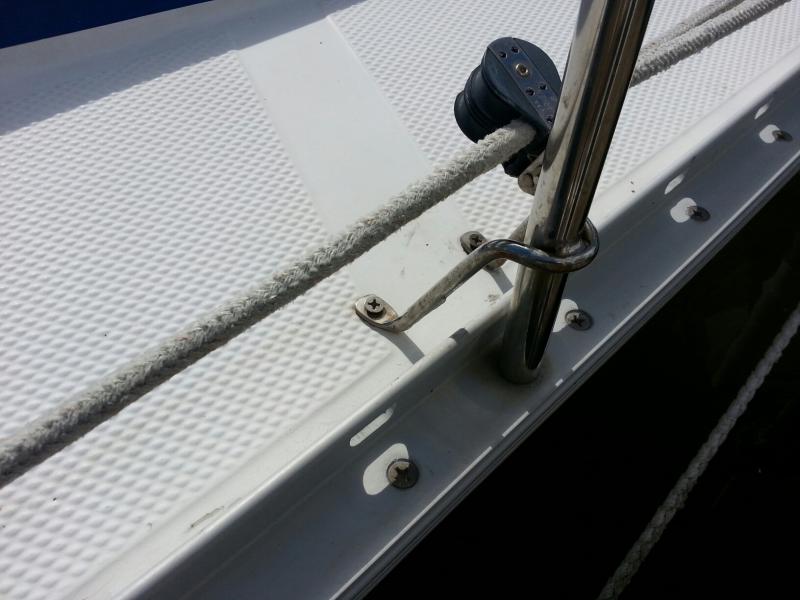

Rare to have a leak on a stanchion on a 34 because they are outboard of the deck, mounted on the outward looking rub rail.. Attached picture..another reason I like the 34 (and 31's) Can ya see where the water is moving from, Mike? is it behind the mirrored cabinet or falling into the sink? or on forward side of the bulkhead? Water tank thru hull vent and or hose is right by there too..

Mine are mounted inside the rail on my H34.... So that could be a possibility -Jon
Edit: Added a better picture.

Interesting, I had not seen that version of bracket on a 34. Also in the picture the screws look loose. Initially I would agree with Splax, but your brackets might be an issue.

Mine isn't the one with the leak. It's an 86 model. I'll check to see if there loose. Thanks Mark!
10,116
PGIJON.. Cool.. I have never seen a 34 with those brackets on the stanchions !
definitely looks like a place for beveled deck holes and "Bed It" Butyl tape.. Not sure that those countersunk headed screws are correct for the application, but hey, if they are working ....
