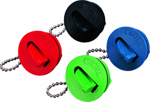

This is the kind I used. I prefer the plastic cap because it doesn't corrode. They are very inexpensive. Also no need for any tools, the cap has a built in flip up handle, very nice.

Alan, do these have threads? The ones we have only take 1/4 turn to take them off. Would these work?

http://www.go2marine.com/product.do?no=63662F
Peter, I don't remember if I had the 1/4 turn caps on my old 34. If you can't find those caps it's a rather easy task to replace the entire deck fill. If you use the glass filled plastic, they are both strong and durable at a great price.
