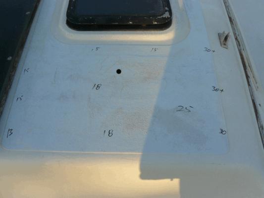

This is one area that needs scattered threads and info concentrated... I've learned a LOT from this group and other places... The first thing was how little I knew - in spite of how much I had already learned... :> I have to thank Maine Sail for a lot of comments there... I did not find just one source to be enough... and without the right tools - the problem can be 10x harder to work on.
When there are a LOT of problem spots to fix - one can get the "deer in the headlight" problem and just "freeze up" when starting work....
Getting the moisture meter and a light dead blow hammer was a good start. Crawling around and writing measurements on the deck made it a lot easier to see where the problems were and begin to format a plan.
I found it strange to see many spots where there was and OBVIOUS potential problem - of water entry... yet the moisture meter would show a problem 6, 10 or 15" away as where there was a "wet spot"... It took the dead blow hammer and some patience to start to trust the meter more...

Do you have a moisture meter? would be very good to move it around deck and just see what it says... I used an erasable whiteboard marker to write numbers down on the deck - so I can step back and see what had happened....
