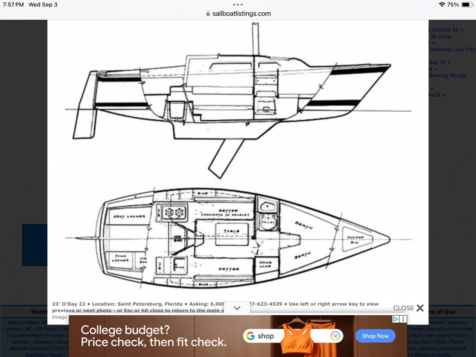

Is this the bulkhead placement of your boat?
if so, you are a few steps ahead of yourself.
The mast step won’t depress unless the bulkhead gave way, the mast post sank or the base of the post rotted away, all of which and structural issues which need to be addressed before dealing with a cosmetic issue like the step area.

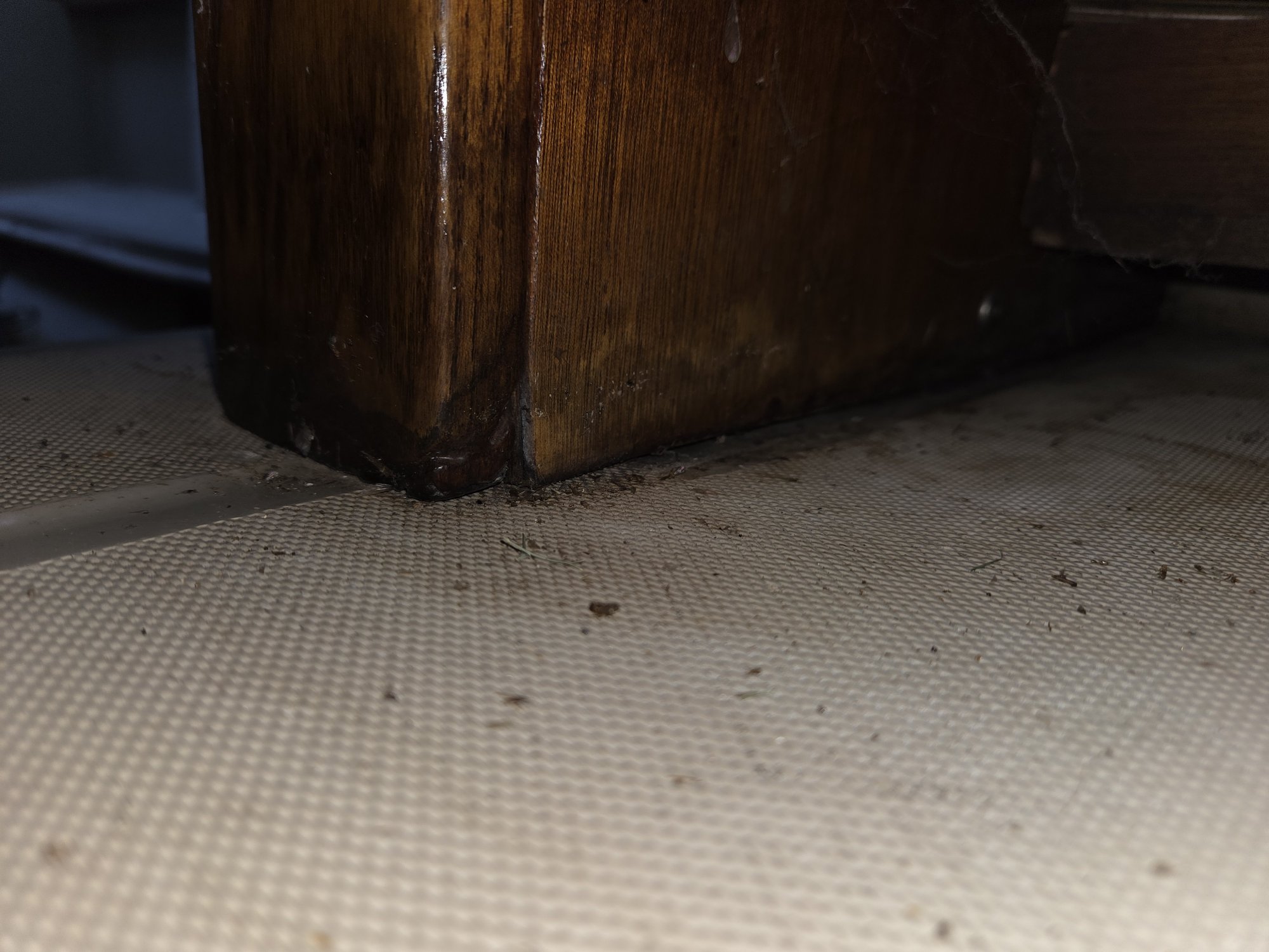

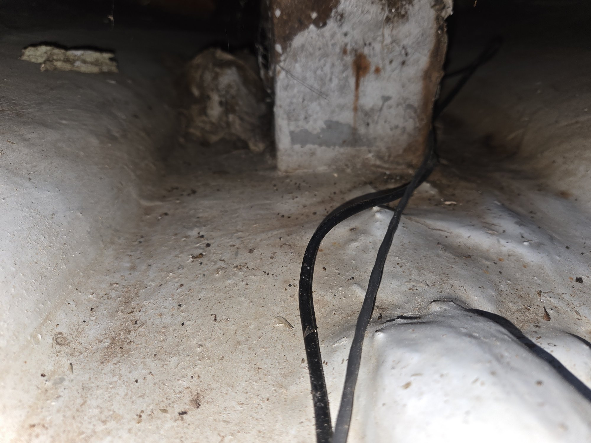

So I jumped in and snapped some photos of the compression post. The bottom of the post on the sole does seem a little deteriorated at the foot, but most of it seems intact. Underneath the cabin sole i am not sure what is there. It seems like 2 2x4's sandwiched that run forward farther than i can reach. It doesn't feel rotten, the best I could describe it is hollow. Maybe fiberglass wrapped rotten wood? What was there from the factory?

Don’t know th design and construction materials originally so can’t help. also can’t tell hat the base of the mast post at the keel is but looks like glass encapsulated wood - worth checking.
The only certainty is the deck area around the mast step doesn’t sink except when something supporting it fails.

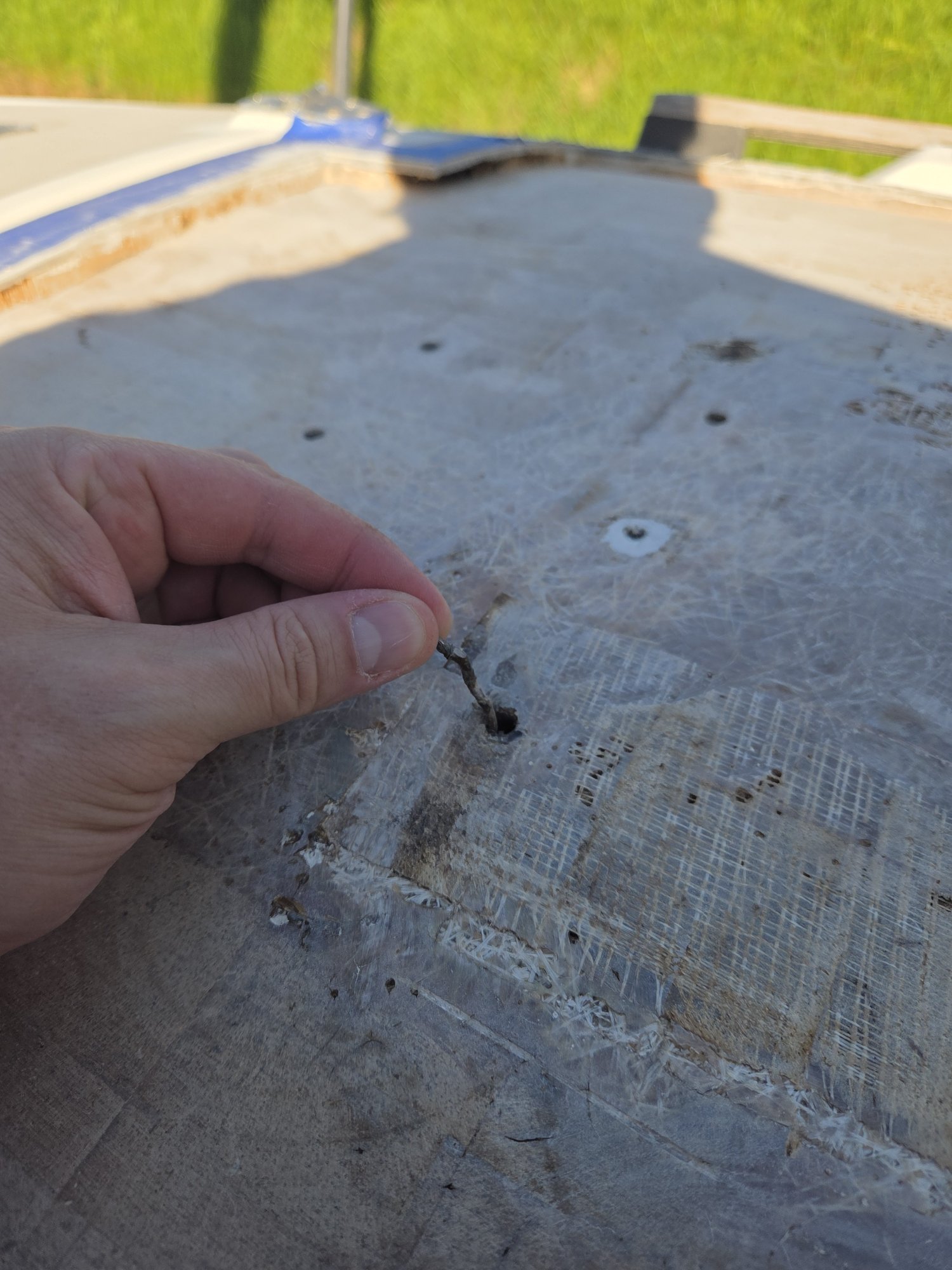

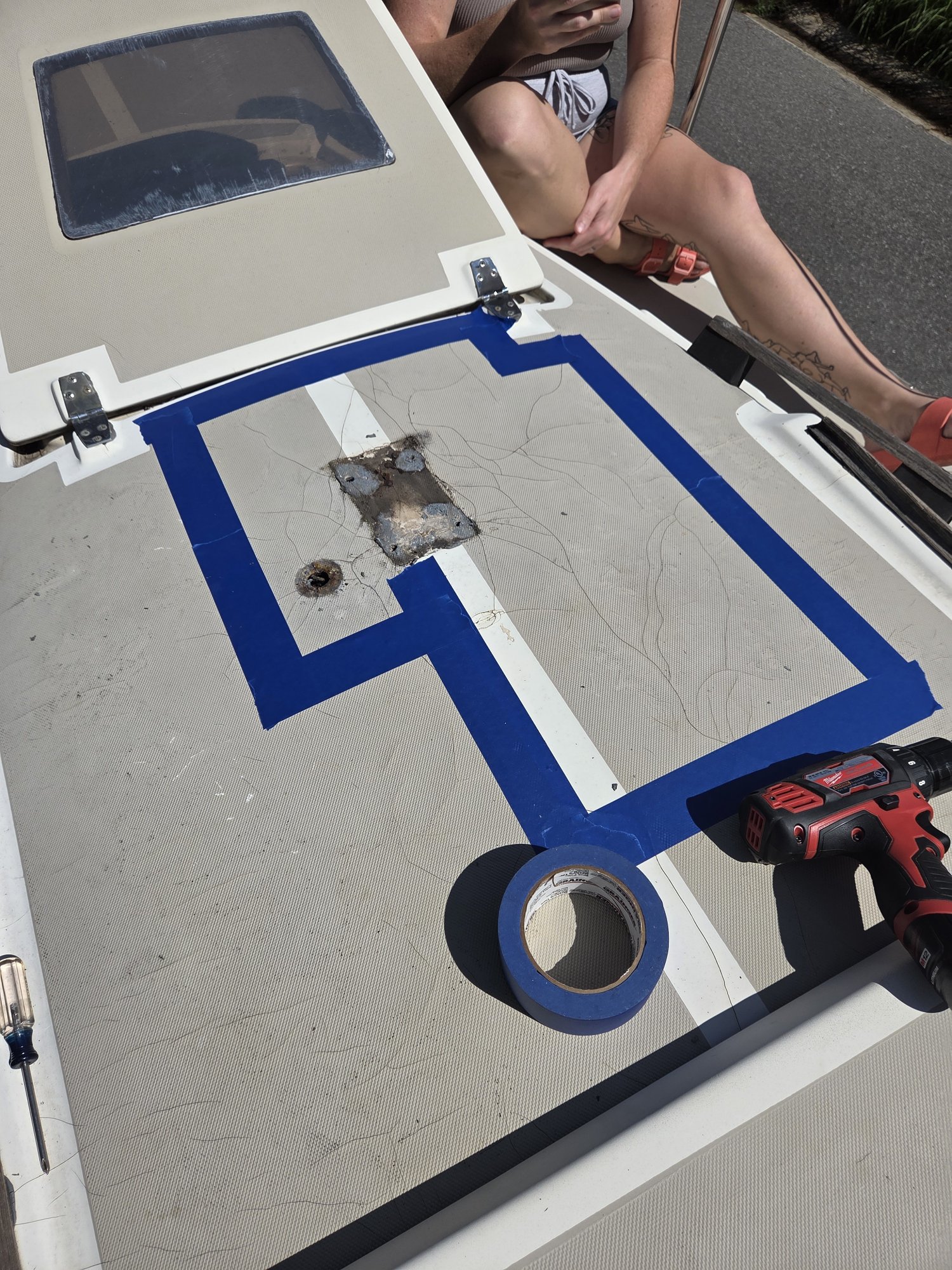

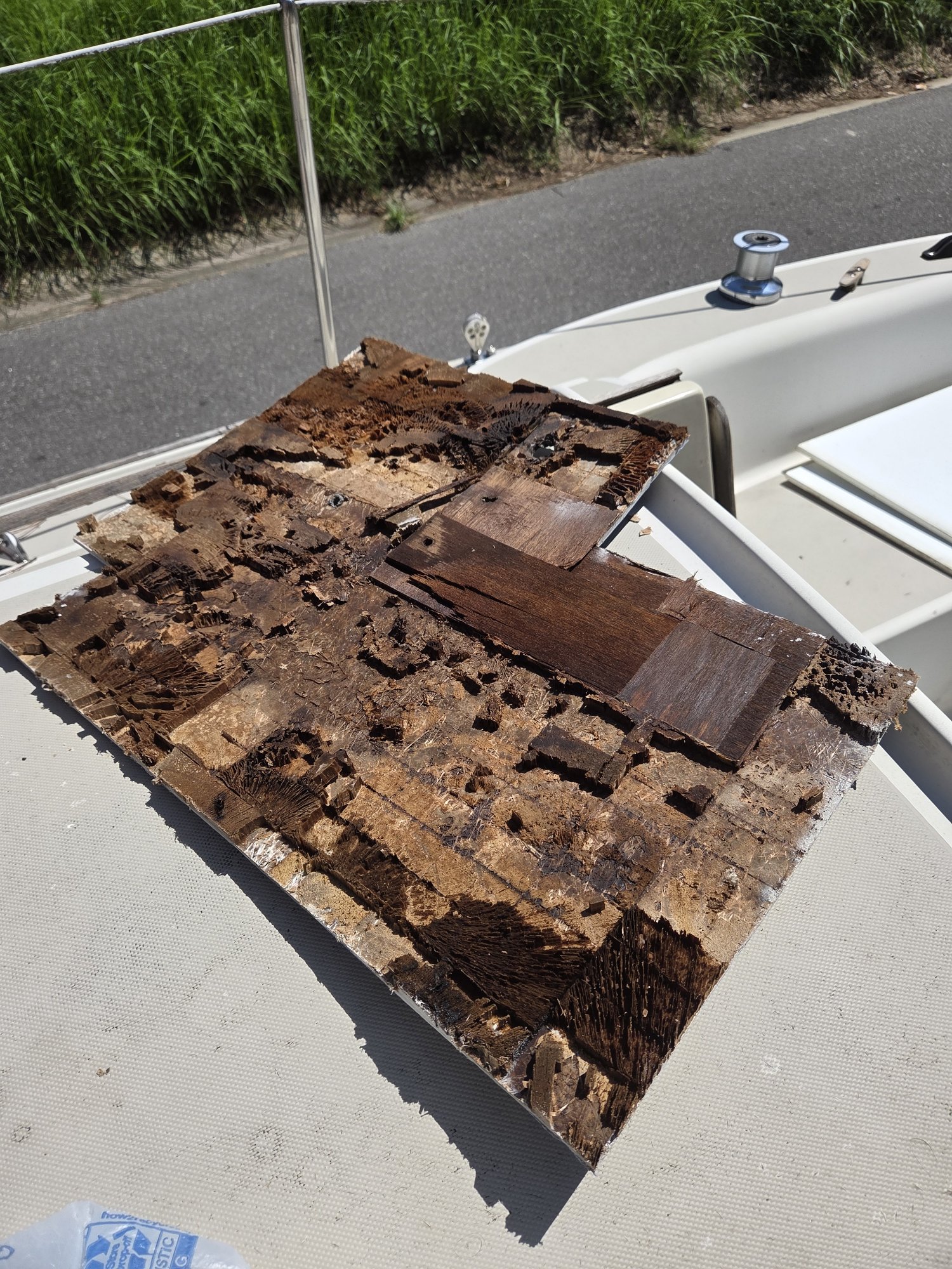

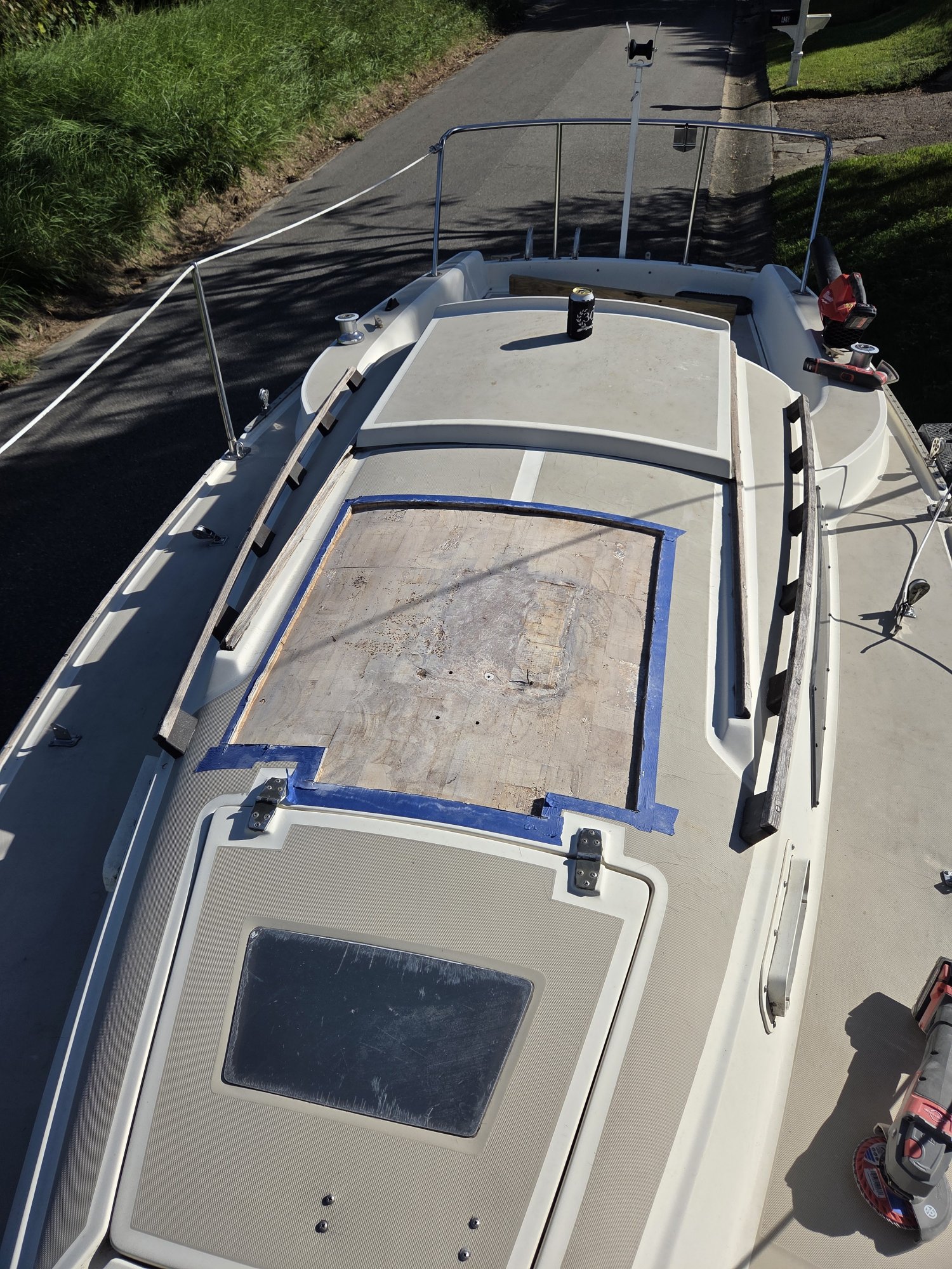

UPDATE: Been quite busy lately, but I managed to make some progress on the O'day. After verifying the compression post and hull structure under the mast were indeed still solid, I did my best to tap the cabin top and tape off a section to cutoff and replace the core.
I found much more wet balsa as I was cleaning out that cavity, so I ended up cutting quite a large section of cabin top out to replace. There was an area of 9x12" plywood under the aft holes of the mast base, but it strangely wasn't under the front holes. I am thinking of layering fiberglass mat to replace the plywood and surrounding the rest with foam core for extra strength and water resistance. Is there any reason that I shouldn't make that solid fiberglass area more centered under the mast base? I of course will also make sure that it can transfer load to the area where the compression post is. Which is the area just under the two aft holes.
It has dried out for about a week. I am going to replace the balsa with Divinycell PVC foam core material, read a lot of the West Systems guide, watched a lot of Boatworks today, but my main issue now is that my mast wiring completely fell apart when I touched it. One conductor came right out, so the wire absolutely needs to be replaced.
