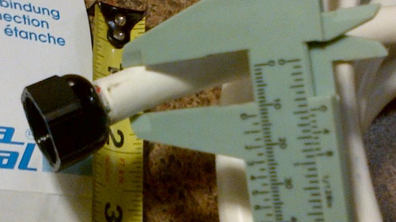

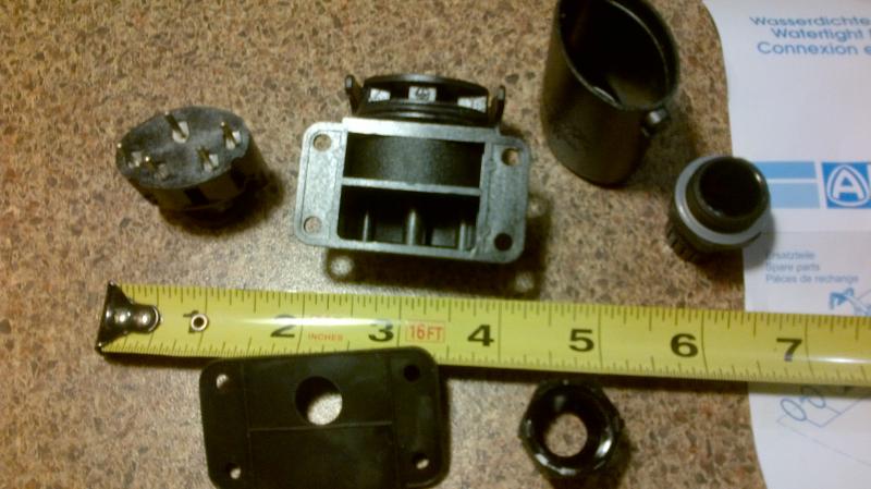

This product looks well built but there is an issue and a question.
Question.... Is the most isolated of the 5 pins the one to make the Negative Pin?
Issue....
The 5 wire cable we are using is 12 mm in diameter but the e connector unit is designed for 10 mm cable.
The choice is...
.....A) Strip off 3 maybe 4 inches of the thick rubber coating plus the non-wire fibres and then replace it with enough shrink coating to seal up the wires and
.....B) Ream out the unit and force the full cable into the unit and risk breaking the unit.
There is enough extra cable to allow me to try A first and see how that works. Choice B is not reverseable.

I reamed my 2 out about 2mm and the first one has been doing fine 4+ years, the second one won't be in use untill spring.
