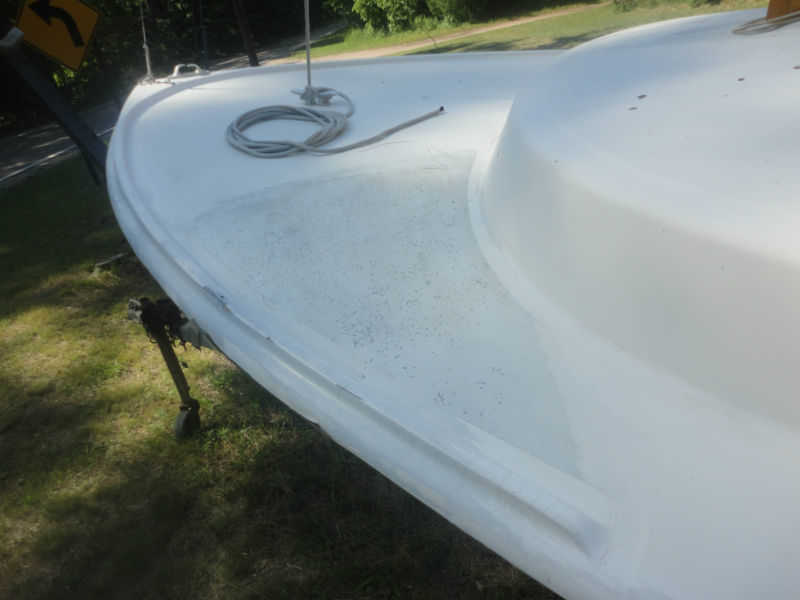

Hey all new to the forum and my widgeon (1974) but not to sailing!
I was wondering what y'all thought about deck cleat positioning for a small boat like the widgeon? I'd like to add a couple and I'm curious to know what the best set-up is for them. Temporary dock tying is inconvenient without a cleat, so I was planning on putting two just forward of the transom and two somewhere on the bow or possibly amidship. I won't be anchoring much, but it's a possibility. Any suggestions or pictures from your (smaller) boats with deck cleats?

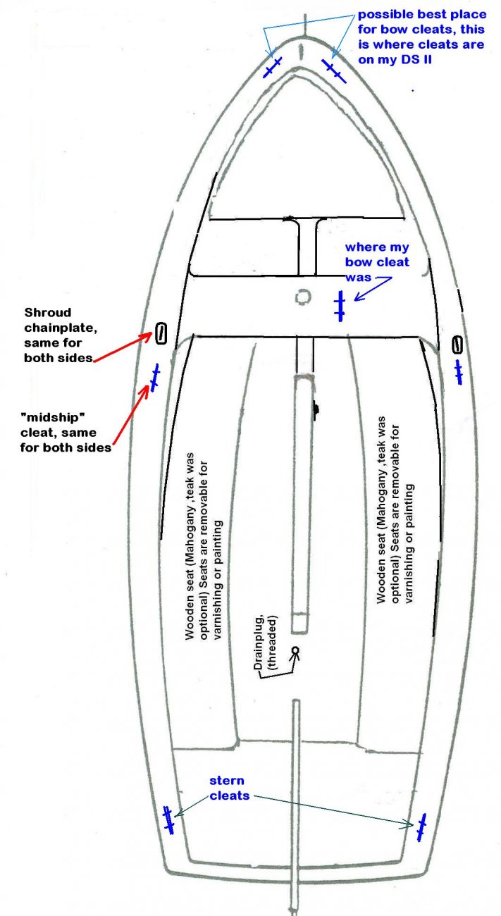

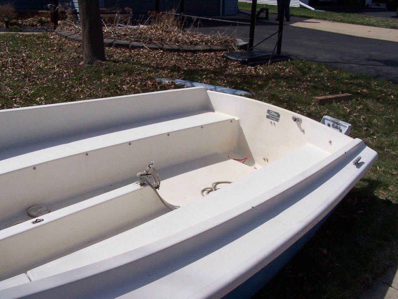

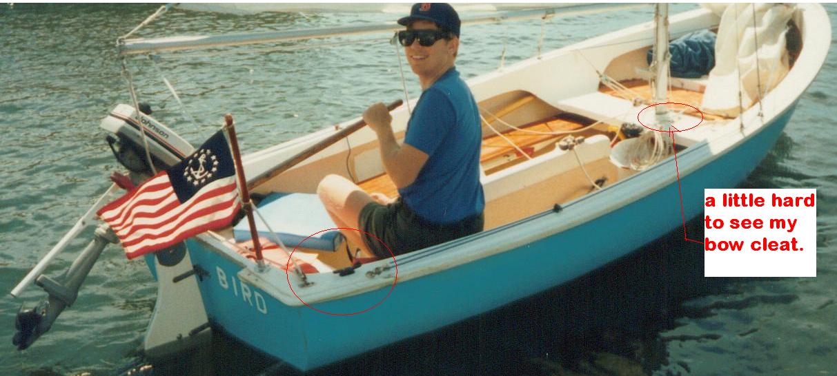

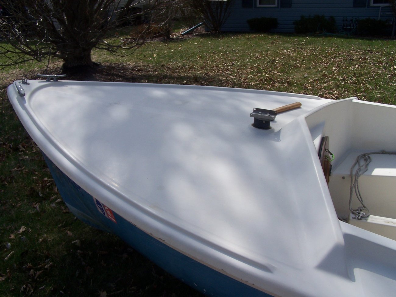

I had a single bow cleat on my WIDGEON, and a pair of small cleats at the stern (one on each side deck, just forward of the mainsheet blocks) My Widgeon was older than yours, and did not have the forward deck so my bow cleat was actually on the seat that runs across the boat where the mast steps. I never installed mid-ships cleats on the WIDGEON, I do have them on my DS II. If I had a foredeck like your boat, I'd position the cleat either dead-centered on the deck (fore & aft, Port to Starboard) or just forward of the point of the sort-of spray rail at the edge of the deck with a chock just to one side of the forestay to keep the line nearly centered. Other idea would be a pair of cleats right at the bow, one on each side of the forestay. I think for best ease of use, the single cleat (I used a 5" mooring cleat) with a bow chock will be easiest to use. Here is a diagram of where my cleats were, and a picture. I also added a picture of a DS II with the cleat mounted in the center of the deck and a bow chock mounted next to the forestay. You could mount the cleat just aft of the forestay and maybe avoid the need for the chock which would only be needed for anchoring.......worth thinking about, although I like the idea of the cleat mounted in the center of the deck or just ahead of the spray rail, even though it would need the chock, just because it is easier to reach from the cockpit.
