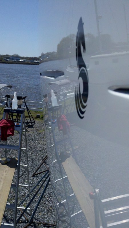

I don't think it mattered. I hand washed my hull with the Starbrite boat wash (couple of caps fulls per gallon of water) that does not remove the wax. I then polished but used the Presta Ultra Cutting Cream Light rather than Finesse It II. (I used the Presta Light because my hull was not highly oxidized.) Then I waxed with 2 coats of Collinite 885 Fleet Wax Paste.
Basically, I started at step 4 of Maine Sails Tips for a Great Buff Wax:
Note that I bought the Makita buffer and the yellow wool polishing pad then followed the directions to a tee. I have had nothing but compliments for the past two weekends. Two guys told me I have the best wax job in the marina. It took every bit of 24 man hours to do my Beneteau 46 stem to stern.
Saw Easy Wind last week when we stopped by to check out the new Elusive. No doubt you have the best shine in the marina. Definately has the Wow factor. When are you heading to the bay?
