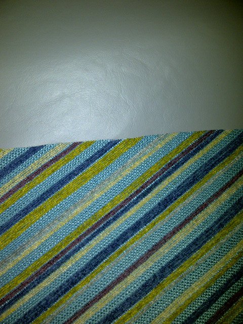

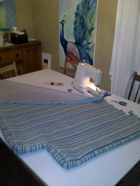

I tried all kinds of crazy things in terms of washing and drying and airing and just went and got new foam.
Boy did I waist allot of time!
I went to a mattress place and got 3 Queen size 3" mattresses for $220.
I also made new covers. I don't know what a new boat smells like. But I do know what our new cushions don't smell like!
They smell lovely now.
