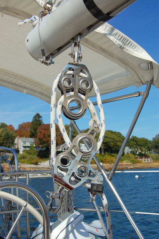

I just found this photo in my archives and thought it would be a good idea to post with winter coming.
For those of you who remove your mast and or boom for winter and want to avoid those nasty spring time tangles in main sheet, boom vang or other block assemblies simply snug the two blocks together and knot or jamb the line.
This prevents them from twisting inside out over the winter and makes re-rigging in the spring a snap with no tangles. Simple but effective.

Thanks Maine Sail. Good tip. I learned this one years ago when storing the downhaul for my windsurfer rigs.
You just reminded me I need to buy another fiddle block from Garhauer.
THANK YOU !!!!!, I was just recently looking to re-string (if that is the correct term) my vang and could not remember how it went after line replacement (should have drawn a picture or taken one) and low and behold you posted it for me!!!!! Thank you, thank you, thank you ...... it is much appreciated and good timing.
and thank you for teh winter tip as well
