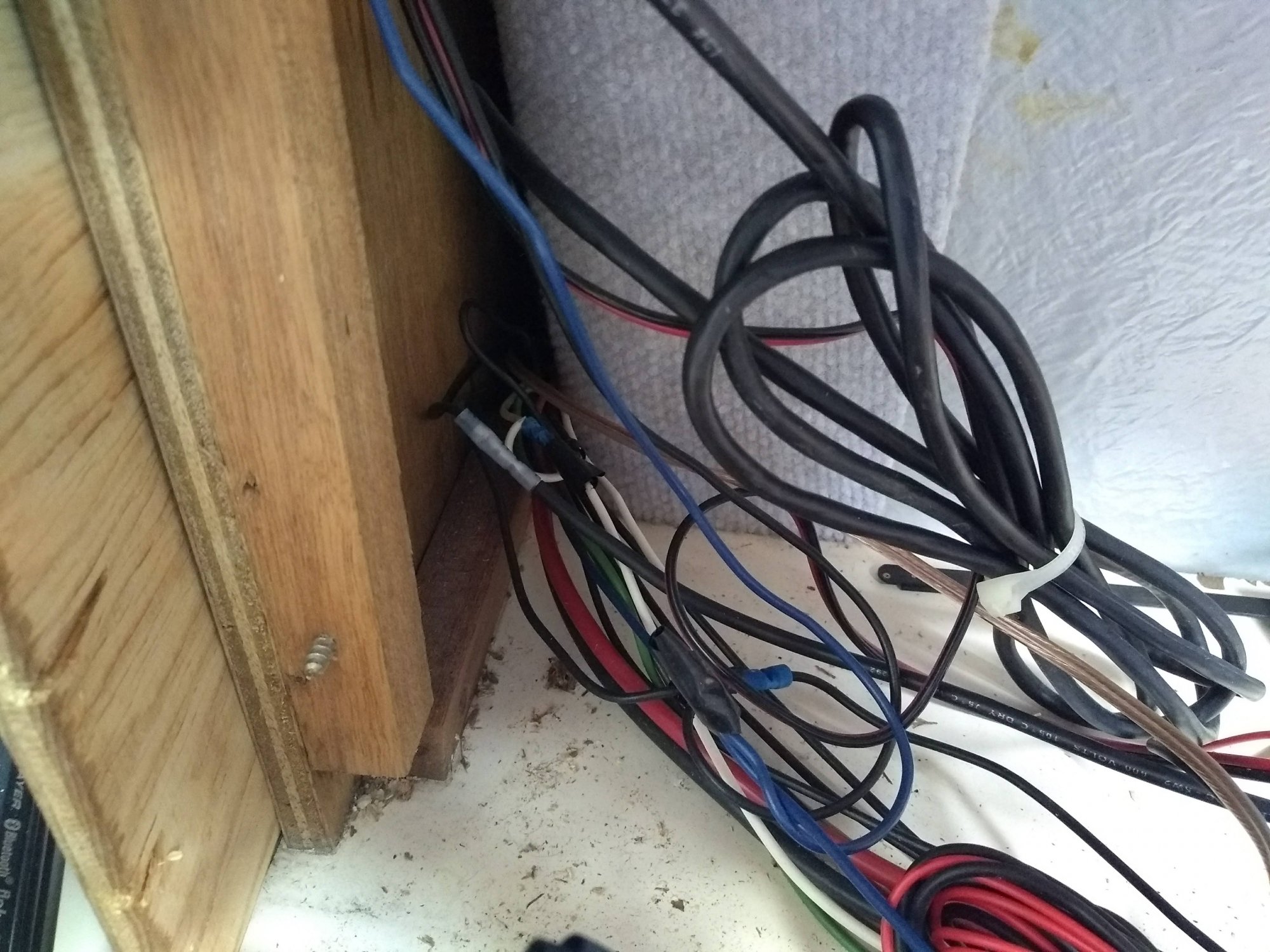

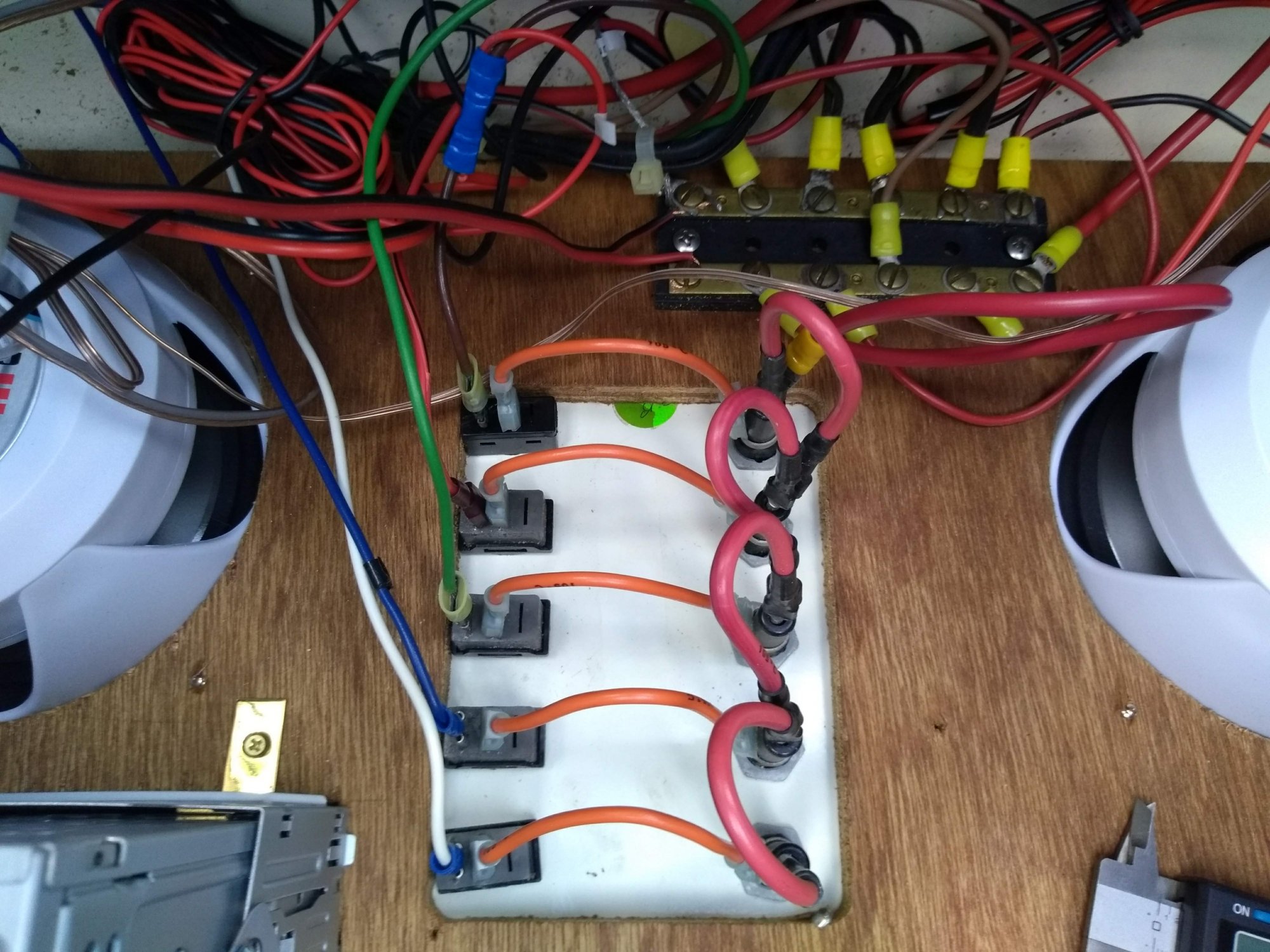

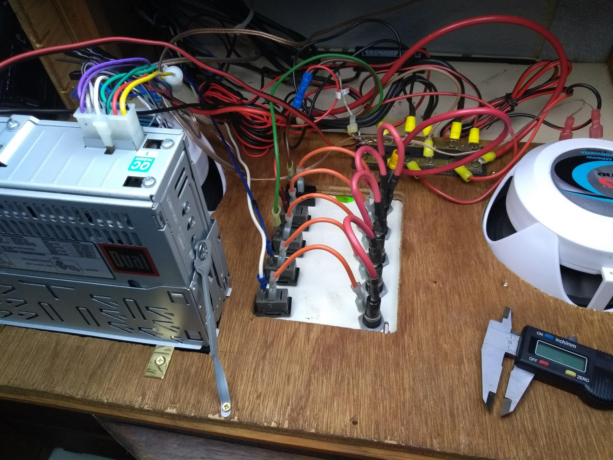

Regarding the need to go through the wiring, I'm just gonna leave these right here:
That radio is going to be replaced with a bluetooth unit that'll be about 1/4 the depth, and that will help the panel fit back into it's original location. I'll be labeling and organizing the wiring, and replacing anything that has questionable splices. I also want to add an auto/manual bilge pump switch, as right now it's just wired to one of the Aux switches. Anyway, now that I have an inventory I'll be ordering up all the bits and bobs I'll need to make this much safer and hopefully more reliable.

I made a LOT of progress today on the wiring. The house and outboard wiring is all fuse protected right at the battery, a mess of cheap butt splicing with no seal is completely replaced, the cabin lights are now wired correct with the center of the socket being POS and the housing negative (ALL the lights were bassackwards, so I think that was a factory feature), and the bilge pump wiring is cleaned up and ready for me to install the new Manual/Auto switch when I get a chance. I also have most of the wiring in place ready for solar install, as well as a battery monitor to keep track of charge and usage.
