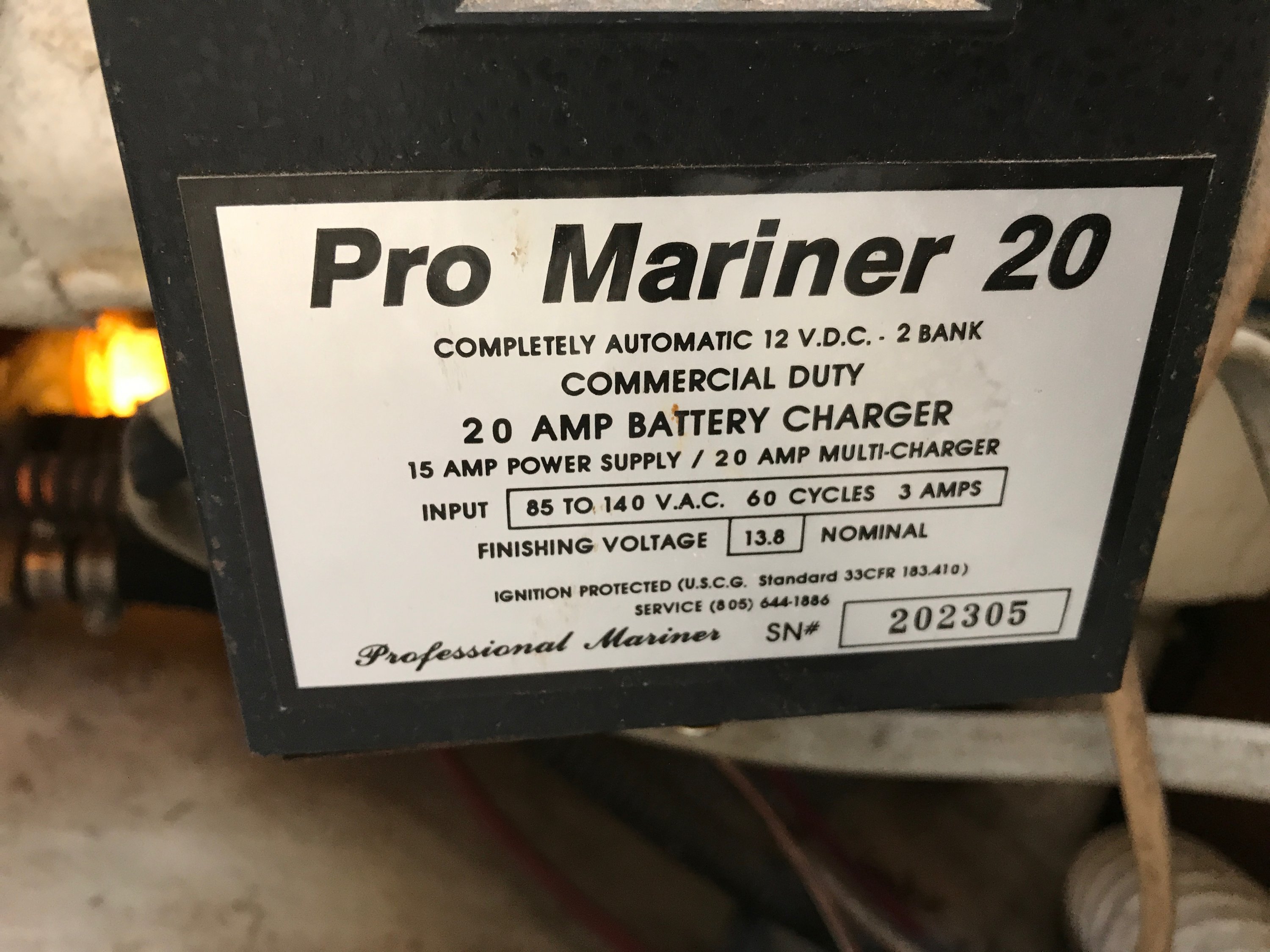

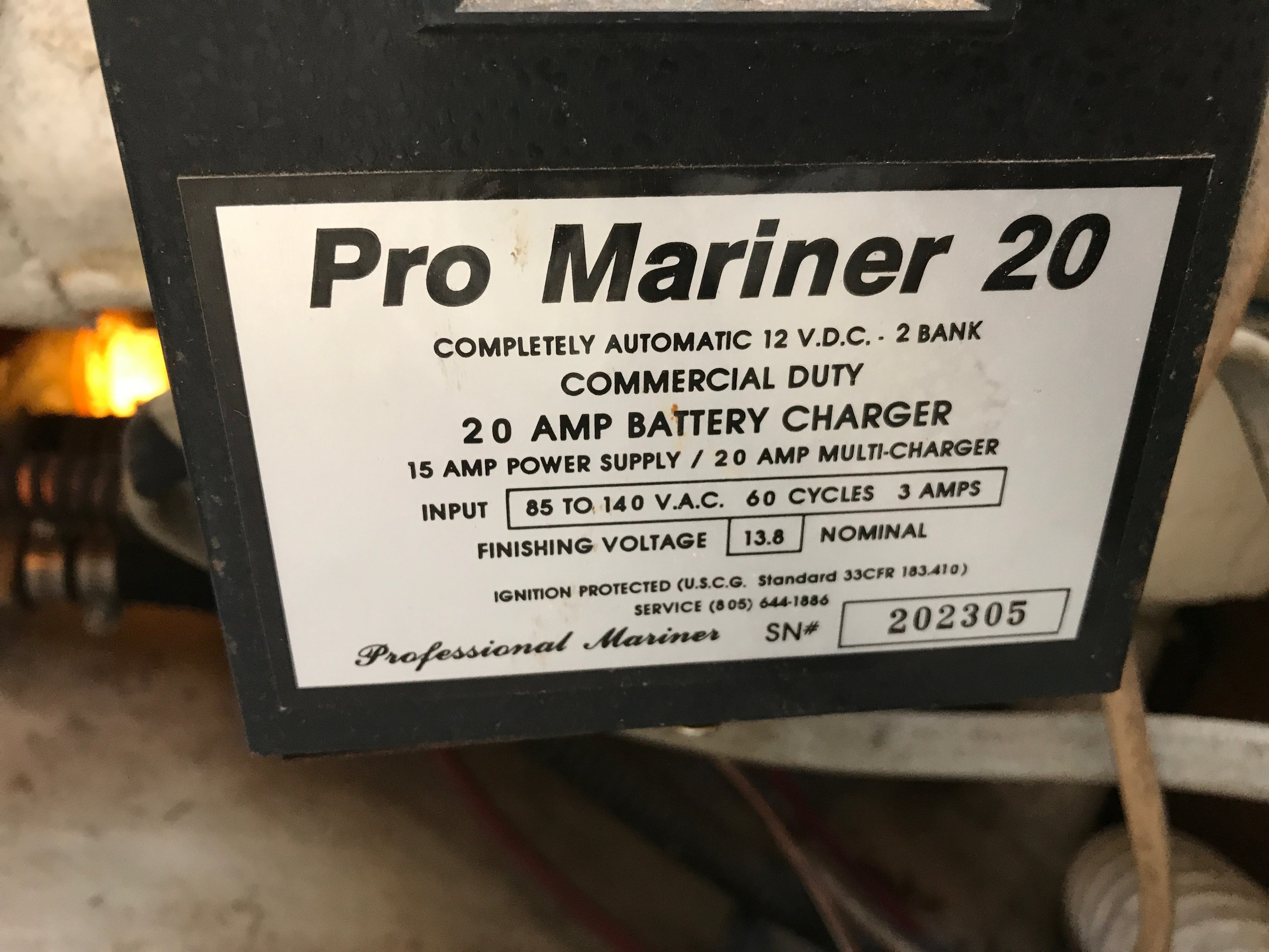

1. Currently I have a Pro Mariner 20 two-bank charger. I’ve read in some forums about a Pro Mariner 20 charger, called a “flyback” charger, is prone to catch fire.
Is the one in the photo below one of these flyback chargers or a safety concern?

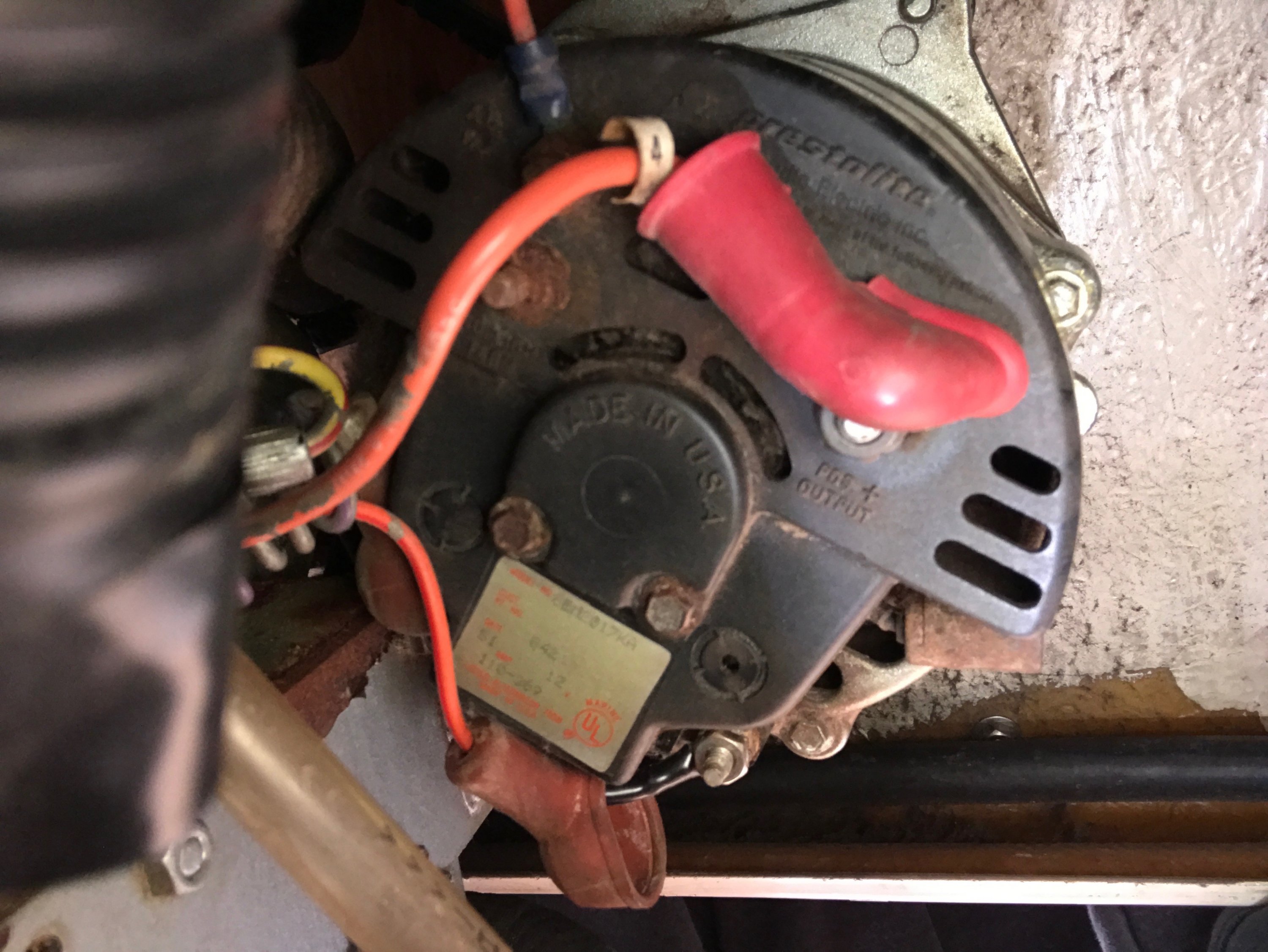

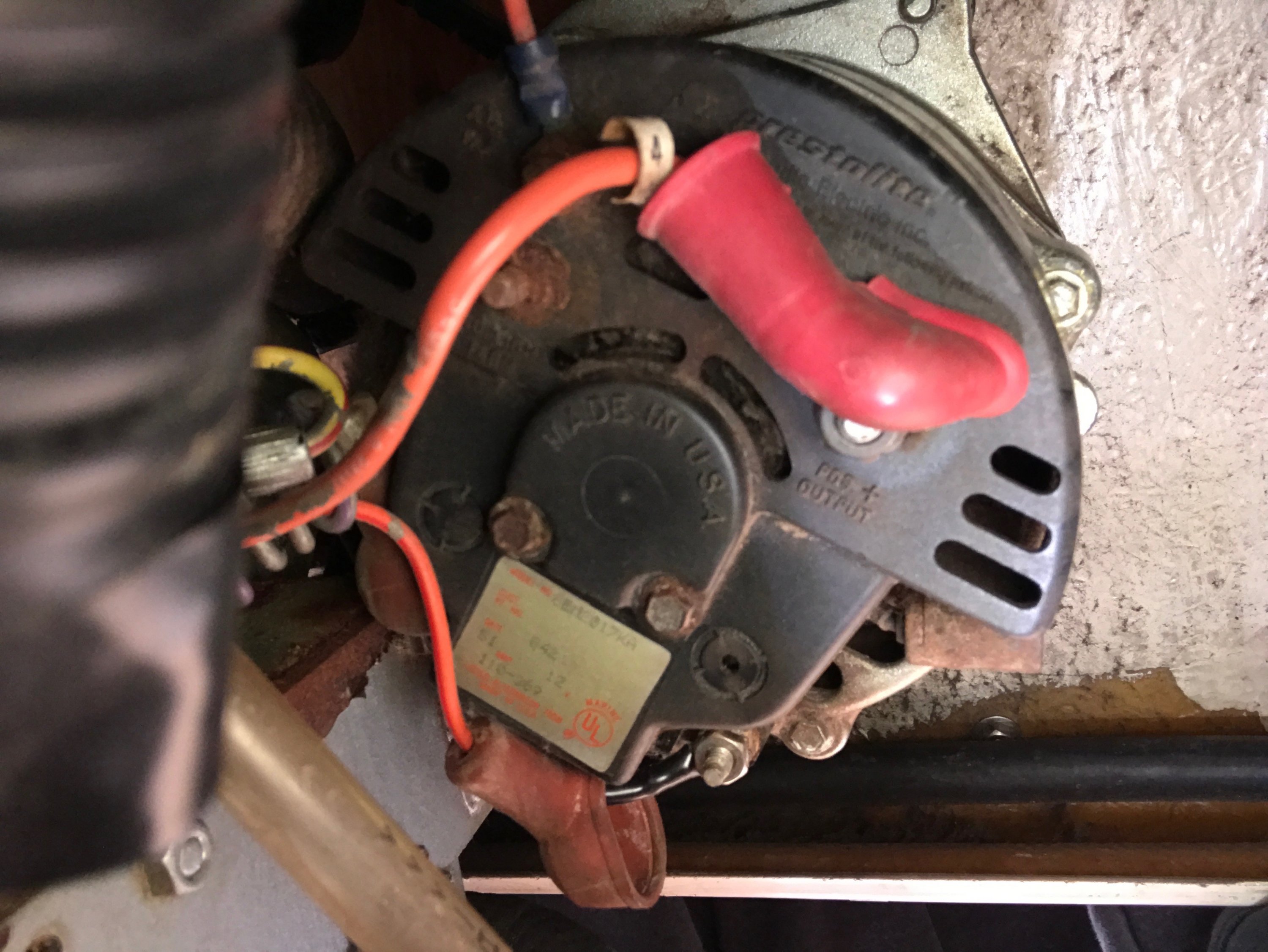

5. The alternator looks pretty rough on the connection side with a couple of studs really rusted up (Photo below). Part of the upgrade will be rewiring the Alt Output to the house bank.
Should I include taking it to a shop to be checked out and new studs installed during my upgrades?
Not sure if this a "flyback" charger. It is an old style ferro-resonant charger. Replacing it with a modern charger, like a Pro Mariner ProNautic or Sterling would make your batteries happier. I pulled a similar one out of my boat a couple of years ago, be careful, those suckers are heavy, mine weighed 35 pounds.

Ward. The alternator is a critical item in your system. I would take it in have it inspected and serviced. Rust outside likely rust inside.
Not a "fry-black" just an antique single-stage battery murderer/boat anchor..
At this age it would be a good idea to have it gone through...
Sounds like I should move the charger upgrade up on my priority list. Especially when I am using much better batteries than planned.
I will put it on the list.

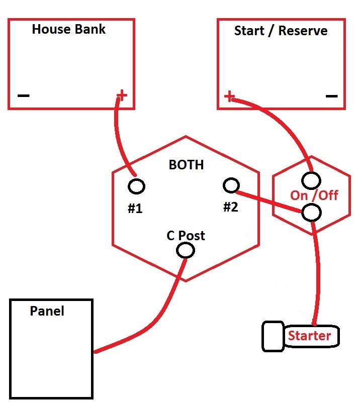

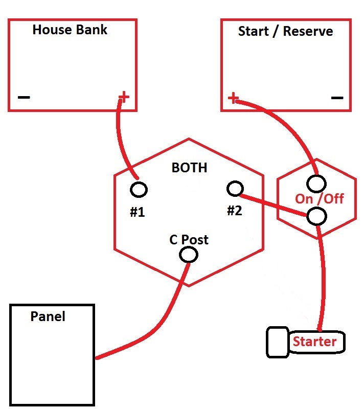

Ward, one other option to consider, especially if you're going with a set of GC2s for house is to wire your "spare" battery as a starter battery. This schematic shows one version of it. A little more complex, but it gives you the same flexibility, and keeps your house isolated from the starter current draw.
