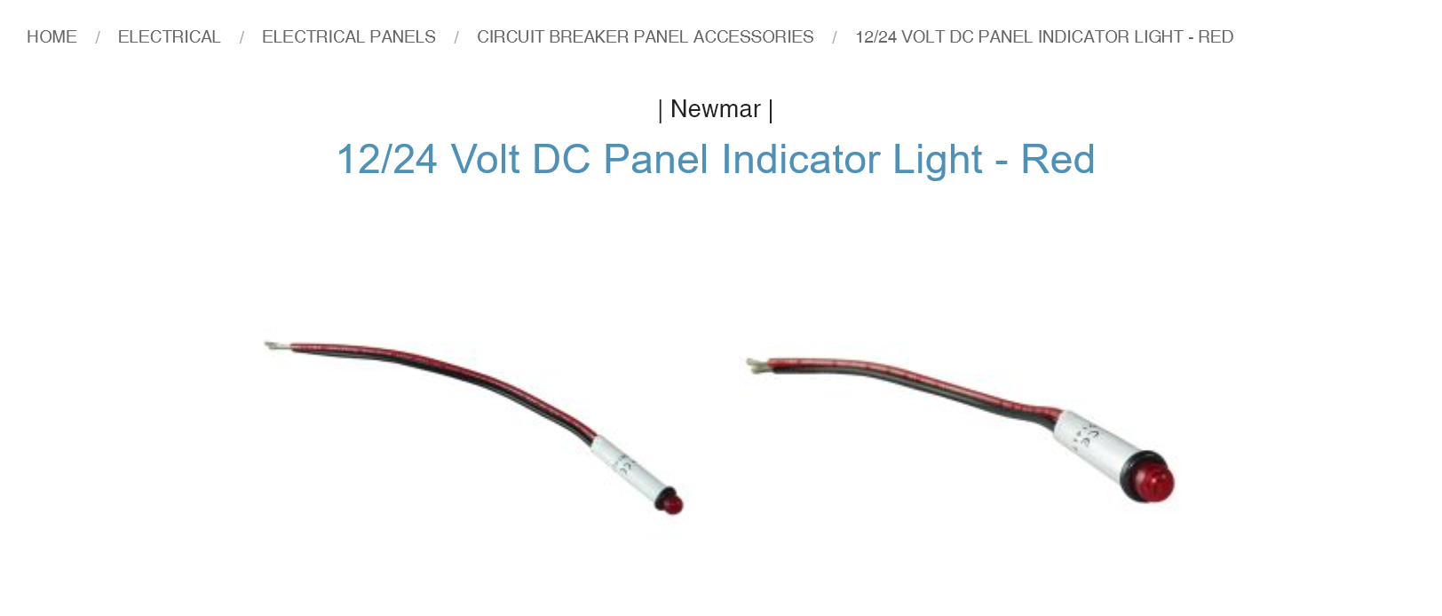

If your Bene DC panel is anything like my Hunter DC panel, I've lost something like 3 LED's over the 24 year life of the boat. Also lost one AC indicator LED. It was definitely the bulb and not a loose wire in all cases. Just cheap tiny little bulbs.
Available here at the chandelry :

Thanks. I think I'm going to start there.

the indicator LED for the refrigeration switch on the DC panel had stopped working. The circuit still works, the refrigeration turns on and works fine but no indictaor light. The boat is a Beneteau 323.
Changed one of the DC panel LED indicator lights on my Beneteau 343 in May. Ordered a replacement from Beneteau spare parts that was way overpriced; however, I wanted the "exact" OEM replacement bulb so that I could swap out the old bulb with no modification. The bulb didn't fit & I broke it attempting to insert it into the panel. Ordered a Blue Sea bulb #8171 from Amazon & an 11/64" drill bit to slightly enlarge the panel hole. Fit like a champ at a fraction of the cost of the Beneteau bulb (including the drill bit)! Looks exactly like the OEM bulb when illuminated. Not uncommon for these bulbs to expire.

Wow! that is approximately what I paid for the Beneteau bulb. Amazon had the blue seas bulb discounted to $3.58 & free two day shipping with Amazon Prime. At that price: I purchased two! Don't forget the 11/64" drill bit.

I have a 1996 Beneteau Oceanis 351 ( in the UK ) - and one of my red switch panel indicators failed about 6 months ago. I replaced it with a "Blue Sea PN 8171" - which ( was of course Red) was easy to install, worked and matched very very well (such as colour and brightness)

Great - here in the UK "Blue Sea" supplies seem to be currently less available - but following the installation I referred to above, I bought two more LEDs for future use a while back ( phew !! ) . FYI if I recall I removed and replaced both the LED and its black holder. I'd be glad to hear how your replacement goes.
