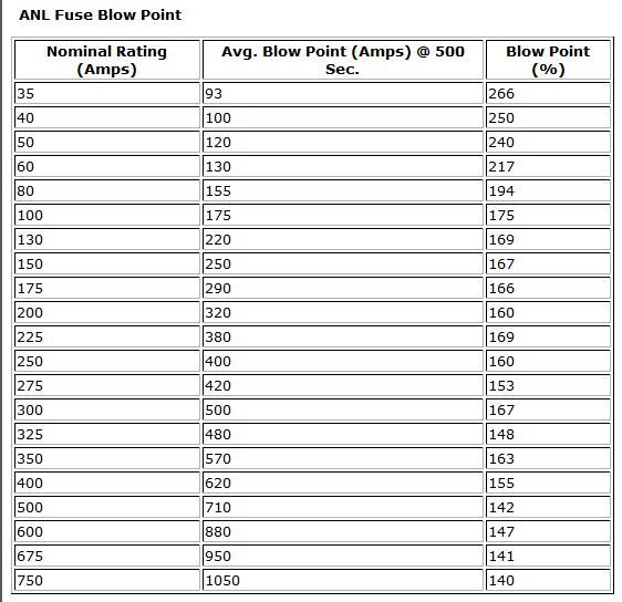

Jalepeno
You should use an ANL fuse. They blow at about 160% of their rating after 500 seconds, so no nuisance blows on starting circuits. I wouldn't size a fuse larger than the wire's ampacity.
Here is the ANL chart from Blue Seas:
