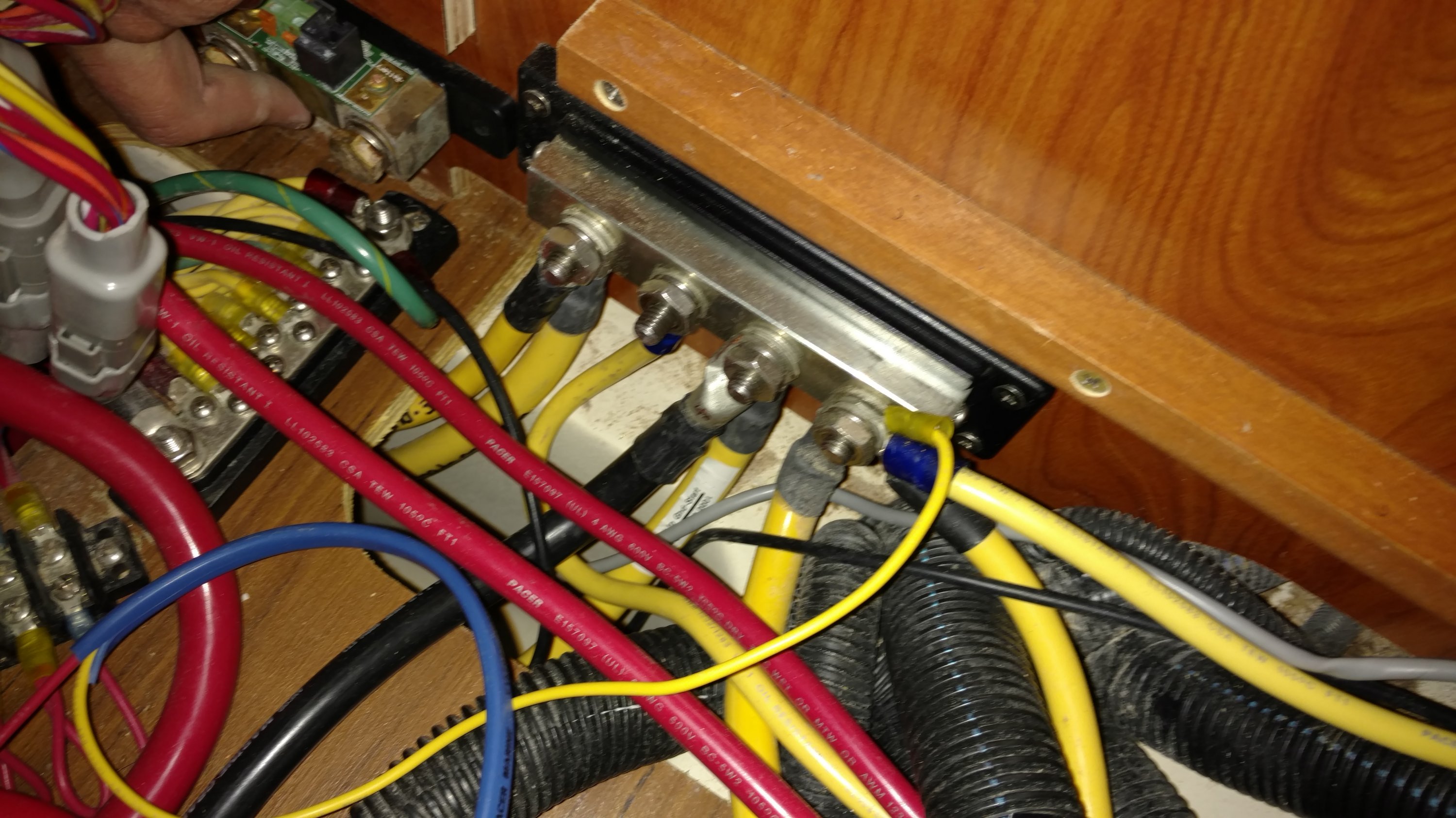

I'm considering installing my battery monitor shunt immediately adjacent to the main DC negative busbar block. In doing so, my plan would be to use a flat metal type busbar link from the output side of the BMV shunt terminals to one of the terminals on the main DC negative busbar block instead of another battery cable. My plan will require a flat busbar link approximately 3 in long. The shunt is rated for 500 amps. Any thoughts on using this approach? Any recommendations for the size/type/mfg of link to use? A picture below shows the main DC block and proximity of the BMV shunt.

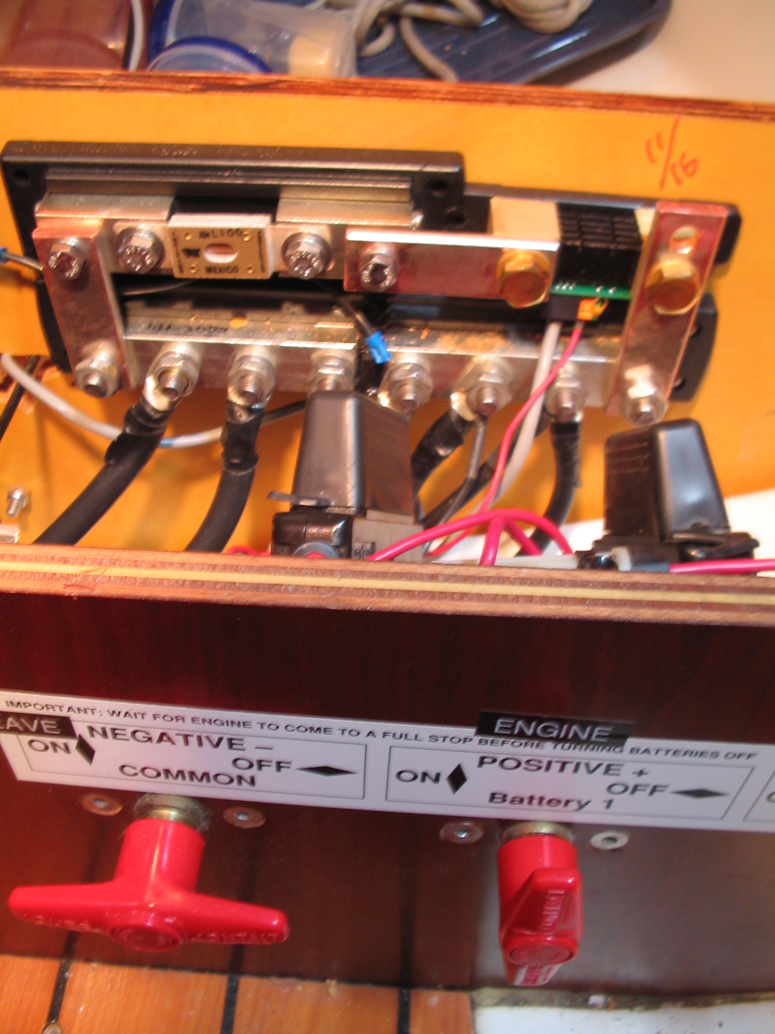

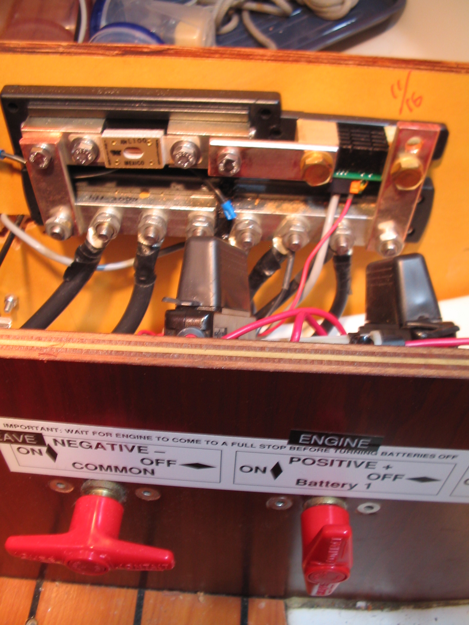

On my B323, I was lucky to have saved an 8-lug buss/terminal block from some years ago. To install the Victron 600, I cut the block to 4 & 4 busses. Filled in the cut in between.

Can you explain circuit wise what we are looking at in the picture? What happens at the split between the two busbars?
While you can certainly create a copper jumper, I get OFC copper bar stock from McMaster, the best practice for shunt placement is as close to the house banks nagative terminal as possible. This allows for the easiest way to ensure that no "sneaker wires" bypass the shunt. When you remotely locate a shunt the odds of sneaker wire bypassing the shunt increase. Shunts, for some odd reason, are one of the number one incorrectly wired electrical components I come across on boat..

Ron, Can you explain circuit wise what we are looking at in the picture? What happens at the split between the two busbars?
Certainly... On the lower left buss bar are the three negs to the batteries. On the lower right bb is anything that makes or uses juice. On the upper right is the Victron shunt, upper left the main neg fuse.
Copper straps connect the "load" buss to the shunt, then shunt to fuse, then the fuse to the battery buss. Nothing - hopefully- happens at the split. "Some day" I'll clean out whatever I used to fill the gap and make it as tall as the lugs. Now that it has been working properly, I'll heat-shrink the lugs/cables.
The "neg" label on the red switch is now a positive switch for the third battery. It just occurred to me if the shunt goes bad or the fuse blows and no spare, and can jumper across the gap in the (originally) 8-lug strip to get home.

It makes sense now. The black shrink wrapped thing in front of the split looked like a bus joining the two at the split, hence my question..
