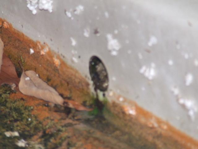

Hi   Purchased this boat last year.  Took it out three times.  The third time I got swamped.  Cockpit filled about 8 inches deep.  Running the rail in good wind (great sailing day) until one big one came along and unlike my previous boat, a 25' Sovereign it wasn't as forgiving of such sailing.      The main question I have is - what is the purpose of a half dollar sized hole in one of the ribs of the floor that is located between the board housing and mast mount?  Lots of ugly stuff came out of that hole and I believe quite a bit of the water that I took on went in there.  The boat seems to weigh quite a bit more which leads me to believe it filled with water.  If so, how do I drain it out?  Should that hole have had a plug?  Secondly, the existing drain hole I think is inadequate being located to the rear of the board housing and only a 3/8 - 1/2" size.  I seen most drains at the rear.  Existing drain does not clear well.  Thirdly, any mods out there so I can retrofit the mast to a tabernacle type mount?  It's getting pretty tough for me to handle that heavy mast.  I trailer so its an on, off, on, off situation.      Certainly would appreciate the help. Specs.  Day Sailer, 17', sail # 3508.  Does that give anyone an idea as to what type of DaySailer?  Also, what size outboard can the boat handle?  Seems as if the weight of a motor is more of a concern than the power from what I've read. ThanksOki.al
