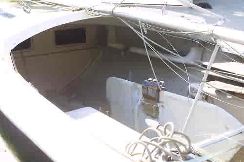

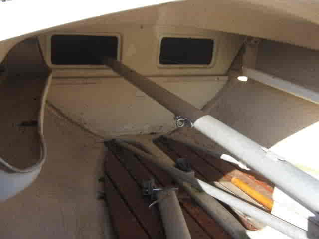

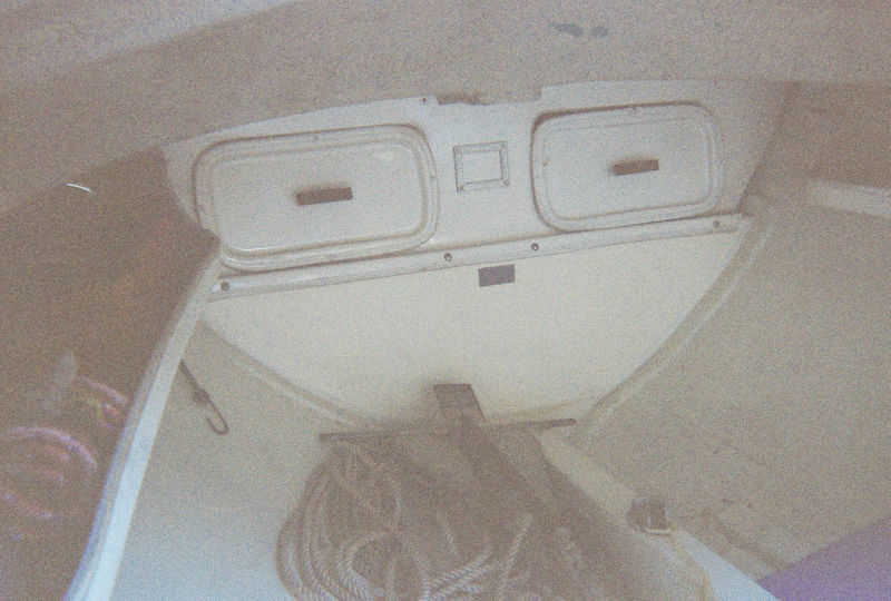

Hi fellow Oday Daysailers,
I'm looking for a few things for my 1968 DS1
Cabin: fiberglas shelves that hang from the brackets,
Cabin: door for bow storage compartment
Floor: Wood type? / pattern to built by my self?
What was the original mast of the DS1.
Any thoughts of feedback greatly appreciated:
