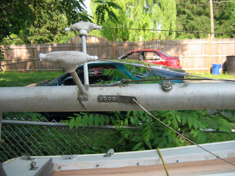

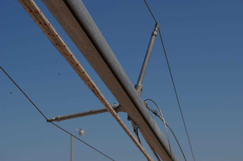

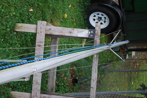

For those not familar with jumper spreaders, I have added a few pics. They basically control mast bend by stiffening the part of the mast above the point where the shrouds and forestay attach. We had them on our old CAL 21, which basically has the same mast as the CAL 20.
