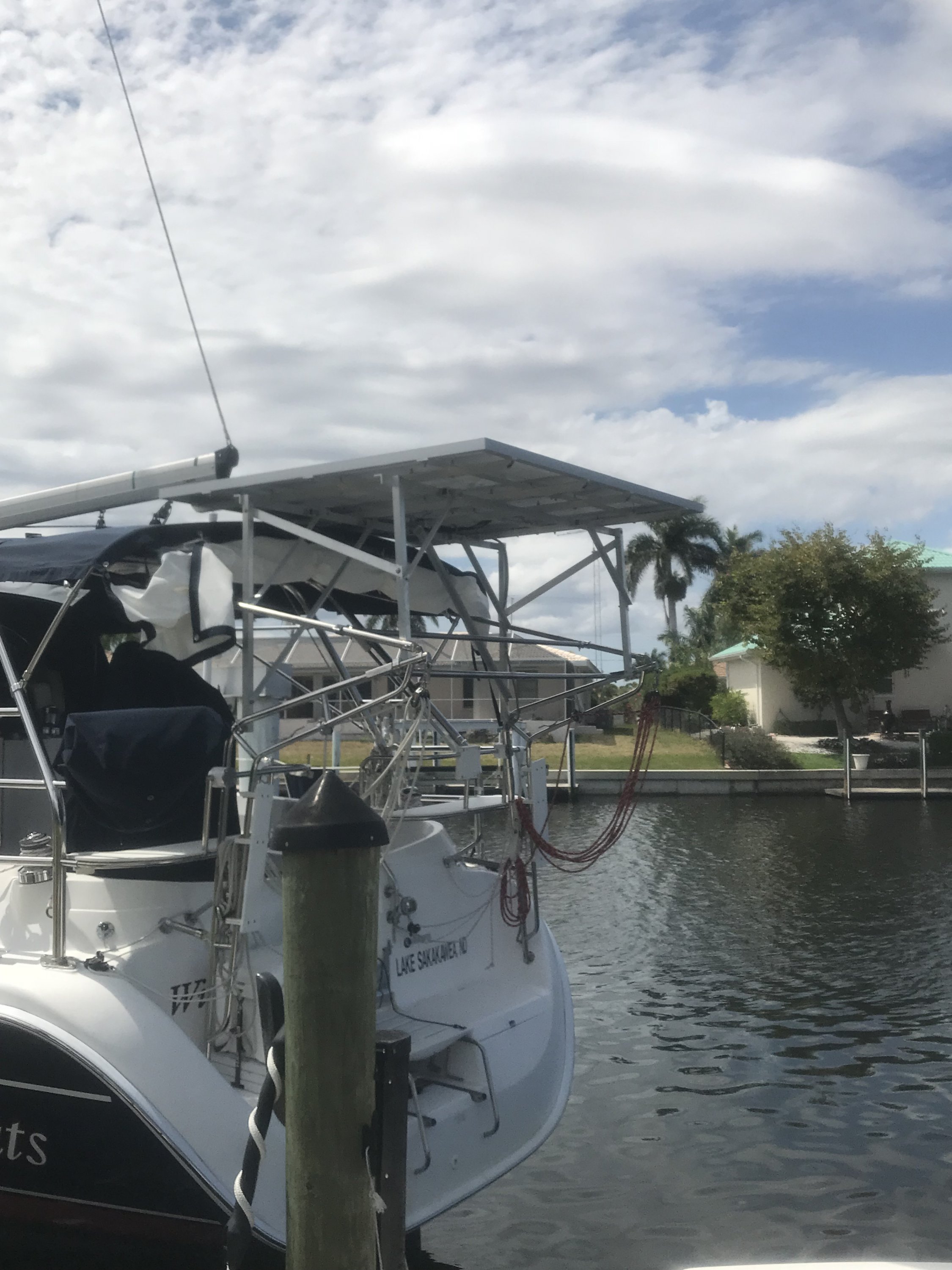

Kato, I use these davits on our boat and we have a 10' dinghy with a 9.9 HP motor on them (total weight 220#). Has worked well for a number of years. However, make certain that you get the single piece version of this davit and not the davit with an extension. I have recently modified the Martek davits to allow for the installation of 2 285w solar panels above them (see photo). So far very happy with the install and very solid.
