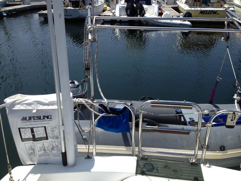

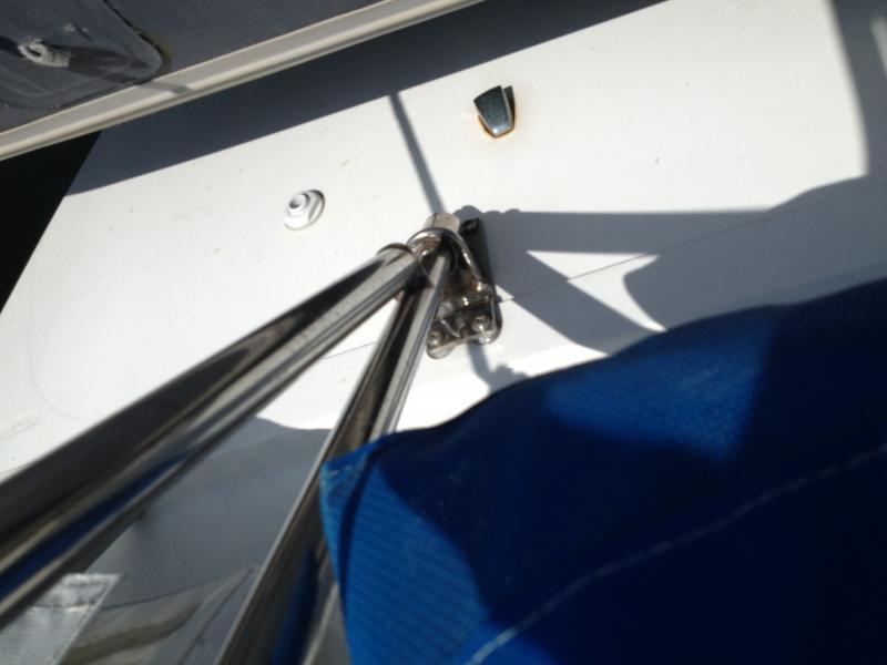

My 1982 H31 came with davits on when I bought it a few years ago. They are wonderful, and I can supply pics or details if you need them. I have a nine foot old Avon, which hangs very well on them.
IanJ
Nov 7, 2008
152
Hunter 31 Port Royal, CA
Here are some pics or the davits. I am an amputee, so thebars on top are simply for me to hang onto whilst entering dink. They do stop the whole setup swinging though, so I would recommend using. I realise these are not very good pics, but I am taking the dink off next week, then will get some better ones for you. If anyone needs different shots, just let me know what you want

Dang, that looks good! I want one now.

Doesnt seem to affect it at all. I also have my batteries where Steve's are, and my fresh water tank aft of them on port side, with diesel on starboard. Will be taking dink off this weekend, so will get another (better!) pic for you
