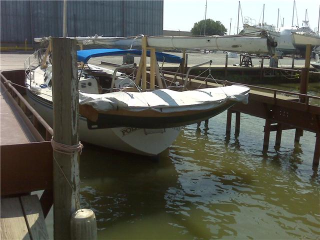

EdS to EdA, over! Not necessarily. You remember Mike Alge? He built that nice wooden dinghy, maybe I have some pictures. He came down to NC from Lake Erie and back home with it hanging on davits. He has a '79 identical to mine. It did really stick out both sides. And I think he had to tow through the Erie Canal. I'll write to him and get his thoughts. I have not seen him around here for a long time.
Found it.

Hi again, well guys, spoke to a couple of my Australian Shipwright mates and gave them the transom width and the davit diagram and they just said go for it Jeff, just make sure you back the locator plates under the deck (not sure how yet) and will give me any pointers I need if I have any troubles during the install. So I have ordered the davits and so will fit them when I have the boat back out in about September and will post the job with pictures on the Hunter Owners Modifications, 37c. Thanks Ed for the photo of the 37c with davits, looks a really nice dinghy as well. Cheers, Jeff and Happy Sailing
