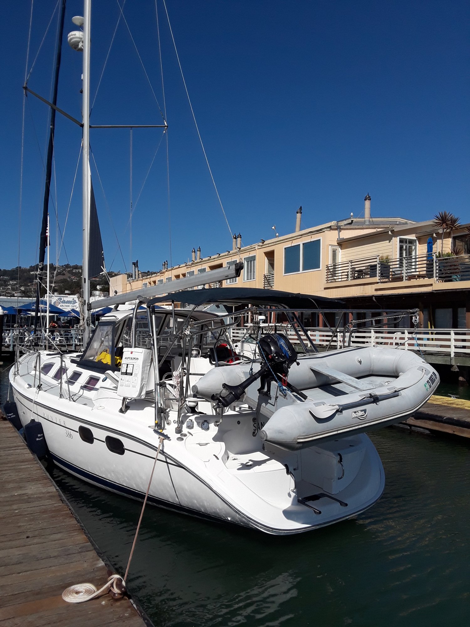

They all fit with differing supports and the manufacturers offer excellent customer support to ensure their davits are installed and supported correctly on your sailboat. Some may have photos of your 380 with their dinghy davits. Be sure to purchase one that can support your dinghy/motor weight (190 lbs) and obtain sufficient block and tackle purchase to lift your dinghy/motor weight (190 lbs). Product differentiators are price and features including carrying capacity in lbs, tubing 304 vs. 316 (better) stainless steel, 1 vs 1-1/4" (better) diameter and wall thickness (thicker is better), one or two cross bracing depending on carry capacity, rail attachments and/or struts, block and tackle purchase, swivels for storage when not in use, tie-off cleats, etc. Suggest making a table to compare price and features of each before you buy. You can do a search on this forum on "dinghy davits" to see what others have installed and why. I installed Garhaurer dinghy davits (1.25" diameter with one cross brace) myself on my 2004 Hunter 386 below.
