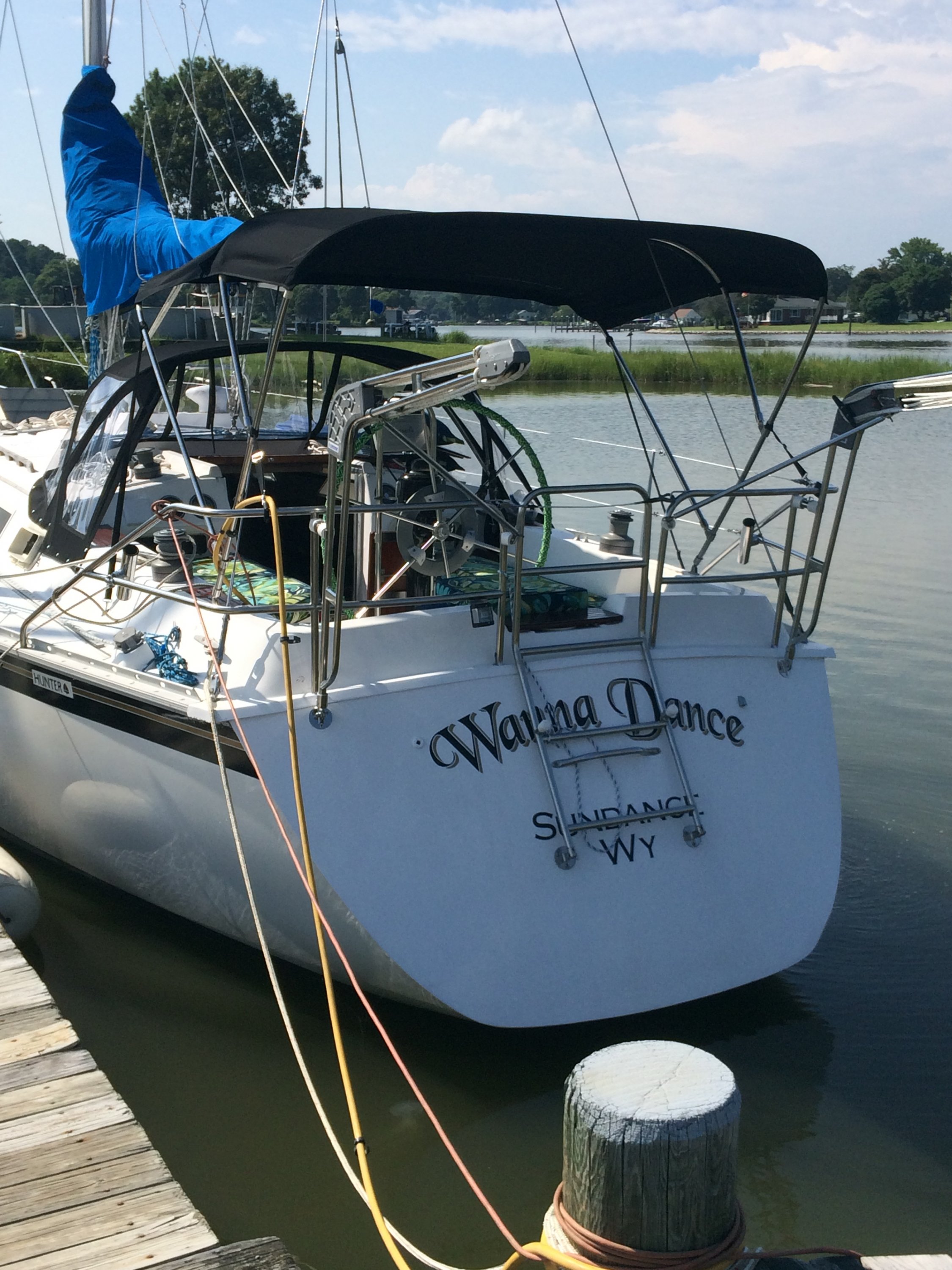

Thanks for the info and picture. On the 340 the issue is with the "swim platform" and the two storage compartments. Since asking the question; I have been trolling marinas and have found three larger Hunters with davits and with similar sterns to my boat. So, I guess it can be done. Two of them had extra supports added to take some of the load off the rear rails. I guess you just need to guide the dinghy away from the boat as you're lifting it.

I have ocean marine davits on my 336, essentially the same stern as the 340. The installation is pretty straightforward. You are correct, you do have to fend off the dinghy until it clears the swim platform, but it's pretty easy, even by yourself.
