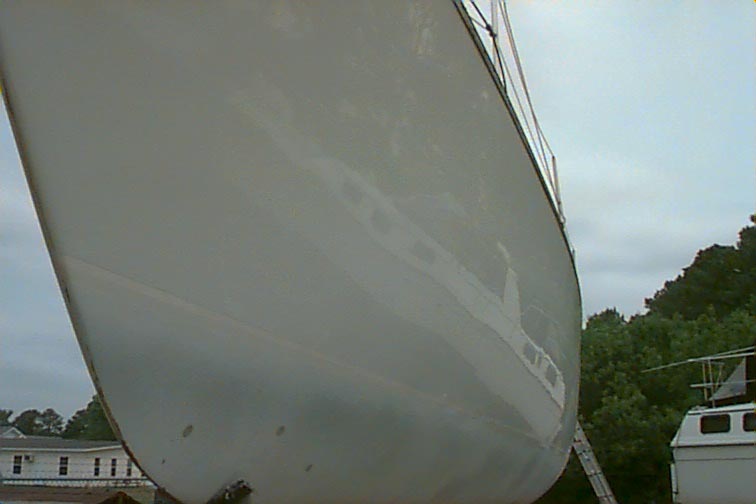

I would really like to paint my boats hull this winter. Right now its white but I would like to paint her either dark blue or dark green. I have had one person say that if I use the right paint it is tuff as nails and I can paint the boat any color I want. I’ve had two people say that a dark color on a white boat is not a good idea because it will show any little scratch and if you don’t keep it washed down it will always show white salt on the hull. They also say that the dark color will heat up and can damage the glass under the paint. How about it, anyone out there paint their white boat a dark color or know someone who did?
