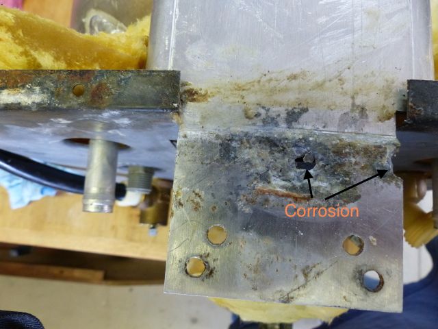

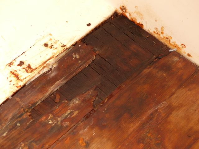

Pulled the water heater. While flooring was slightly damp near flanges, evidence of water leaks (see pics). Enough to cause corrosion through 1/8 inch aluminum screw flange. Don't know if from hose connections, but will pressure test the tank before reinstalling.
