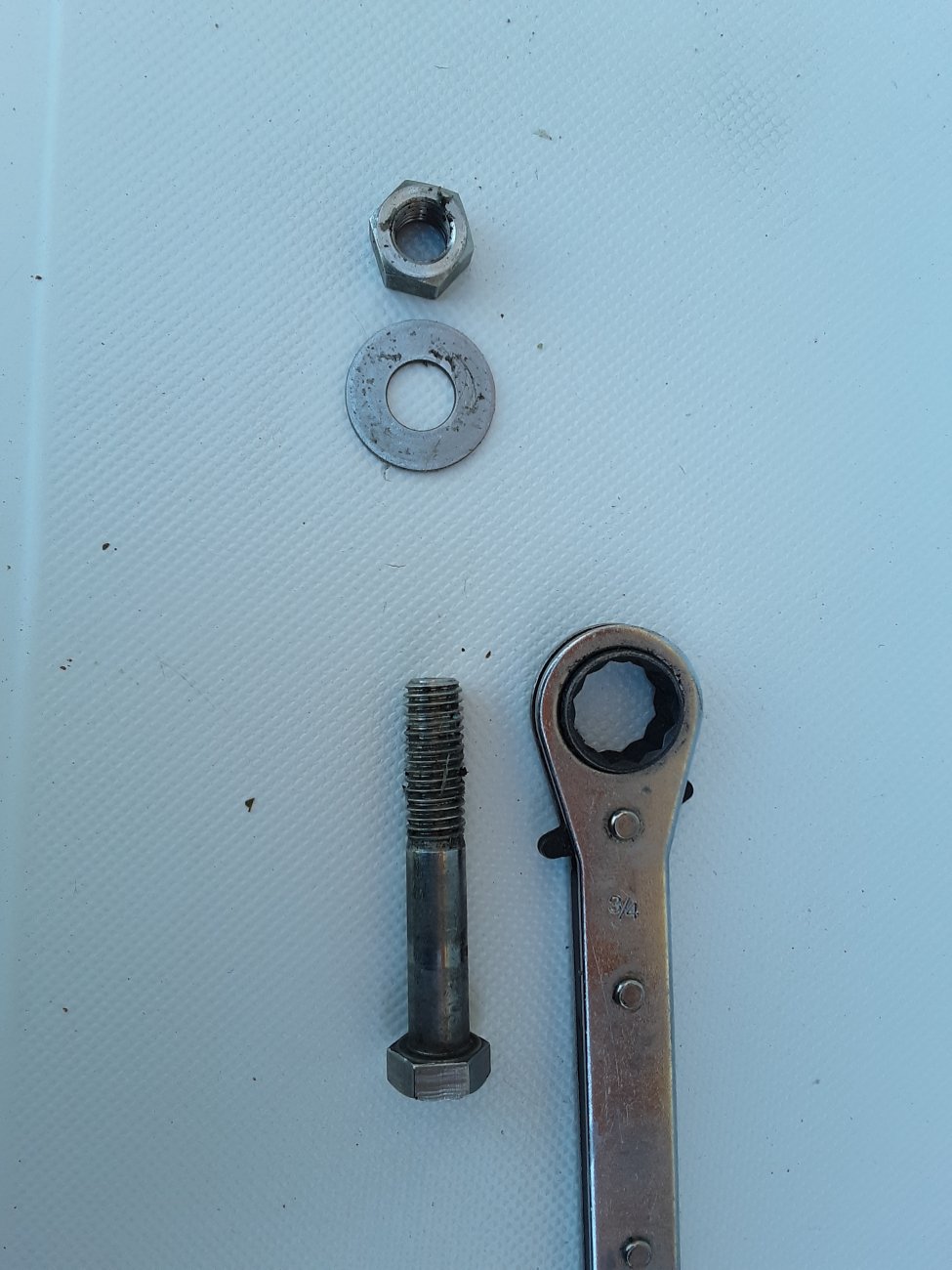

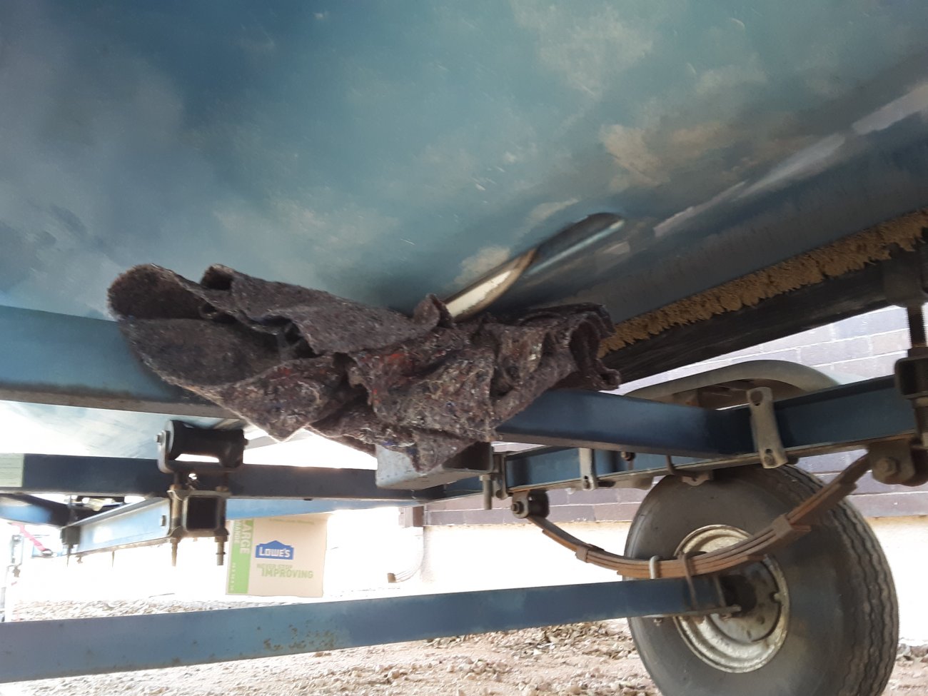

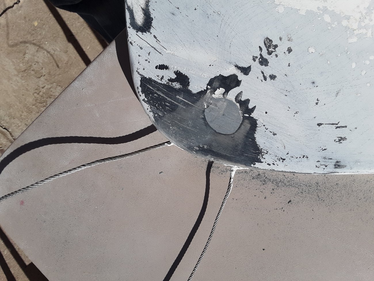

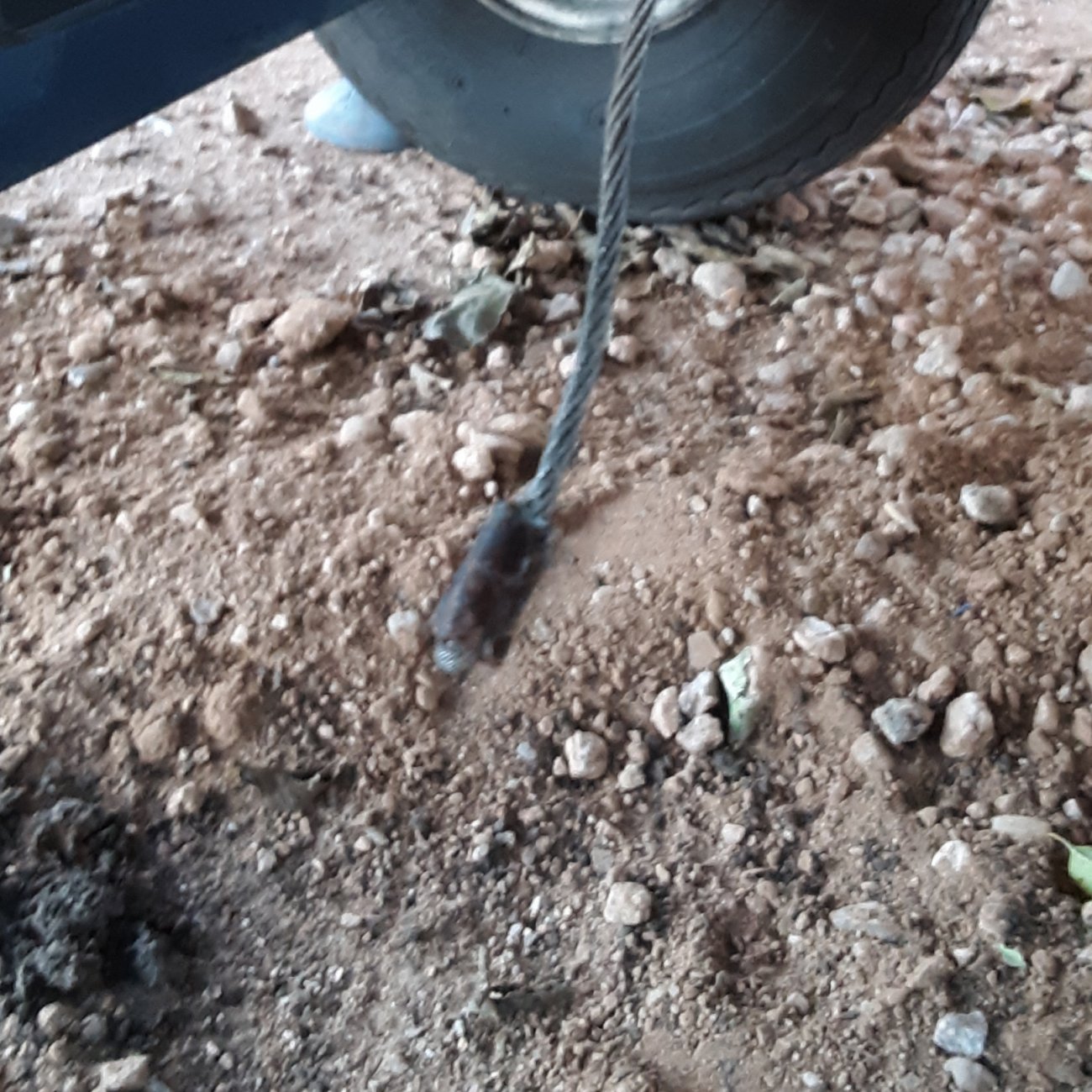

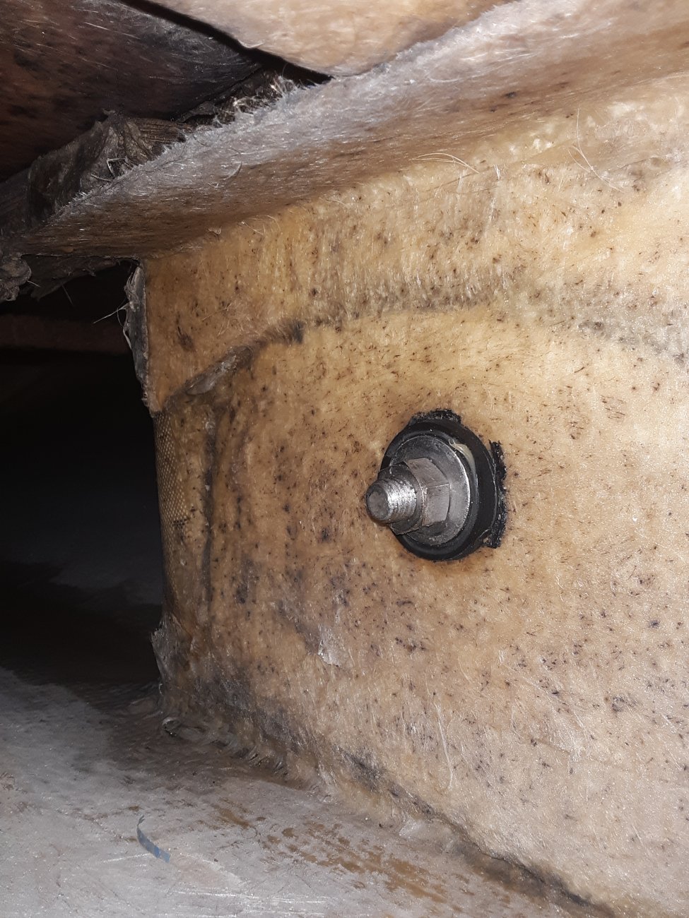

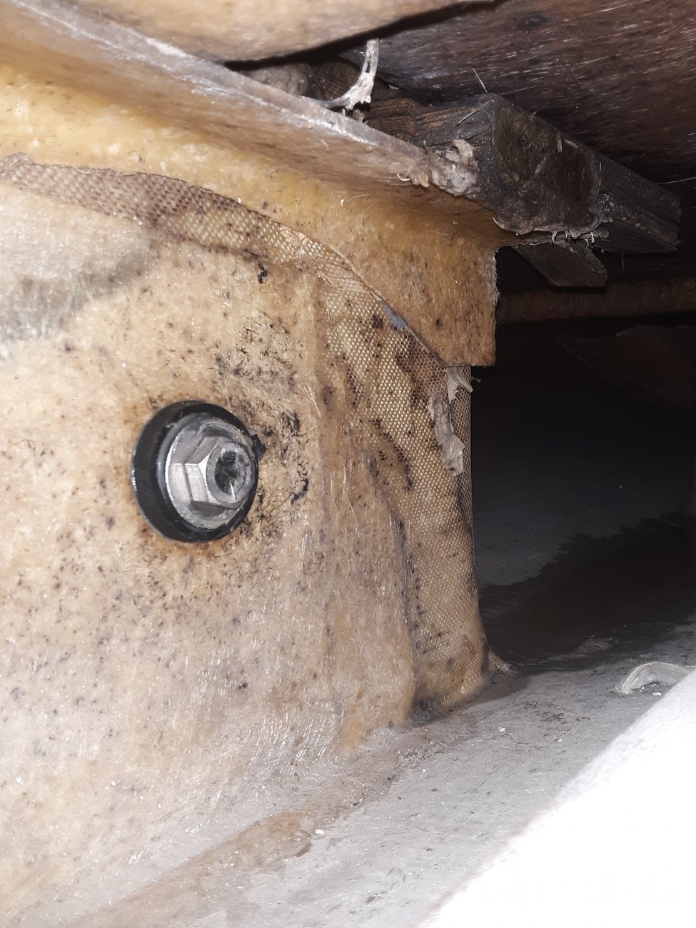

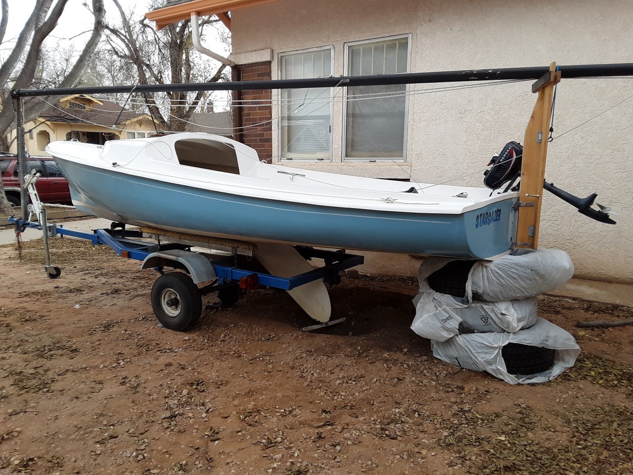

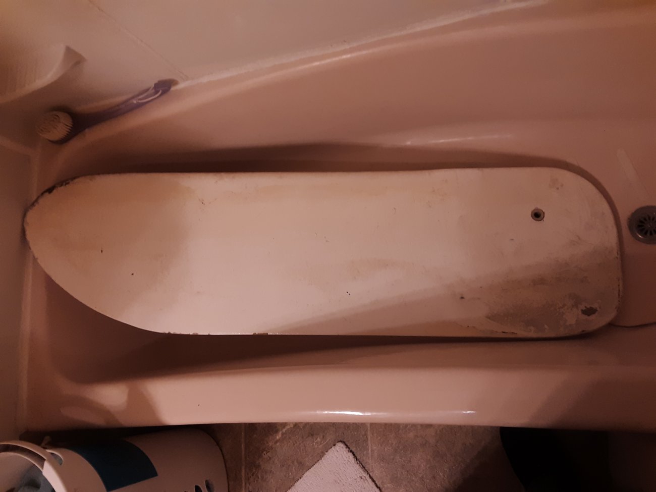

After digging a foot deep this bitter November day I finally got it out. Here are pics of the access ports, the centerboard pivot bolt, the dangly bit of the down haul mechanism that popped out, and finally the centerboard itself that looks to have never received any attention. It had water sloshing in it so I put it in the tub to drain. I noticed a crack where the wire had come out, so I hope it doesn't undermine my repair. For now I'm just going to resecure the boat on the trailer and deal with it in the spring, when I plan to have a go at mending all the scratches on the underside and restoring the gelcoat. From what I can tell by peering into the centerboard housing the blue gelcoat is original from 1982. I'd like to try flipping the boat for that but there IS a large tree by my driveway...20181106_132022.jpg 20181106_111232.jpg

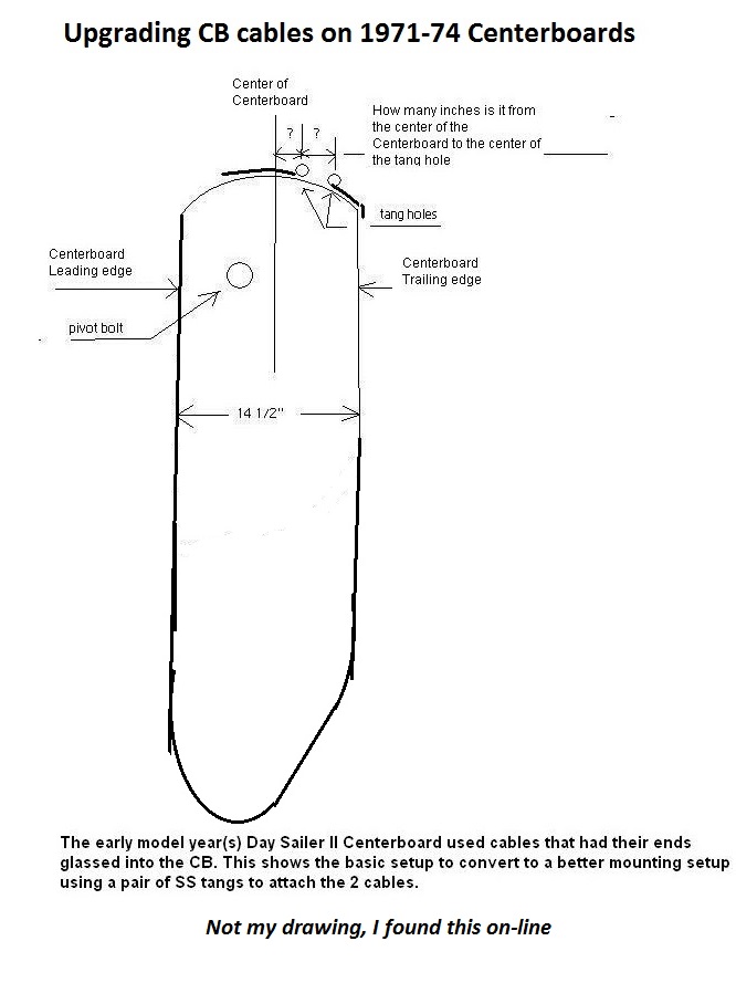

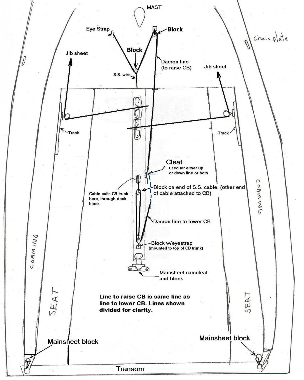

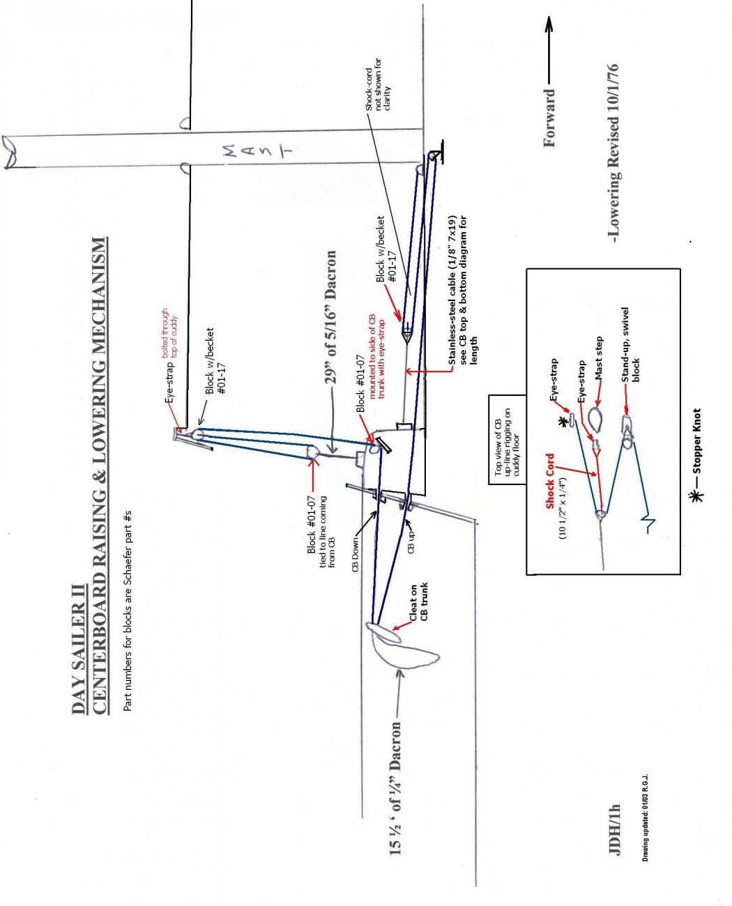

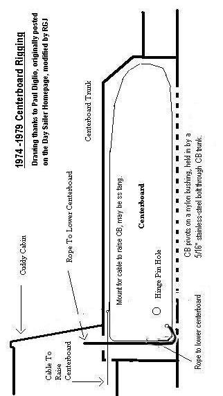

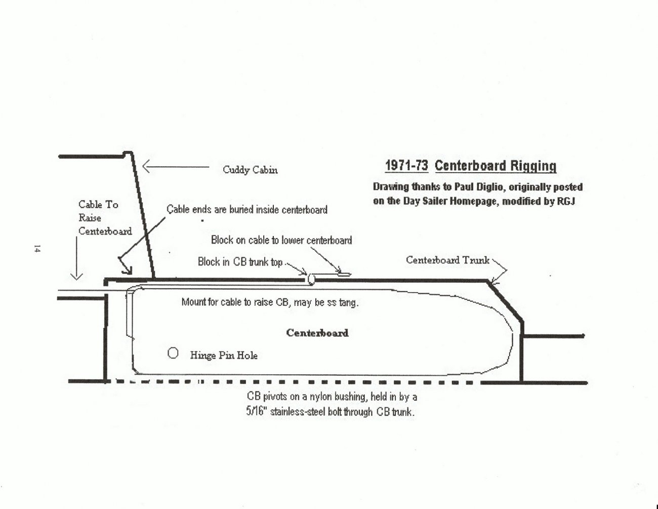

Might be a 1972, but not 1982, CB rigging is pre-1974 version. Drawings below are from my Expanded DS II Owners Manual. One thing, when you do put the CB back in, be sure not to lose the plastic bushing in the CB pivot hole, CB actually pivots on that, not on bolt, the bushing is slightly longer than the CB is thick so that clamping pressure of bolt against the sides of the CB trunk doesn't stop CB from pivoting.
There is a lot posted on the Day Sailer Association Web-Site Forum pertaining to the cables on the older model (1971-73) centerboards. You do need to sign up for a user name/password but do not need to be a member of the DSA to read or post questions.

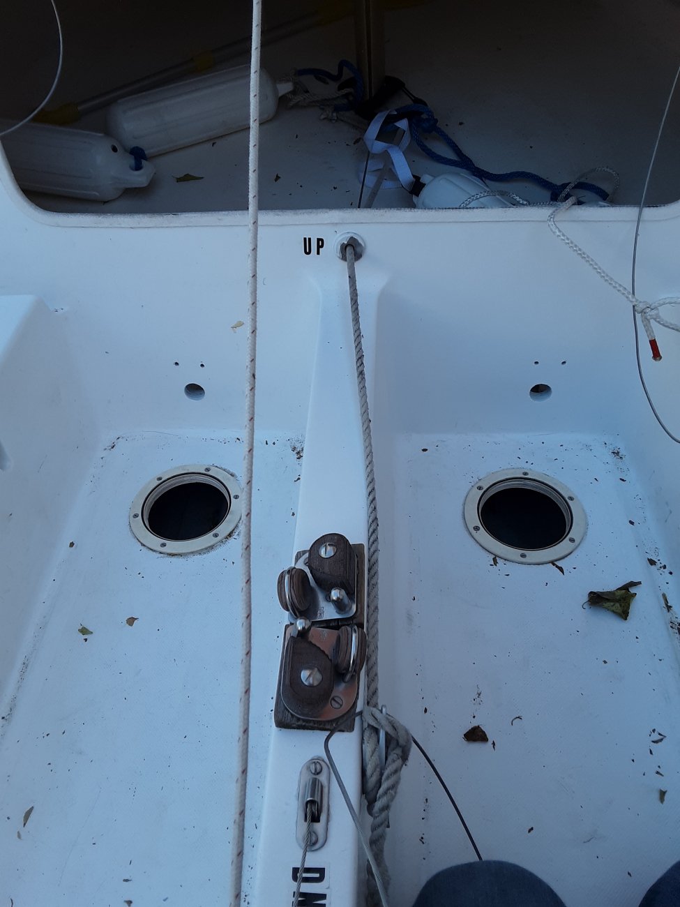

Great drawings! Very accurate. Thanks for the tips, I will def check out the DSA forum. I have never liked the way the cb control lines are rigged and cleated. I want to modify it so that you pull straight back on either line, each with it's own cam cleat atop the cb trunk. I don't think there's a real need for blocks on the down line. If I do that I'll post pics.
Good point. Also, I would think the bushing should be long enough that it wedges in with just a little pressure so the bolt doesn't pinch the trunk down against the CB.

Will Gilmore, it is long enough to prevent pinching the CB, mine could only be about 1/8" longer than it is (if even that?) and not be a tight fit. As long as the bushing is about 1/8" +/- longer than the CB is thick, it will prevent the pinching, it is pretty non-compressible plastic.

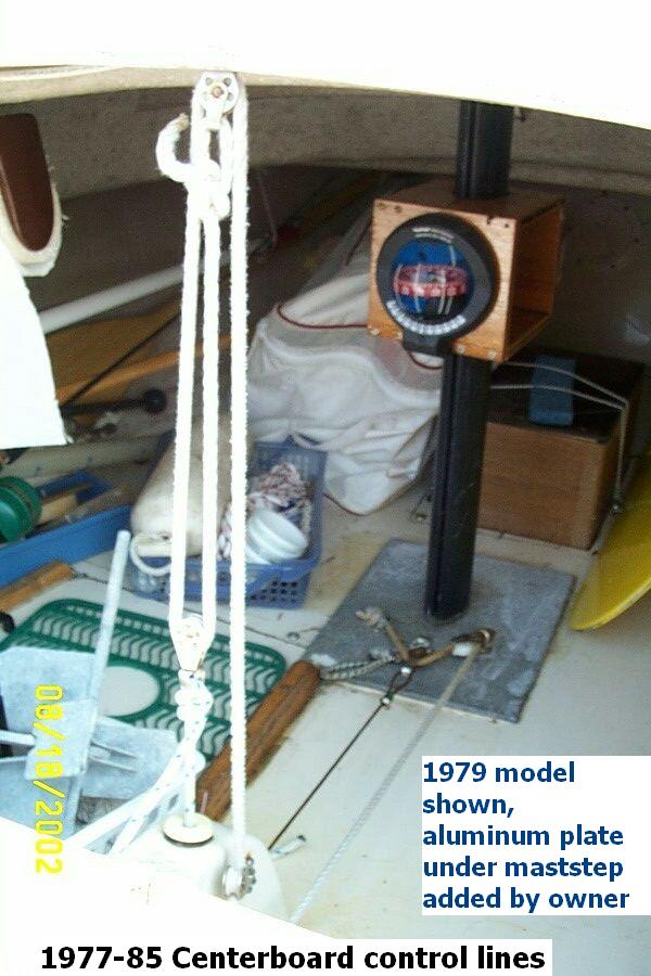

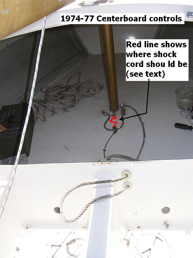

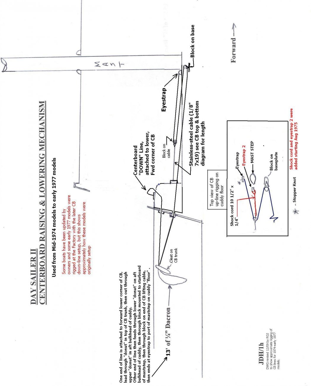

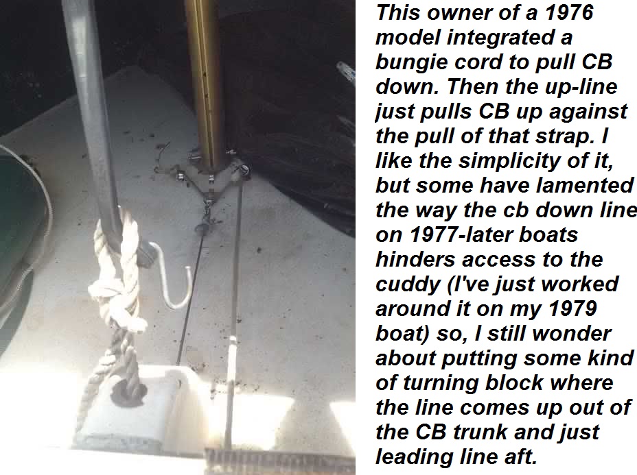

Will D, thought you might like to see how later DS II (1974-76 and 1977-later) models were setup, that cable to pull the CB down was more or less eliminated, replaced by a 5/16" line that lead around lower, forward corner of CB and straight up through CB trunk, 1974-76 line then just lead aft to cleat on CB trunk, 1977-later added a set of blocks to lead that down line up and the tackle to pull board down ran up to top of cuddy opening, then down and aft to cleat on CB trunk. My recommendation would be to switch to the 1974-76 setup but replace the plastic grommet where the up line exits the trunk with a block to reduce friction (use a larger version of the block that leads the up cable through the top of your CB trunk.

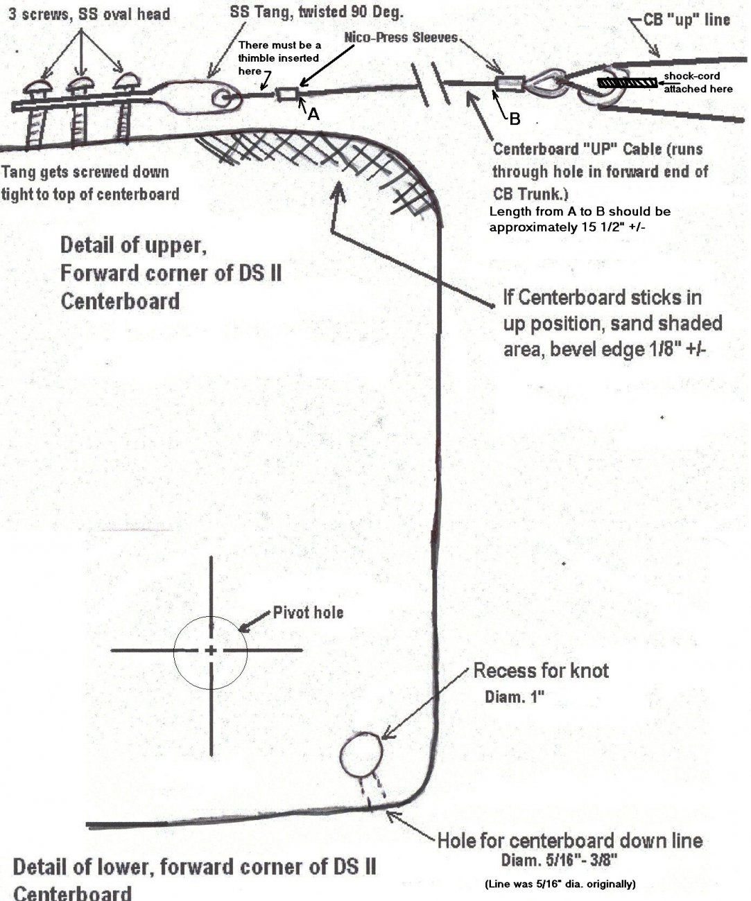

Here are the rest of the drawings, The picture of a modified 1976 model is not my boat, I found this on-line. I would put a quick-release cleat on the down-line if possible, that would release easily if you run aground. Duckworks Boats has those and many have used them on the line that holds down their kick-up rudder.

Sanding the top corner of the CB helped to reduce the amount of sticking in the up position on my boat, hence the drawing <GRIN!>
Still sticks once in a while, but far less often!
it's weird but my cb doesn't seem to match either the older or later model diagram. The down line, which I reinserted using resin and then glue for good measure, goes into the cb about 2 inches up and aft of the up line, not forward and down. And there seems to have been a hole as for the 5/16 line knot. But it has been filled in as you can see. Maybe the original CB was replaced with one from a later model and was retrofitted.
