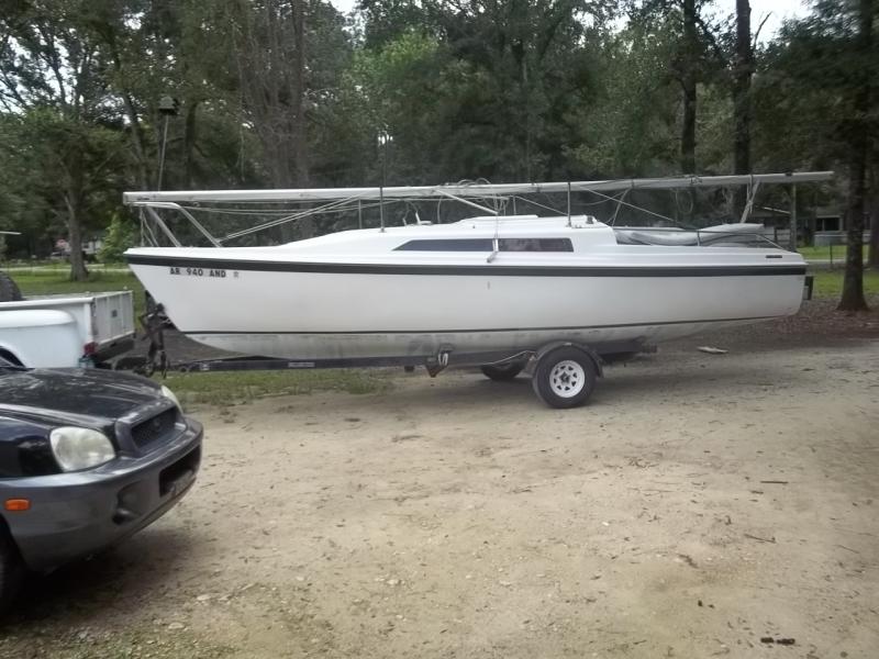

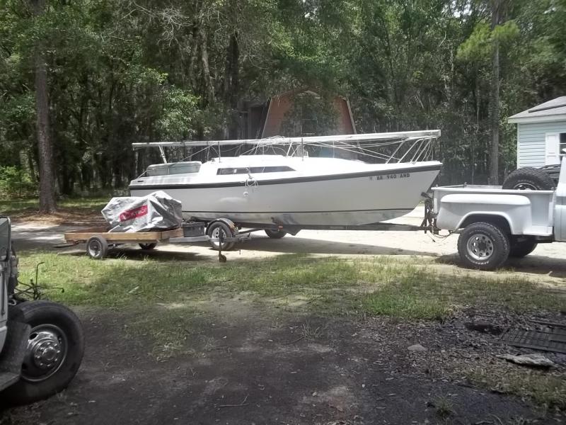

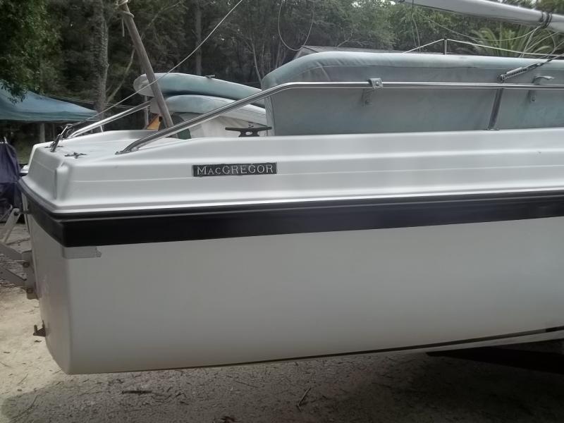

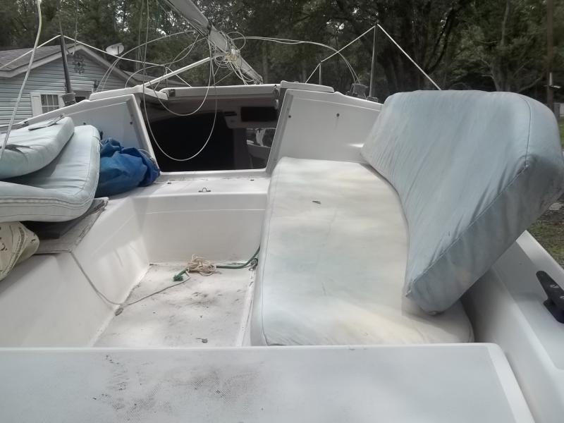

I am new to sailing and recently purchased Macgregor 26d. Its a 1988 in good shape, gel coat is still shinny. There is a hole about the size of a silver dollar that looks like it was repaired well. I need to add some gel coat to it but that's not the issue at hand. My dagger board was sheared off, looks like it rotted? I am debating making my own dagger board, My concern is I know nothing about the structure of these boats and would hate for it to break off when I am halfway to the Bahamas! Can some direct me where to look for dimensions and materials for making one or does some one have a used one for sale that's not rotted. I am on a tight budget and kinda weary of a $500 dagger board?
