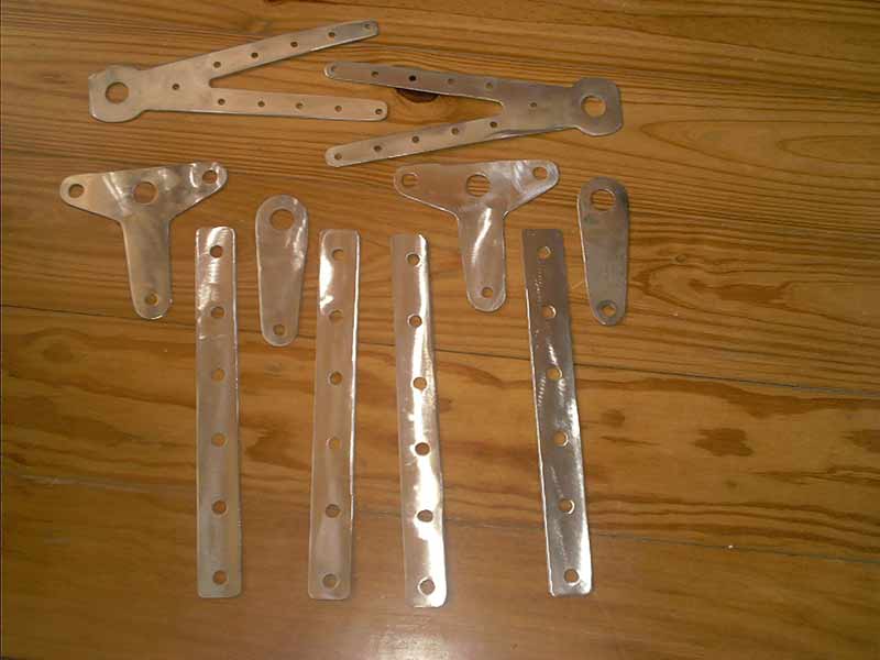

Already done with 12 inch miter saw. Cleaning the edges with my flat file and chainsaw files. Now to mount the base units next weekend. The panel should arrive by then.
