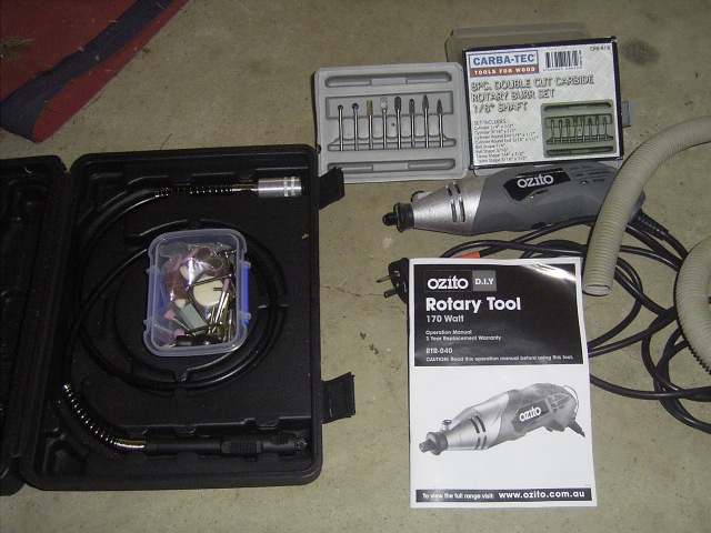

Thanks for that feedback Barb. My Dremel look-a-like came with 3 disks varying from 20-25mm in diameter (one wire brush, one fibre brush and one solid brown/black emery type disk). What diameter are these 'silver' disks and are they exclusively a Dremel part? Is there a tiny saw frame (circular saw type) attachement you can get for them to fit in?
I am only asking about the saw frame as it would be very good for cutting very straight lines. I imagine with the Dremel disks being so thin they would cut through fibreglass very quickly.

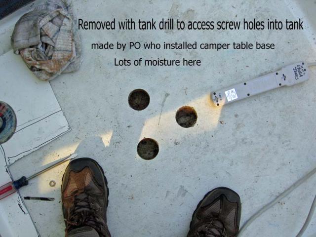

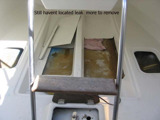

I spent nearly 4 weeks of sailing time to seal the leaks on the ballast tank. I had to cut out most of the aft birth area above the tank Then work out the structure of the top of the tank. I discovered two main layers of fibre glass. A top one of course cloth for strength and one under of fine cloth for sealing the water in. Water could be seen between the layers . There were several areas were it leaked out into the boat (green dots on photo) after cutting some of this top layer with the angle grinder and masonry blade being careful no to touch the lower sealing layer I found that the lower layer had separated from the hull about 2 feet each side from the rear of the tank. Red lines in the photo. I repaired this with several layers of fine cloth covering the whole area over the top of the course cloth. Tested with a full rank with food colouring (coloring) and Talc powder.
DON"T USE BUILDERS CHALK IT GETS OVER EVERYTHING AND TOUGH TO CLEAN UP AS SOON AS WATER GETS UNDER IT HALF OF IT FLOATS AWAY.UGH.
The two green dots fore and aft of the dagger board trunk where it attaches to the lower hull were leaking into the trunk from the tank and to the outside. Misleading leak. As the water leaked into the boat the trunk leak topped up the tank giving the illusion that the water was coming from some where other than the tank. I cut a hole in the tank under the sink area to expose the base of the trunk. Fibre glassed all around it and same on the out side. ( raised the boat on a rear blocks with the trailer jack to gain access outside)
Cosmetics ---manyana (splg?)----a sheet of ply over the aft birth Patched up the 18 inch square hole under the sink Mast up back on the water to catch up. I have had some good sailing with several days out at a time. Also some leak testing weather that flexed everything. Not one leak from above or below.
My fibre glassing is not pretty as its not my trade. So will get local help or advise when putting the aft trim back in and maintaining the trays which are all cut up.
How did this happen? The dagger board had to be replace when I bought the boat a few years ago. It obviously had grounded out a few times causing the trunk damage. The tank separating from the hull. I think it must have been left in the water during freeze up, this is the only way an even separation of nearly 4 feet could have happened
Thanks every one for the inputs many of which I used. I almost gave it to my wife as a flower planter.
Mic
ps Yellow dots are where PO drilled a base for a camper table right into the ballast tank.
To the best of my knowledge the ez lock cutters ( silver) are an exclusively dremel product. I dont think it has been around long enough to have copy cats out there. As I understand it some of the look a like can use dremel attachments and accessories so it might work with your tool.
I have zero experience with non dremel items so I cannot help you with that part. What I bought was the regular starter kit available locally. Here is a link to that.
http://www.amazon.com/Dremel-EZ406-...LRVA/ref=sr_1_3?ie=UTF8&qid=1319398029&sr=8-3
It uses the regular collette is all I know to say in answer to your question. I know dremel has a LOT of accessories for all sorts of uses . .
IMHO I think it is worth its weight in gold for cutting any thing thin enough for the blade. As I was looking up that link I noticed Dremel has opened an entire line around the EZ lock aspect. it might be worth checking out .
The dremel i have is model 300. it kind of pricey but its because they include all kinds of accessories with it .
http://www.amazon.com/Dremel-300-N-...5GAM/ref=sr_1_2?ie=UTF8&qid=1319399003&sr=8-2
I noticed they do sell an attachment to be used like a circular saw but it is for the multi pro. I dont know if it would be compatible with any thing else. best guess is contact your tools site and see if they know. or maybe get one and if it dont fit return it. You might want to check the reviews.
http://www.amazon.com/Dremel-670-Mi...dp_top_cm_cr_acr_txt?ie=UTF8&showViewpoints=1
I did notice several months back ace hardware and a package of metal mini circular saw blades but I did not see them when i checked here last month s, Dont know if that will help you any.
An idea that occurs to me that would be fairly cheap to test . depending on what size your attachments are at the stem going into the tool, you might be able to just get some collettes and use the dremel line that way.
sorry im not more help on this part.
Hope you find something that is really nice to work with , if you do be sure to let us know .
Me? I'm going to check out that ez lock line further. I LIKE not having to mess with that danged wrench every time i need to change something.
