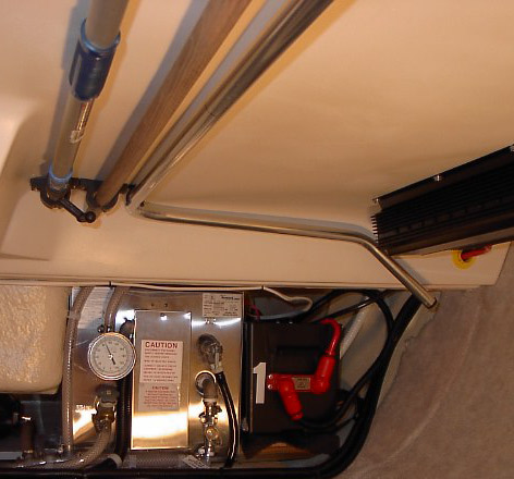

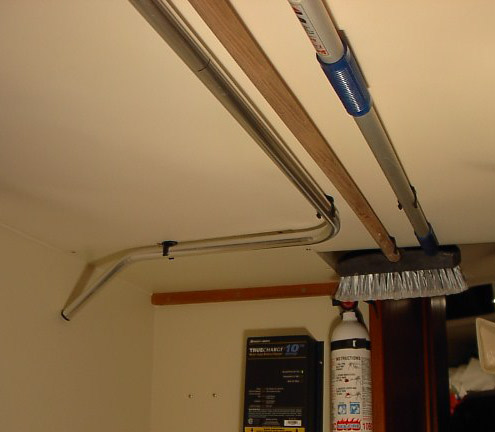

What I did was to keep it in one piece and mount it on 3 nylon clips (as used for storing for a boat hook) on the headliner above the aft berth, port side. The u-shaped aluminum pole has the legs pointing to port and it is slid back next to the aft bulkhead. Just hold it up against the ceiling and you can see how to position it to aft and to port. I mounted two of the clips to hold the main center section of the u-shaped aluminum pole, and one on the other leg forward. I can take a picture of it, but I have been unsuccessful in the past on posting them to this site. If I could get someone's email, I'll send it to you to clip it and post it. Also, I mounted my boat hook and deck brush pole on more clips along side the pop top pole on the headliner. Hint: don't drill too deep and use short stainless screws.

Thanks, I may take a look at hanging it from the headliner. I have been thinking about hanging the boat hook, but want it somewhere I can grab it easily if needed. Someone on another board suggested building one out of pvc which might work.

That aft view photo shows the water heater and the new inverter that I am installing. The water heater is for my aft deck hot and cold shower assembly. I often take three day weekends on the boat and anchor out at night so I installed it to to keep the crew (and Cap'n) happy (and clean). The pump was not shown in that picture but see attached photo that shows the pump on left and the accumulator tank to the right. It pulls water from the main 20 gallon water tank at the bow. It has valves that I can open to pump out the water heater for winterizing too. When the aft bulkhead is installed, I can operate all valves and see the water temp gage when I open the hatches. The new pic also shows the new 200 amp fuse that I installed on the port battery case to go with the heavier AWG battery cables for the inverter. The various "necessities" being added are great, but I just hope she still floats when I splash her this spring, or may have to reduce the size of the crew (number not weight).
