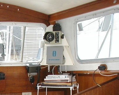

Rob, I had the same type of system. Only mine was monochrome.
The SiTech monochrome unit is in the top of the stack.

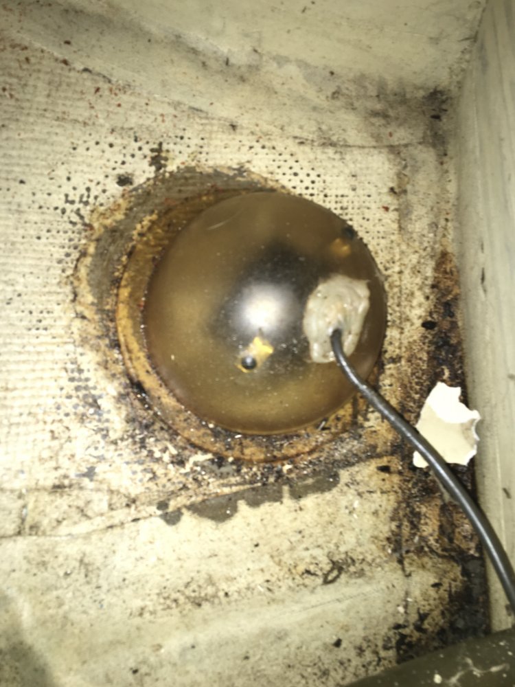

Below is the transducer in her oil bath shooting through the hull.
