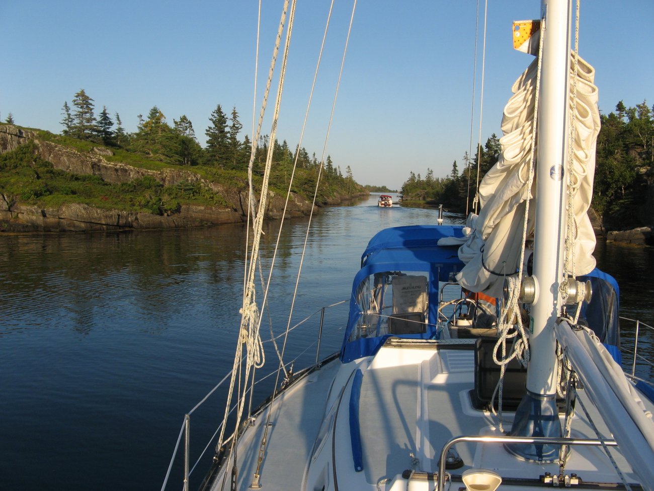

The only one I could find in a hurry - isn't the best but it shows the track for the staysail boom. Note that the1982 and later boats had a stainless steel bar over top of the dorade vents (to protect them form the boom)
