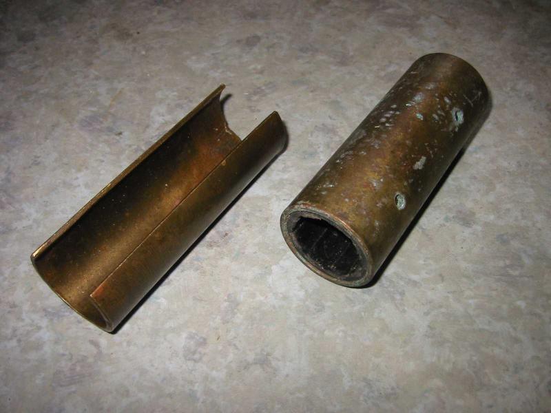

Thanks for the encouragement. It looks like my homemade tool isn't up to the task. I'm thinking that I'll remove the strut and cut the bearing out as per your tutorial. But first i will have to dig out all the filler someone used to fair the strut!
If it were me I would pay the small amount to have it pressed out with the real tool!!!!

There is a special tool you can buy to remove the cutlass bearing while the shaft is installed.

i've removed the strut and used Mainsails technique to remove the bearing. The new one pressed in without any problems. Now the hour and half drive back to the boat to reinstall the strut and prop.
