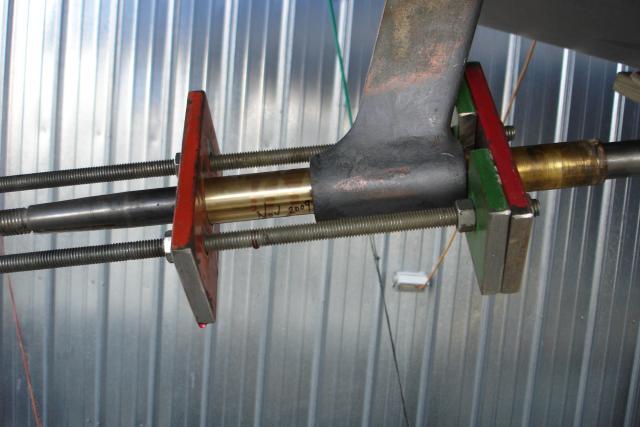

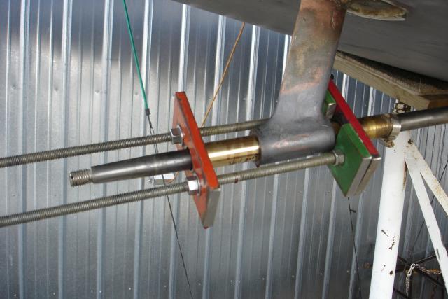

Hey Max
I just did mine this fall. Made the tool with the help of a neighbour. I can send you a couple of pictures of the tool. You can buy one or maybe rent one if your near a marina. My prop is a folding one so it's a little different to remove.
I pushed the older bearing out with the new one. I pushed it towards the engine. Once it was pushed out I used an angle grinder to cut the old one in half to remove it from the shaft. My strut appeared to be glassed in but it turns out that it was just filled in with bondo.
Cheers Don

Ok Max
Here's a couple of pic's. It's pretty basic but worked well. I used 1/2 redi-rod about 18" long which worked well since it comes in 36" length.
There are two set screws on the side of the strut. I removed them and tried to put some wd 40 in there. Mine was a tight push all the way.
If you need any more info. just let me know.
