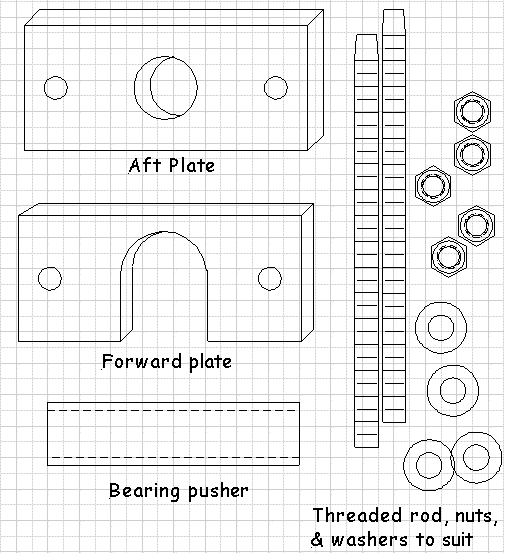

On my 33
Don There is a tool that can be made for pressing out the bearing. I made one but found my bearing too seized for the tool. (I wish I could remember who designed the tool to give credit) I found removing the strut to be quite easy. Just two long machine screws that were relatively excessable. Once the strut is off the boat, it is a simple matter to press out the bearing. If you're replace the shaft, I suggest getting a sawz-all and cutting the shaft right behind the flange, instead of trying to get the shaft to slide out of the flange. Hope this helps. If you want to see the drawings for the special tool, I will try to add them to this post. If unsuccessful I could e-mail them to you. Don
