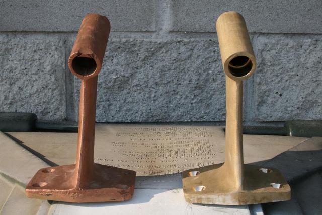

i have a 9.2A and have had a new strut made..... as mine was toast...and i think you have the same configureation as the 9.2A......if i am correct there is no need to remove the shaft or the strut...they make a puller especially for this......i think you may be able to see in some of Mainsails posting in the archives or in compass marine postings......i will post some pics of the new and old strut later on to day.....

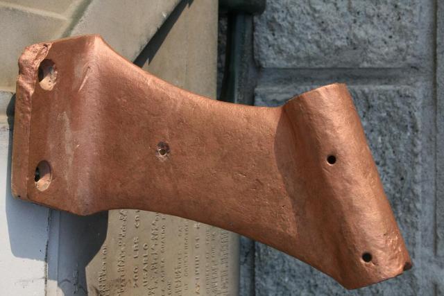

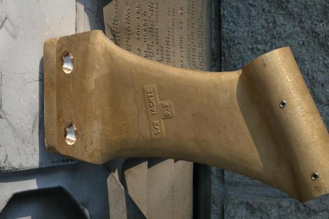

ok here go....i have been worrying with this for over 18 months now ...i have had several people look at it in person and all but one said to use it ....i wasnt satisfied with the use it answer and wasnt sure why so i finally got it made after much wrangleing and research ...it was made by the same company that made the original one bwtw....and as it turns out i have done the right thing by haveing a new one made.....after i got the new one home i proceded to take a 12 oz ballpeen hammer and give it a medium tap with the ball side of the hammer and the crushed part you see in the pic is the result of that tap.....now what would have happen if i had used it as is .....prolly lost my shaft and prop in the big gaping hole it would have made in the bottom of my boat and sunk the boat as well ......gut feelings are not to ever be ignored.....stray electricity was the culpret in this damage......

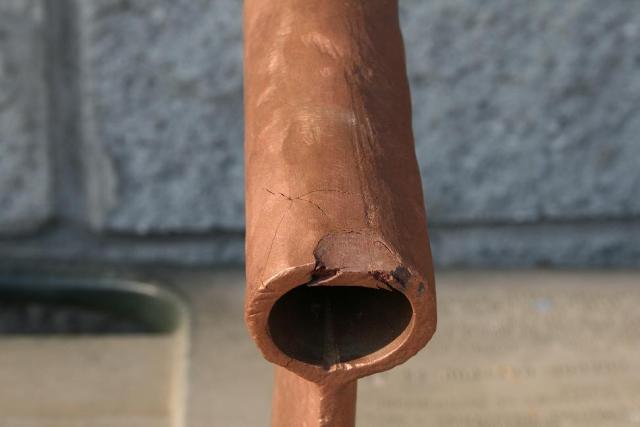

Woody...that strut was GONE...electrolysis or a bad piece from the red coloration. I would have replaced it too.

as far as realinement on the new one...there will be some minor tweeking i am sure ...but i had it made by the original mfg and the new one is exactly like the old one with out all the ware a tare...lol.....if any one needs that info just pm me and i will give it to you and a dealer where you can buy it through at a reasonable price....

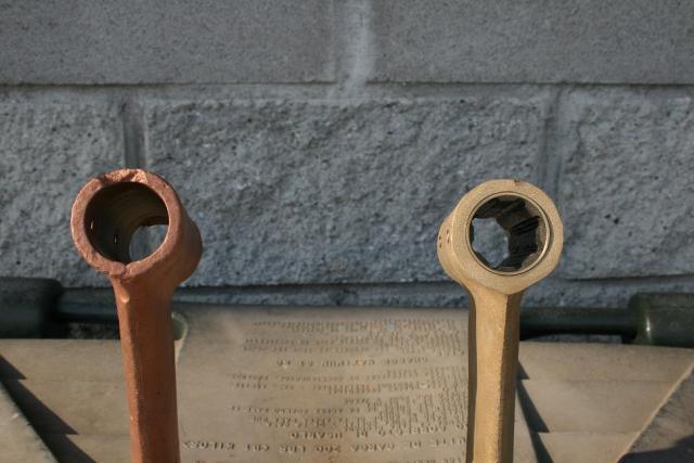

I also note from your pictures that the cutlass bearing is what I would consider a thin wall type held in place with two set screws on the strut. Are the set screws what hold the bearing in place or is the bearing itself an interfearance fit with the strut as well? If it is an interfearace fit and being thin walled I'm not sure how you could remove it from the strut without removing the strut or the shaft although you seem to say there is a way to do so - please elaberate.

I also note from your pictures that the cutlass bearing is what I would consider a thin wall type held in place with two set screws on the strut. Are the set screws what hold the bearing in place or is the bearing itself an interfearance fit with the strut as well? It is a both If it is an interfearace fit and being thin walled I'm not sure how you could remove it from the strut without removing the strut or the shaft although you seem to say there is a way to do so - please elaberate. check with Mainsail on this as he knows exactly how its done

when you pull the boat out of the water if the metal is not pink like mine it will prolly be ok ....take a hammer and tap the web of the strut and if it rings sorta like a bell it is sound....and you can also stratch the surface and if you get a gold color like my new one it will be ok ....as far as selling you mine i have already set it to the hull ...i am almost sure yours is ok mine was a product of many years of neglect......but stranger things have happened..
